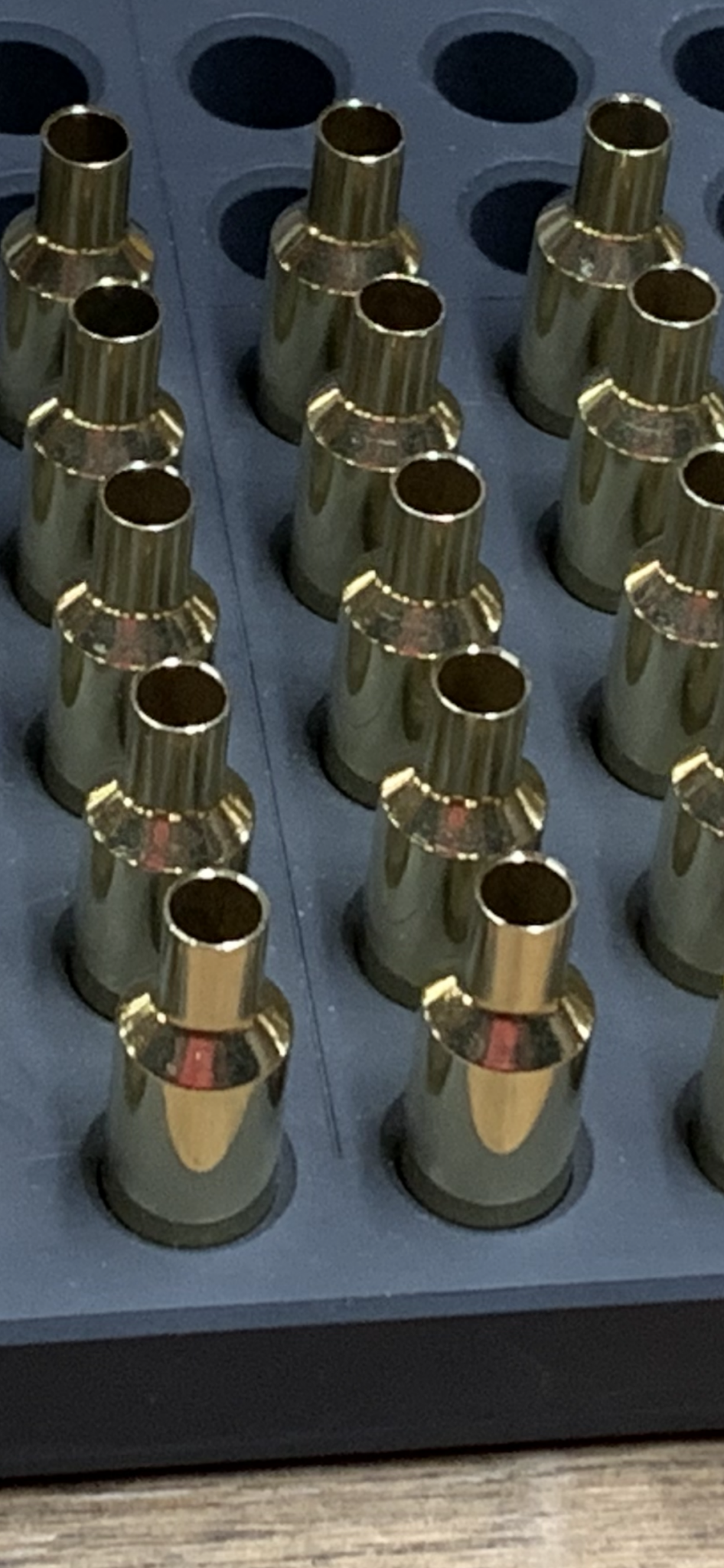

So I bought some fired bra brass. I have Peterson that only I have shot and it measures 1.550”. Bought some Lapua once fired. Somebody trimmed it like it owed them money. Some are 1.39”. Some shorter. Pics for reference. Is this going to be a problem? Before anybody says just shoot it until it grows, I’ve got three firings on my Peterson and it hasn’t grown any. Junk it or what?

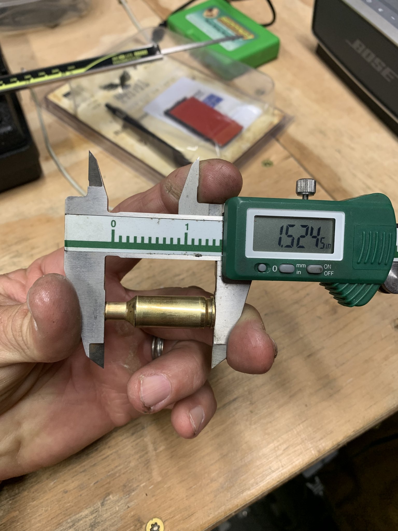

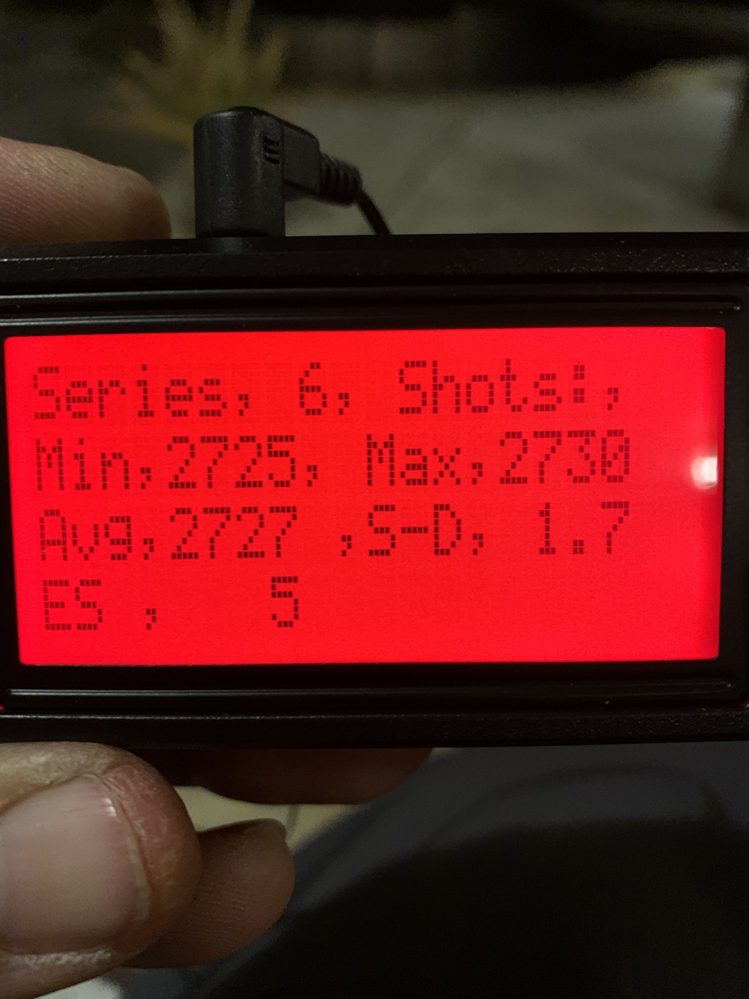

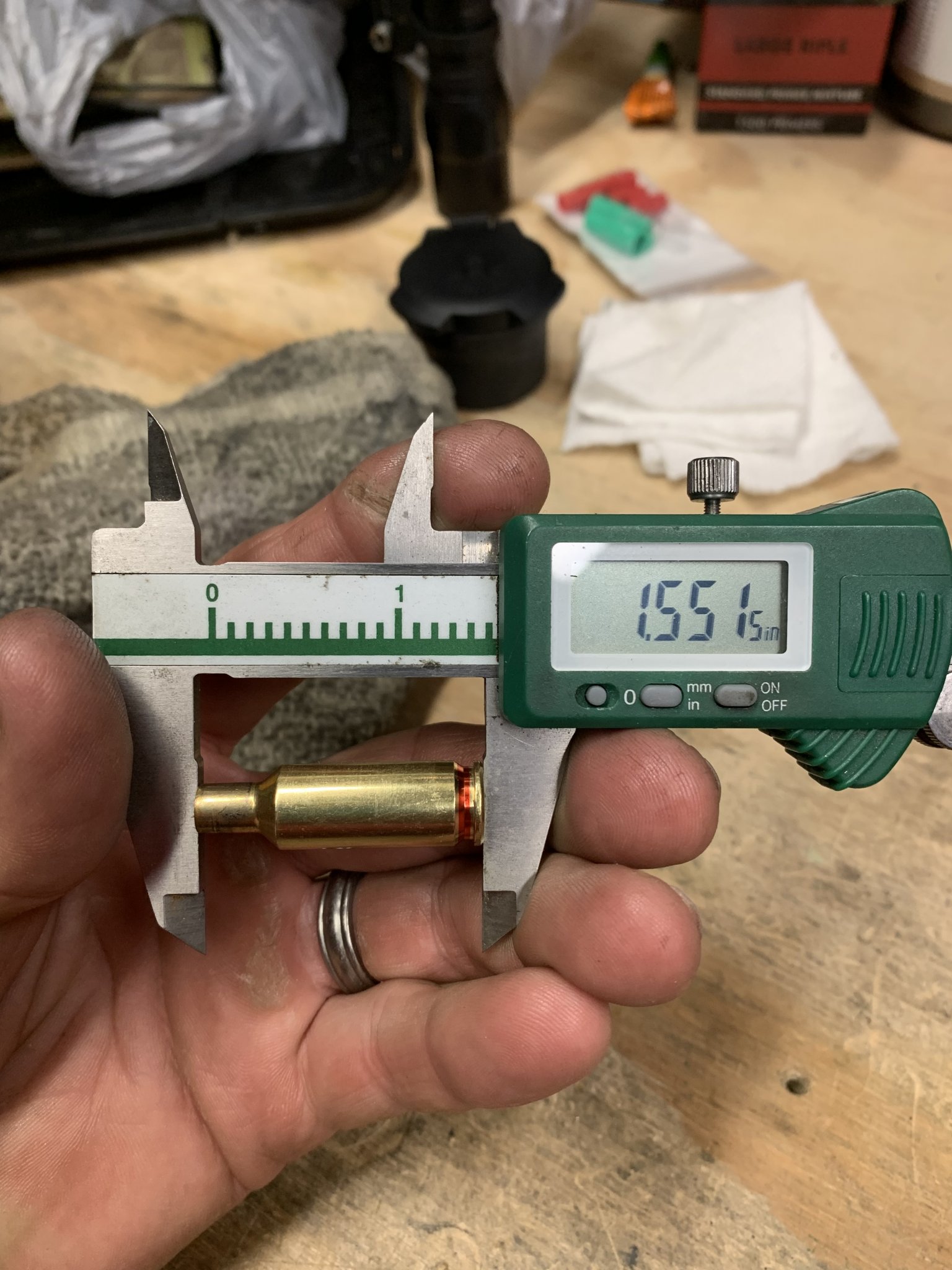

OK so here’s where I’m at. I have got 3 firings on Peterson brass. It grows lengthwise, none. I use a giraud trimmer. I have my case holder set, where it barely, and I mean micro, touches the case to put a mini bevel on it. I’m not a fan of the recommendations to cut it short and roll with it. Neck tensions going to be all over the place, case volume is going to be all over the place. This will make numbers be all over the place. Never mind and almost guaranteed carbon ring.

If you're talking about 1.524" through 1.550", now you're exaggerating a little.

I’ve got a ton of new Peterson, the one I showed @1.551, is one of mine. I bought this as a deal. Lesson learned.

I don’t go for hell on the chamfer. My brass is growing none, so I barely touch it. So little I highly doubt I’ll affect case life. A little clean up, I feel helps get my seating/tension where I want it.
Not exactly. When you trim, you square off the case mouth. This creates hard edges that necessitate a chamfer in and out. During/after the shot, no such hard edge is being created.
Still, do what you do if it works for you. I get seating forces falling within a 3-5lb range on my 6mm, and within a ~10lb range on my 30 cals. Being data-driven in my reloading process, with my next 300 loads I'll chamfer 10 cases, and measure the difference in seating forces and post here.
I’m also with you on data. Let us know what you find on that. I’m truly interested. See my post above.
