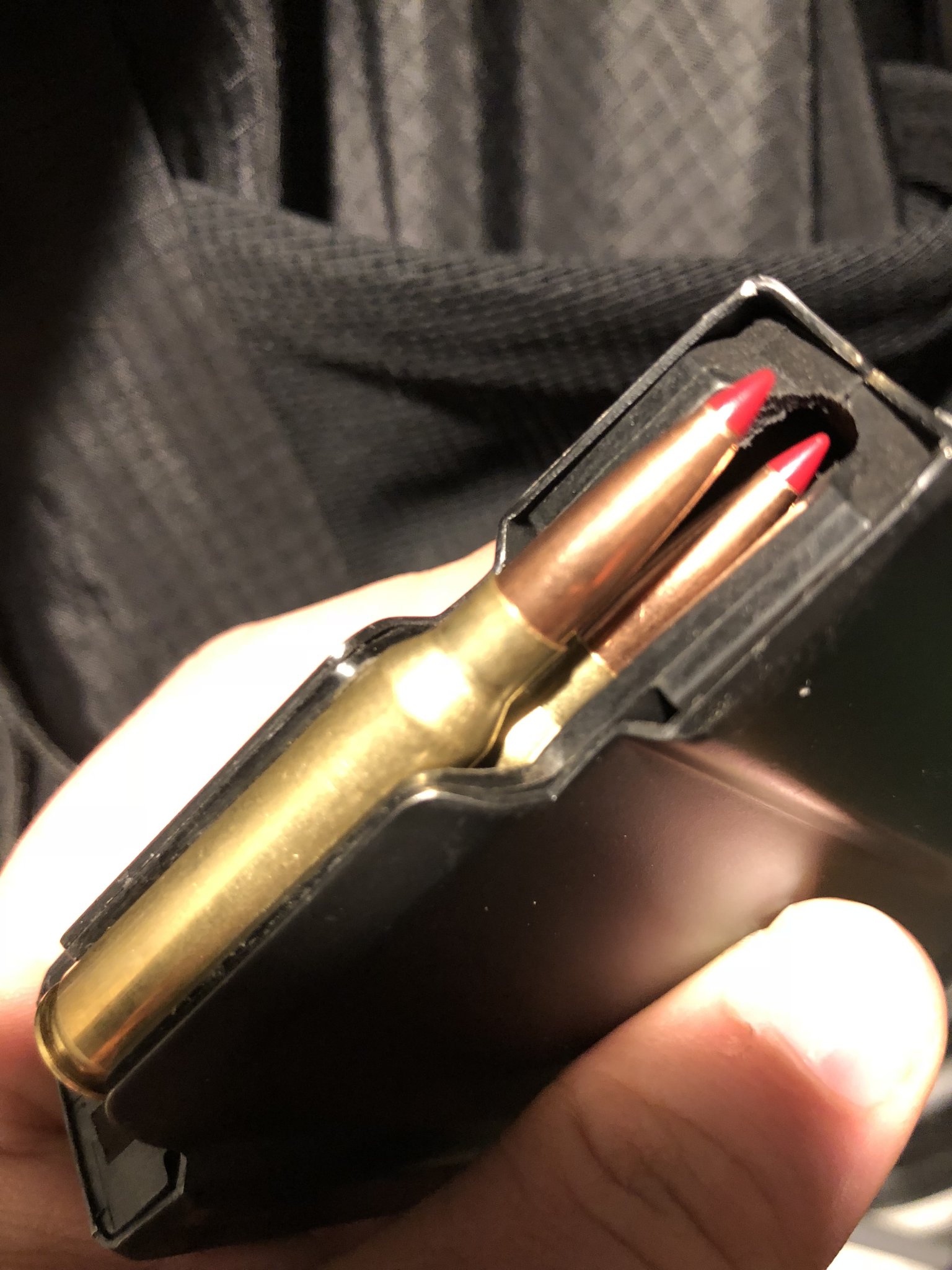

    I shoot a 223 with ISSF freebore and 27” barrel
    75gr eld-m
    24gr Varget
    2.500 OAL
    2890 FPS average
