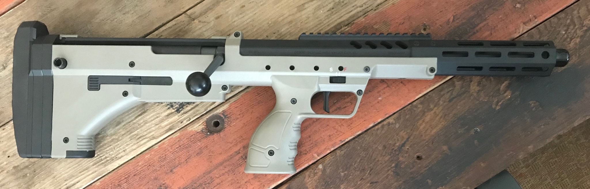

Does anyone have a muzzle brake recommendation for a 16.5" 308 (in a Desert Tech SRS)? This is my all-purpose "plinking inside 1000" setup, that I'll also be using for hunting, the occasional PRS style match, etc., so I'm looking for a balance between being able to spot hits, short & light weight, not super obnoxious, etc.
Oh yeah, another important fact...I live in CA so it will never have a suppressor on it. :(
Thanks!
Rob
