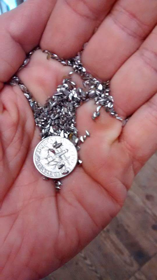

Try Southern Shine Media in FaceBook. They sell stainless steel chips that work great. Being smaller they get into the primer pocket, easily pour out of the case, and don't peen the brass. I moved to them about two years ago.
