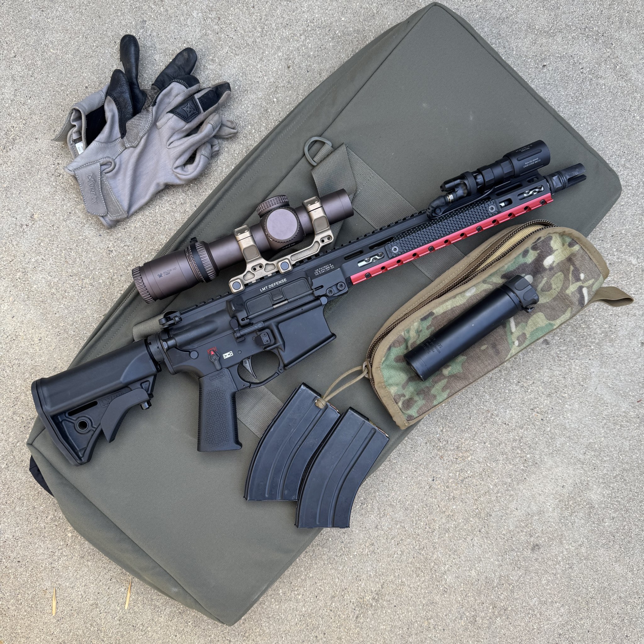

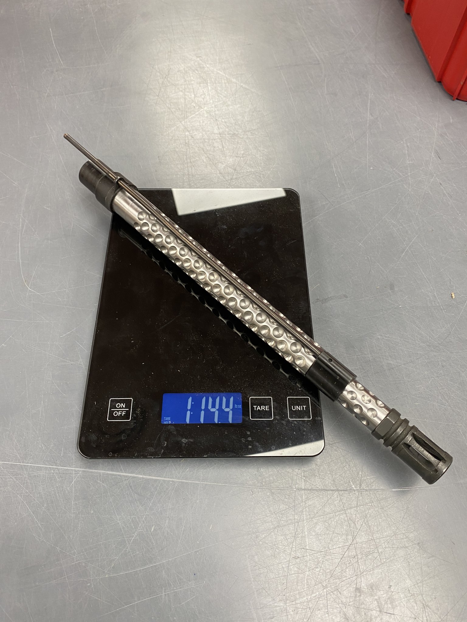

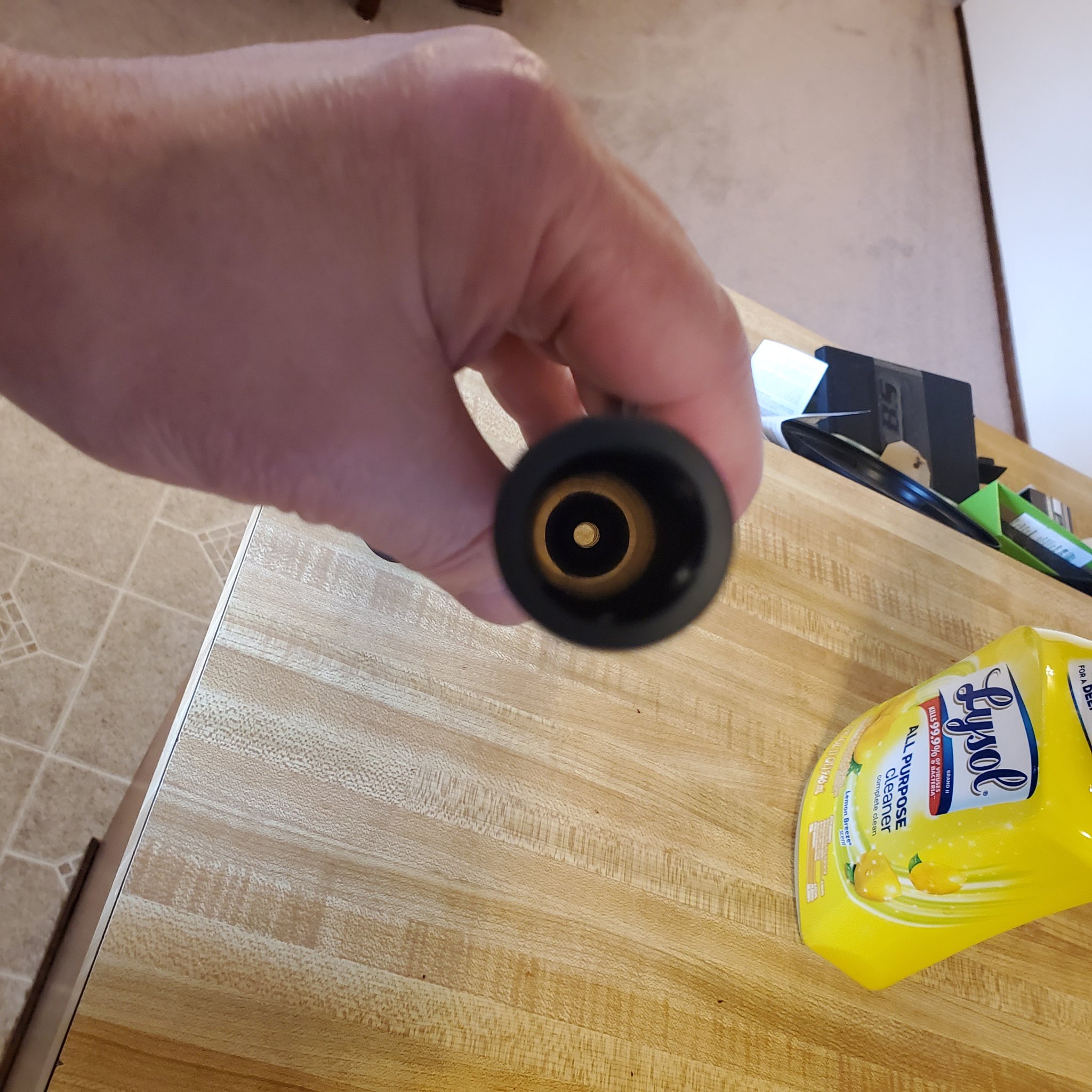

I made my own barrel.
I forget what kind of bolt this one has. It's either one from Classified Defense or JP.
Got any pics of the barrel uninstalled? Looks to be dimpled nicely.
Very slick. These higher performance cartridges really bring the AR-15 into where it should have been from the start.
I love 5.56, but it doesn’t cut the mustard as the distance increases.

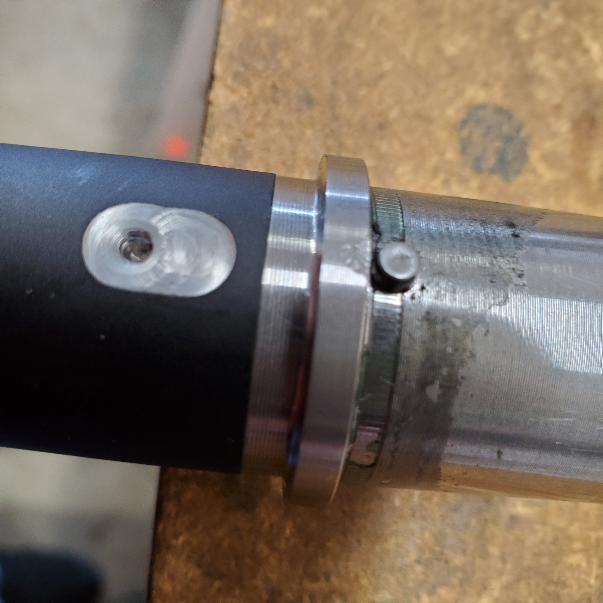

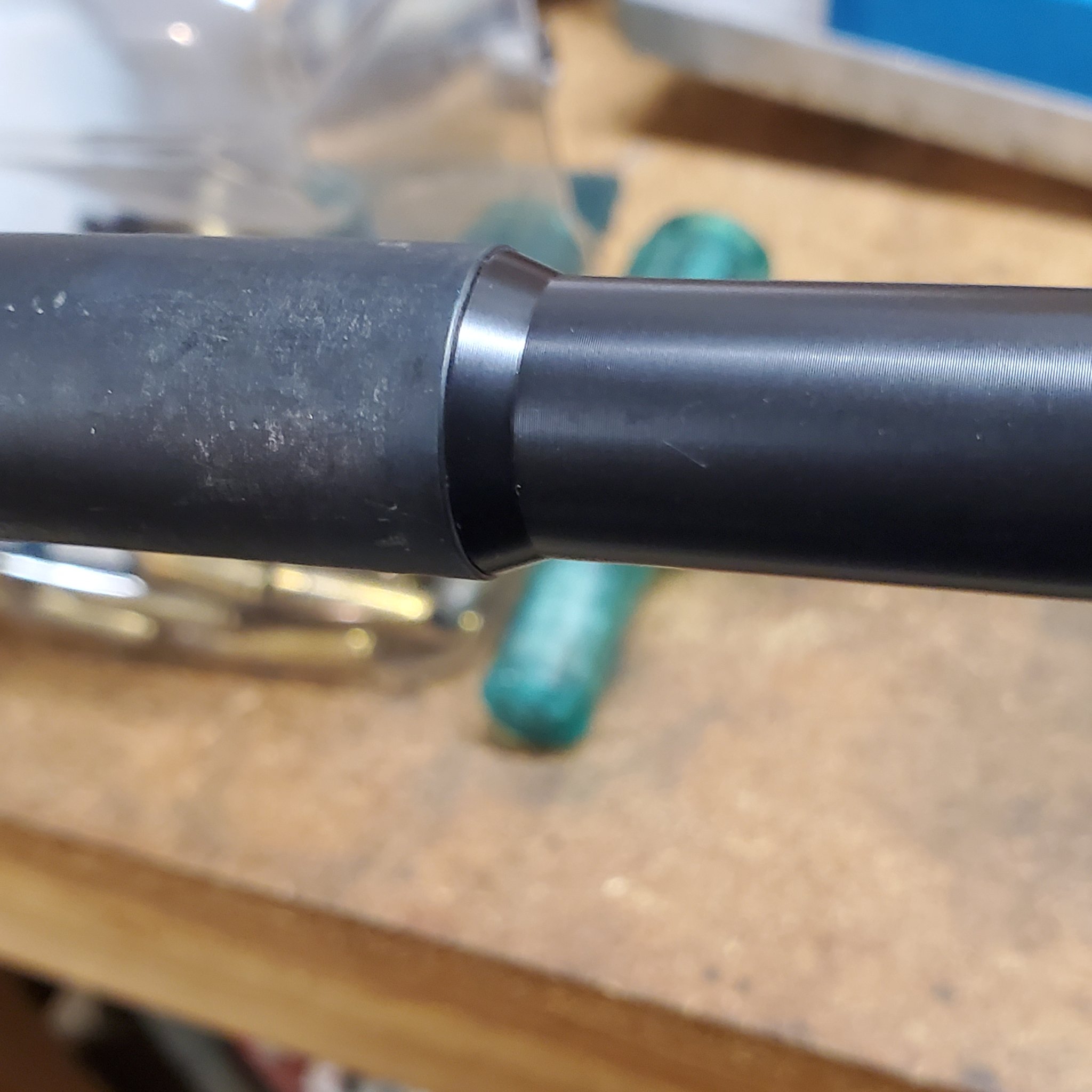

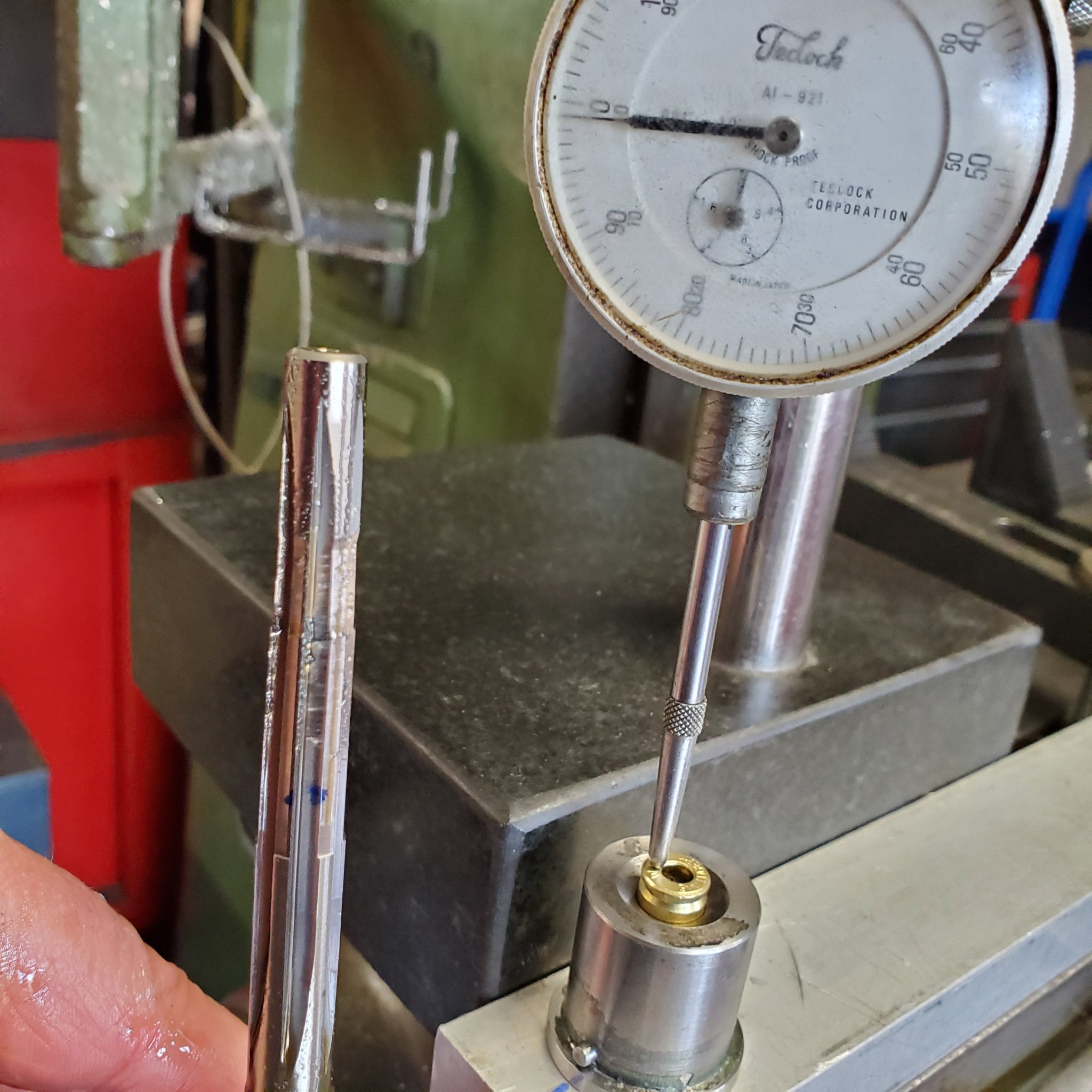

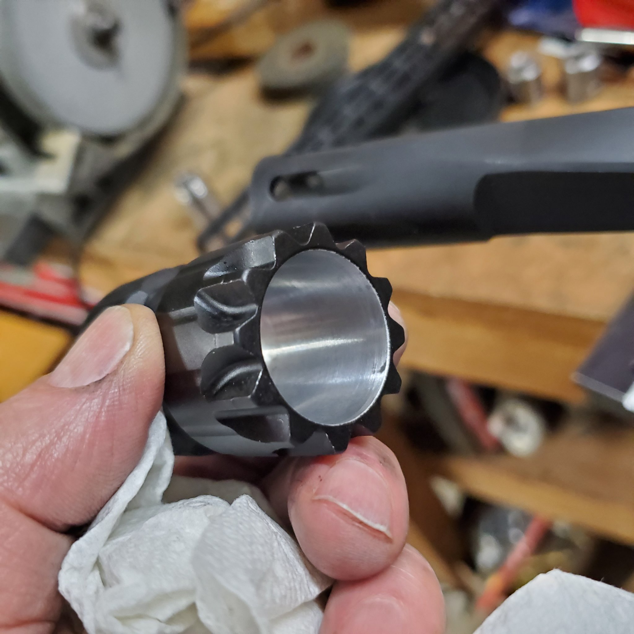

One could just get a 16" barrel and bore out the rifling in a lathe and make a moderate blast can / brake...or make a barrel extension on your lathe like the one pictured to get to 16" then pin and weld.
Odin used to make 5.5" bsrrels with an aluminum shroud pinned on to bring it to 16".... I had one, it was light, but needed to bore the barrel nut to fit over the aluminum shrouded barrel, and had to rechamber it, as it was chambered with a worn reamer and would not chamber all ammo but only undersized bullets would fit the chamber.
So its hard to recommend them to the average shooter.
And you can put an available extension on a short barrel, bring a 10.5" to 16"
