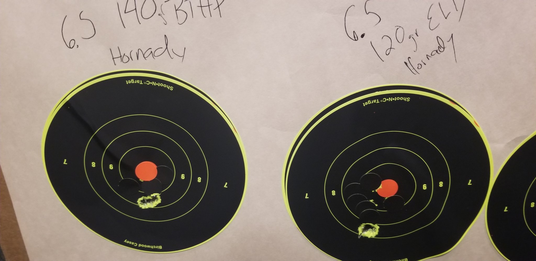

    Finally had a chance to get the new PVA 6.5cm barrel out to the range last night, and I was extremely fortunate for the shooter next to me who struck up a conversation and offered his LabRadar for me to get some initial velocity data. Setup/Data is as follows:
    Rifle Setup:
    1.) Curtis Vector
    2.) PVA 6.5cm, 22in M24 barrel, hand lapped/2x normalized, Surefire Brake (unsuppressed)
    3.) TT 5-25x
    4.) JAE Chassis
    5.) TT Diamond
    I put approximately 75 rounds through the tube before measuring the velocity, so it was relatively warmed up. These averages below were based of only seven rounds shot from each type of ammo (time was a factor).

    Understanding more data points would be beneficial for this analysis, but anything in this data set worth highlighting?
    I was fighting my bag/bench setup most of the night, couldn't get comfortable. But after I found a more comfortable position and got the barrel heated up, I was able to post these 3 x round groups just before grabbing velocity numbers:

    Are you looking for better accuracy or better numbers? Your second group looks pretty good. Have you thought about hand loading?
    I'm actually super happy with both at first glance, but given my inexperience with 6.5cm, I thought I'd get a temperature check.
    No intent to hand load as of now, only have enough time for one hobby.
    questions:
    (1) how many rounds is this chrono data based on?
    (2) what is your intended use of this rifle/load?
    That SD/ES would be unacceptable to me. As blbennett1288 cites, this is going to show up at >600.
    On other hand, that precise looks good to very good. Bugholes or one-hole groups. Can't ask for much more out of a tactical rifle (assume this isn't a benchrest setup).
    If it was me, I would redo this test with a chrono that I know is GTG. I would do at least 5 rounds, not including the CBS.

    Hey JB,
    Thx for the ping. To your questions:
    1 - 7 rounds for each factory load (all I had time for at the point I had access to the other shooter's labradar)
    2 - PRS and the like, no bench rest or hunting at this time w/this barrel
    Definitely worth another test after I clean (ick) and add some more rounds through the bore. Quick question back at you, what does CBS stand for?
    CBS = Cold Bore Shot.
    I like to remove it from the calculation when I'm solving for SD and ES. It tends to be lower than the group, so I remove it from the data. I do note it however, so if I have a long CBS to make, I know the estimated MV of it. It is typically 10fps or so slower than the average on the rest.
    If you only had 3 rounds or so in your data group and one was a CBS, it would have an impact. Shouldn't have much of an impact with the 7 rounds you collected.
