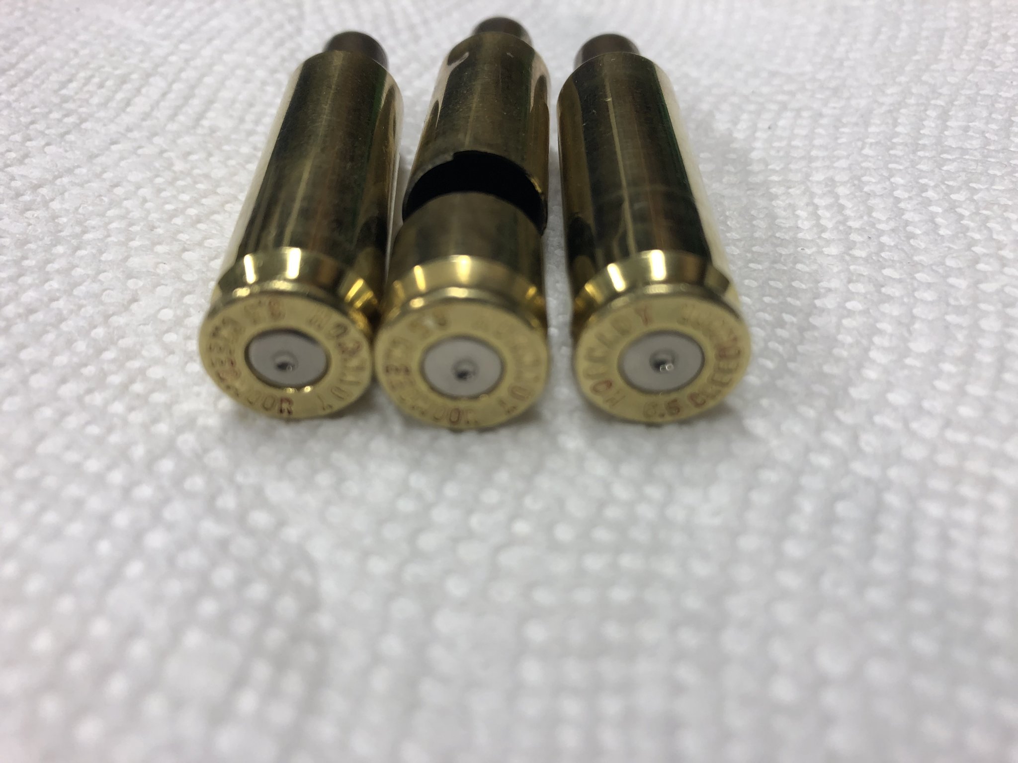

A friend of mine tried to shoot his brand new custom rifle today. Fired 3 rounds with this result:
Load was:
41.0 gr H4350, Sierra 142 MK, CCI LR BR Primers, and Hornady Brass. 5X fires
Any ideas on cause? I was thinking headspace, but the top brass chambered into another gun without issue. Not as good as testing with a no go gage but it shows the brass didn’t expand way too long.

Too much headspace.
If your buddy doesn't have a comparator, he could do a rough check by measuring OAL of a empty case that hasn't been fired yet, then adding layers of tape to the case head until he couldn't chamber it in the rifle, then measuring OAL again.
Too much shoulder bump.
I agree. Looks like the typical result from continually FLS with the dies set to make contact with the shell holder. Case head separation happens around the 5 reload when you do this and run near max. 41.0 of H4350 with a 142 SMK, and OAL of 2.800 is close to 58k psi. If you get a warm lot of powder you can hit 68k psi.
If the smith is reputable then headspace is likely not the issue. I always check, but most of those guys are crazy concerned about shipping something that is not in spec.
Powder charge has very little to do with CHS. It is stretching the case at the web as the shoulder moves forward. 41g of h4350 is generally not a hot load anyway.

i had this happen to me years ago, sent a rifle to a smith he cut the chamber for a standard rem recoil lug and not the new one which was thicker. i stared shooting it with factory ammo. didnt inspect any empty's, and case head separation from excessive head space. almost lost my eye fucked up the gun. dont shoot that gun again it could cost him his life. it sure looks like to much head space to me.

Builder is well known. I highly doubt they screwed up headspace that bad. Don’t want to drag them through the mud when it most likely isn’t their fault.
5x fired Hornady brass is likely the issue. He has shoulder bumped after every firing. I will bring tools this weekend as well as some factory ammo.
In the meantime, I’ve told him not to shoot it. Will update.

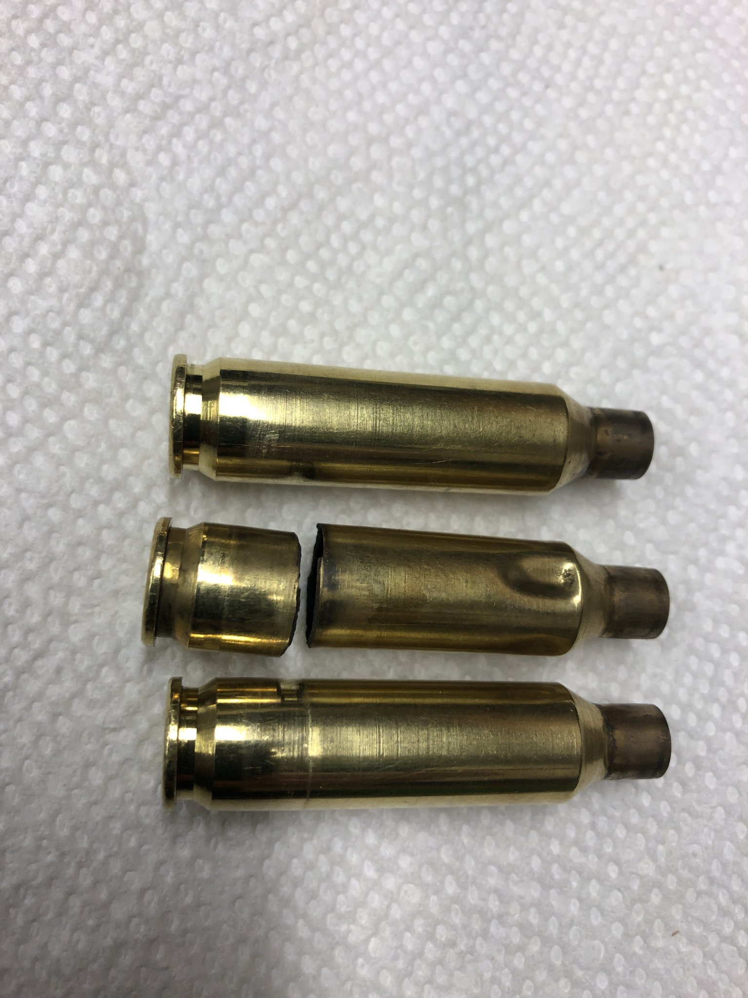

Although it is unlikely that over-pressure caused that CHS... in the second picture the primers look very flat. It is blurry and not a great angle, but the edges of the primer cup look very sharp and crisp.
Flat primers can be a sign of excessive headspace. The firing pin pushes the case forward, then the case head gets a running start at the bolt face.
I had a lyman 223 die that would produce CHS in one firing when cases were sized all the way to the to the shell plate. A couple of them fully separated like #2 in the picture. All had very flat primers.
I had some 6.5 creed that did it at about 3 loadings due to a chamber that would close on a field gauge, and .007 shoulder bump. So I order some proper measuring tools rather than using the method of easing the die down until the case chambers. These started to show cracks but never actually separated. {because I trashed them of course}

Could be fairies or dragons or trolls or a 3-headed cow but I'm going with - sized the cases too much, pushed the shoulder down too far. I have a gallon ziploc bag half full of incipient head separations I have collected over the years including 50 Lapua 308 cases where I did exactly that and screwed up every one.
Pull trigger, firing pin pushes case forward against the shoulder, primer fires, building gas pressure holds the forward end of the case tight against the chamber walls, the base of the case is pushed back to the bolt face and the case splits at the web. The most dangerous part is the high-pressure gas flying around. In a Remington 700, a small bit of smoke will come around the bolt face. In picture 2, I see light strikes - that matches. I get it is pedestrian, even ordinary and common, but I submit, the most probably cause.
