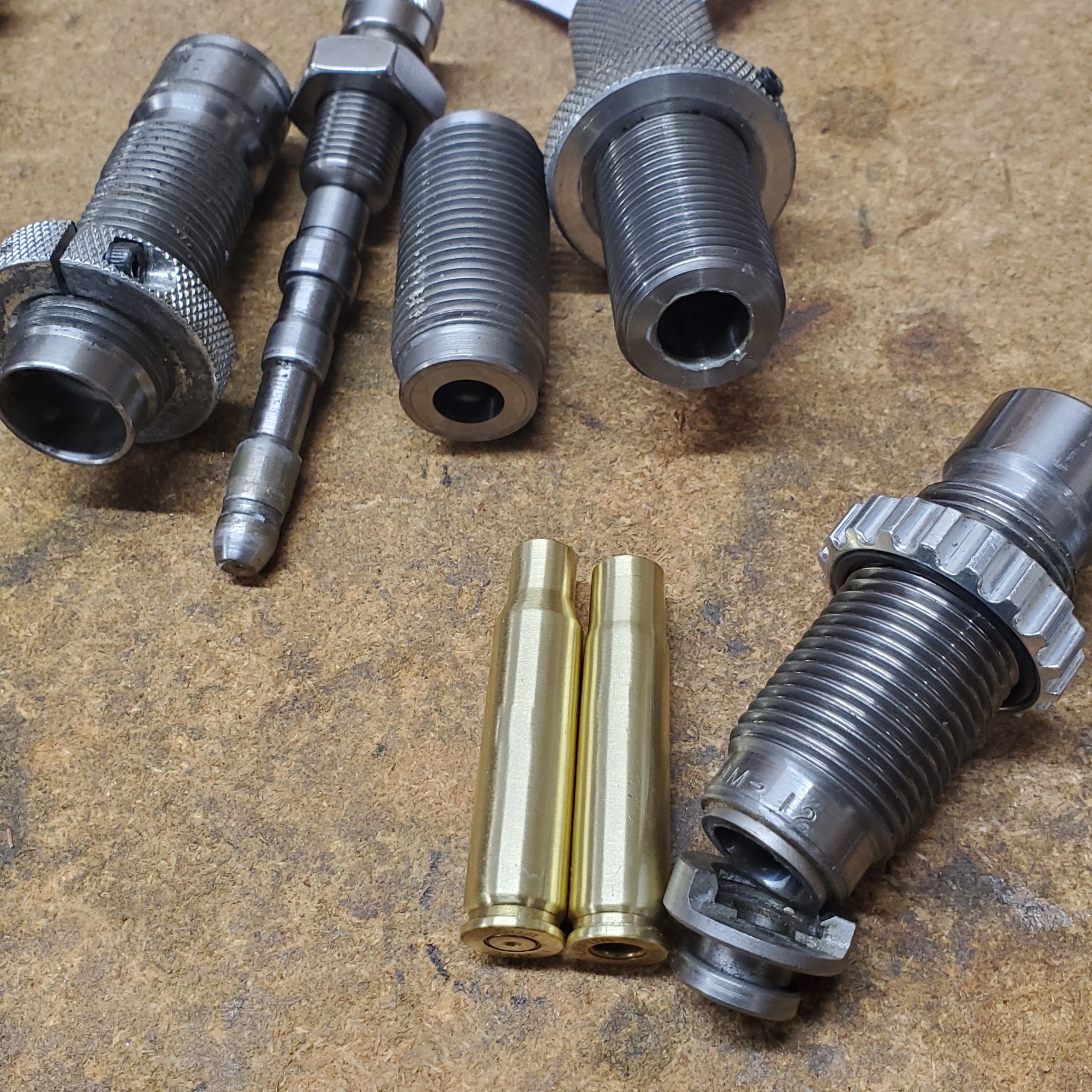

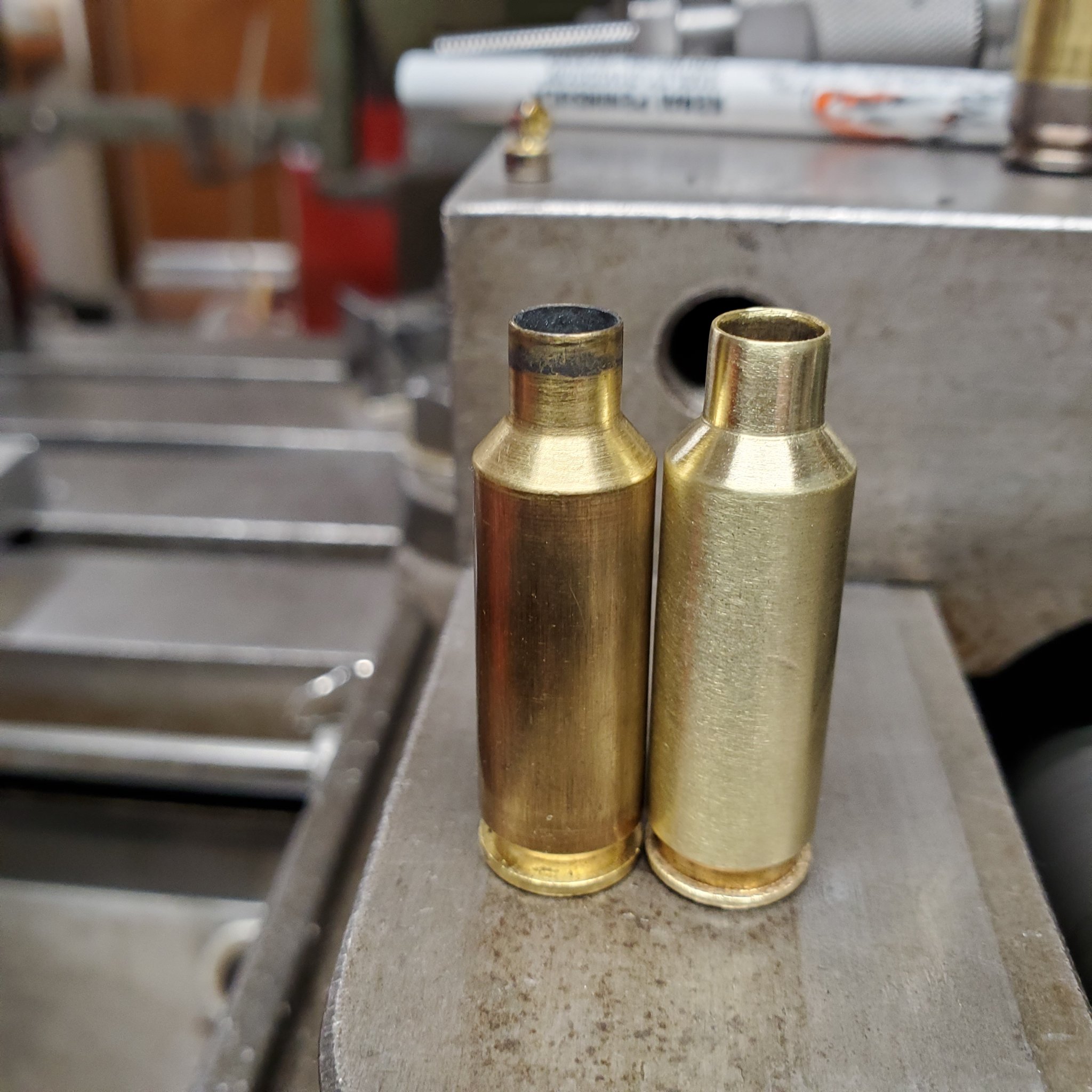

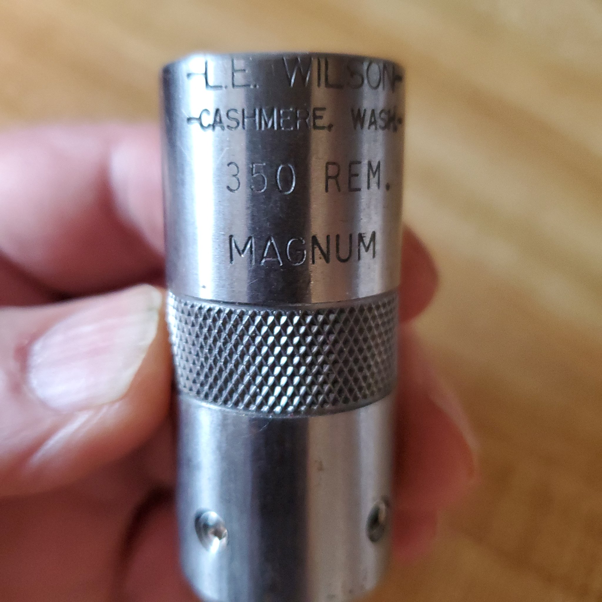

Here is a belted magnum headspace gauge, next to just 3 of the many .535 " belted magnums its capable of checking headspace on.
Their case bodies are all different but the case head from the back of the rim to the front of belt are all the same.
So nothing can be corrected past the front edge of the case belt, as that IS your headspace distance.
Running a belted magnum finish reamer deeper will take your chamber out of print, with excessive headspace, and out of industry standards for the belted magnum.

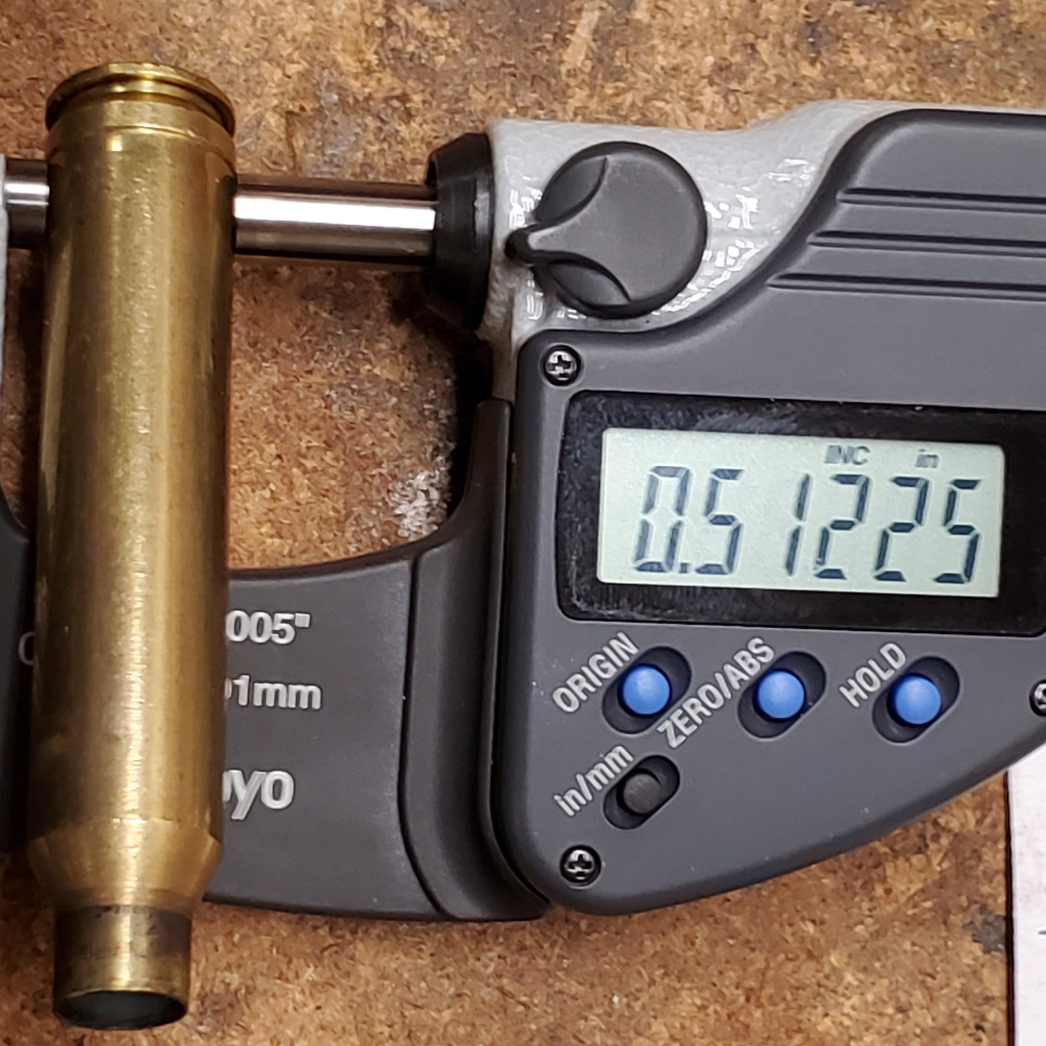

The mag chamber vs the sizing die, tolerance in the .513" to .510" area is the problem.

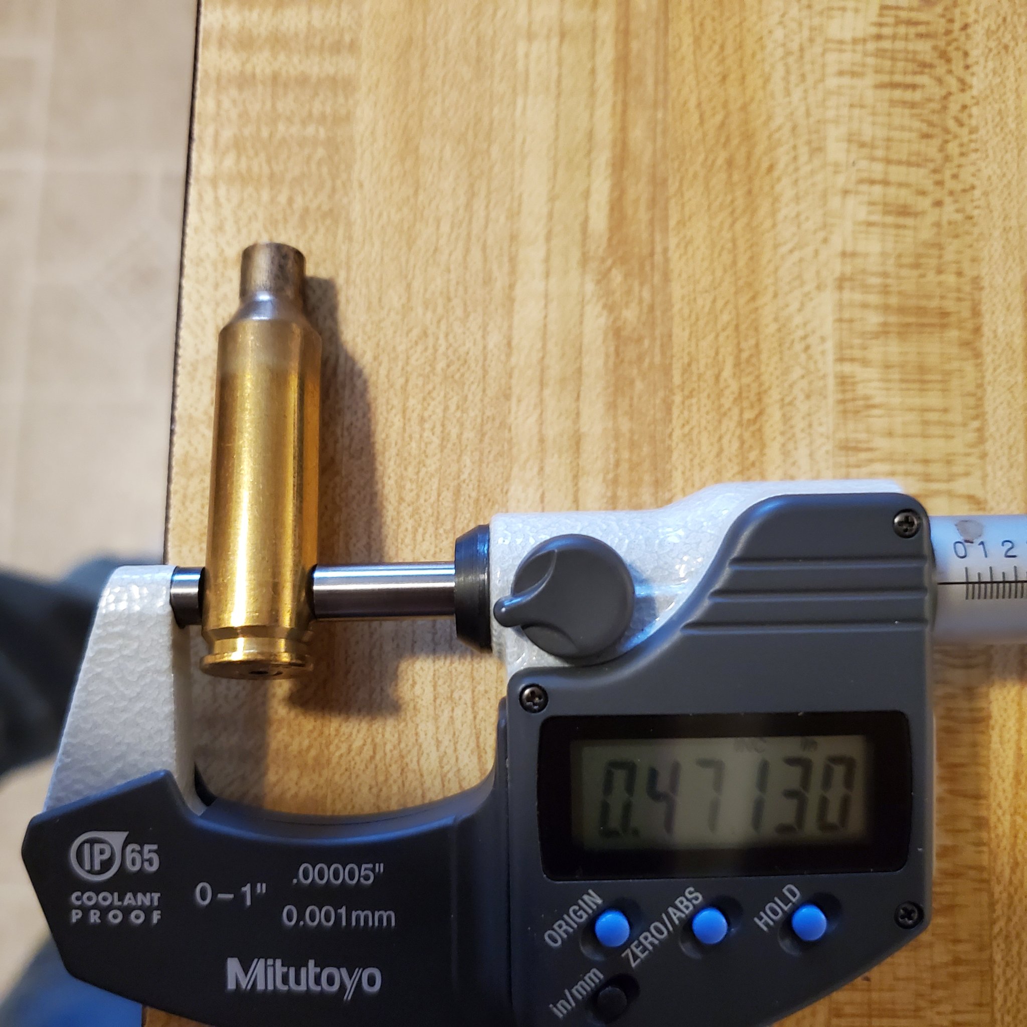

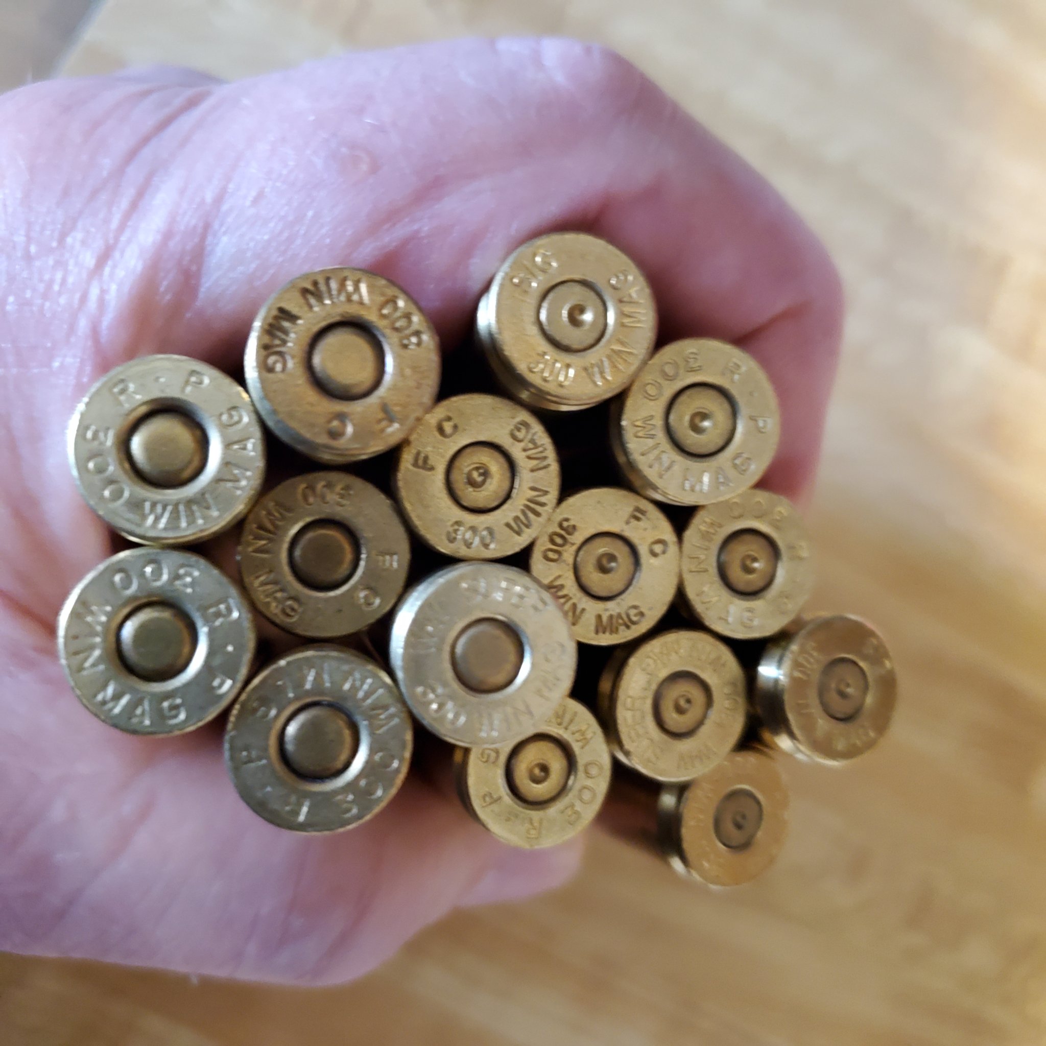

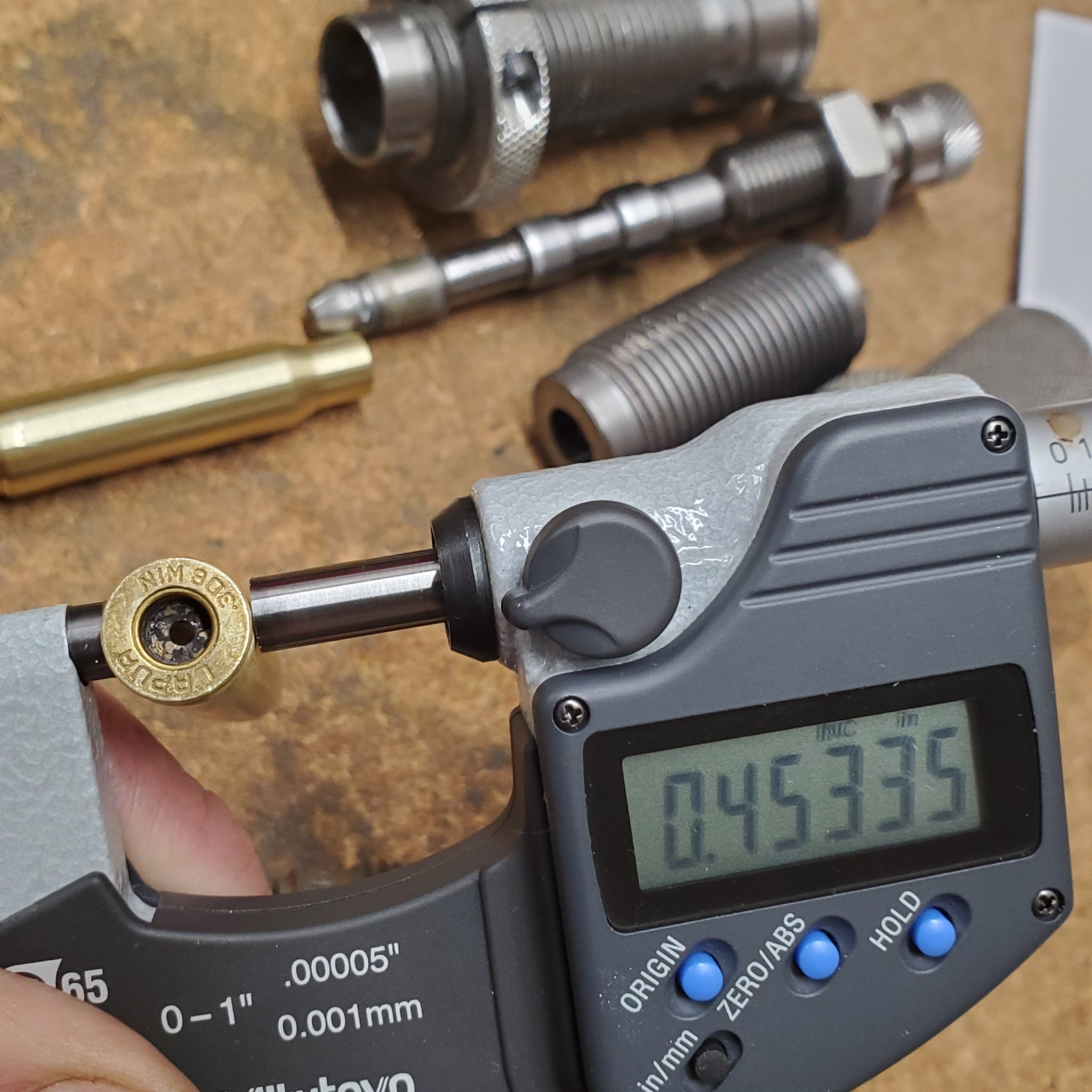

Here's a hand full of loaded and fired 300WM cases, range pick up, field finds, freebies, all sized and loaded in a RCBS die, factory chamber, hand load 200 gr SMK shot 5 rds into 1/2".
Or 230 SMk at 2960 fps, use an aluminum chassis and 3.715 or 3.850" MDT mags to improve the 300WM performance....stuffed with slooow powders.
Wilson makes an adjustable belted mag cartridge gauge to help set the shoulder back the amount needed for your chamber, may be helpful to some... and annealing after 4 or 5 firings will help with shoulder spring back irregularities.

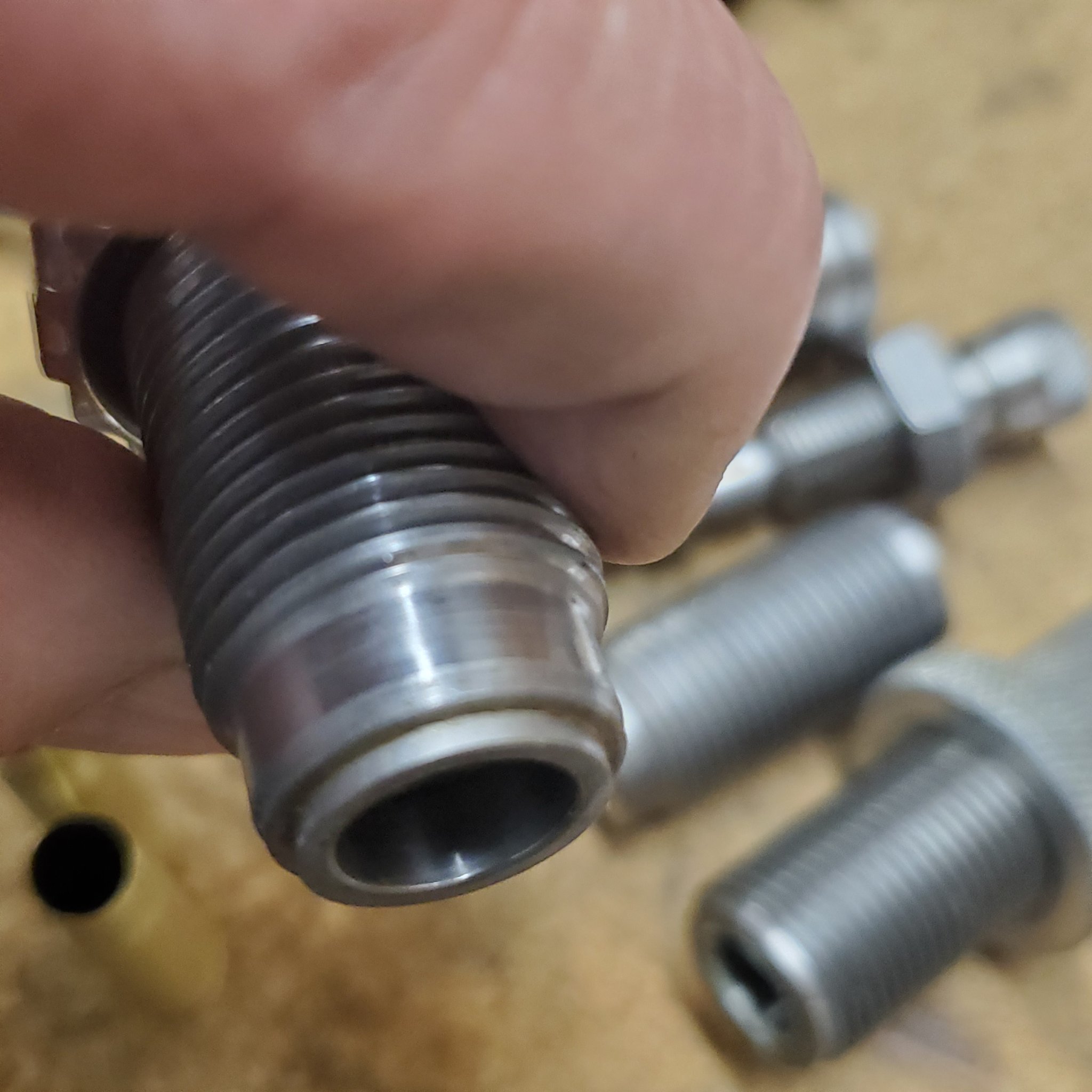

If that's the case, why do the dies for non-belted cases not create that donut?
You are obviously under-informed, even after reading what you posted.
The maker of the collet die says that the FL die does not "sometimes" size the case in this area enough...
So as he even states it's a sizing die problem....which it is, cause I've never experienced it in 50 yrs any of the many belted mags I've owned.
Non belted cases don't create a "donut", you say.
That is also false, they most definitely do.
But you are at the wrong end of the case if you're talking about "donuts."
Belted cases and non belted cases have the same issues, when you ignore headspaceing off the belt as every handloader does after firing a new case.
Autos in non belted cases often use small base dies to feed autos as chambers get dirty from propellet gas, or just a bit tight.
Its not "donuts" but case head separation.
New, Non belted 6.5 CM fired case expands above where the belt on the magnum would be...one the first firing as measured. Same exact thing happens a bulge or incorrectly a "donut" happens here, on all cases as designed to seal the chamber under pressure, the solid portion does not expand under normal operating pressure.
But normally the sizing die, sizes it back down, to fit the chamber of the 6.5 CM, an auto loading 6.5 CM may need a bit more sizing, or any other chamber where RCBC has made many small base dies to alleviate chambering problems.

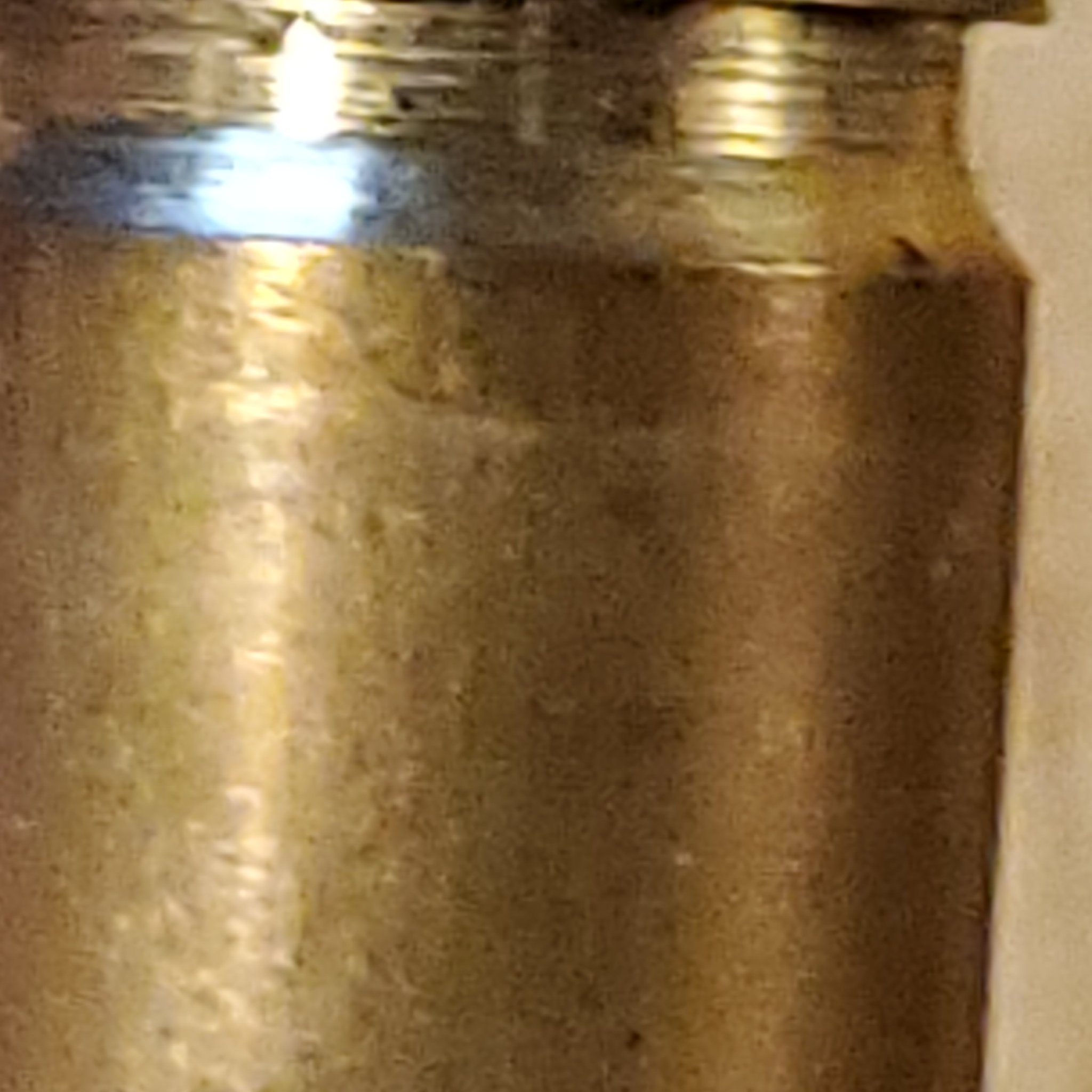

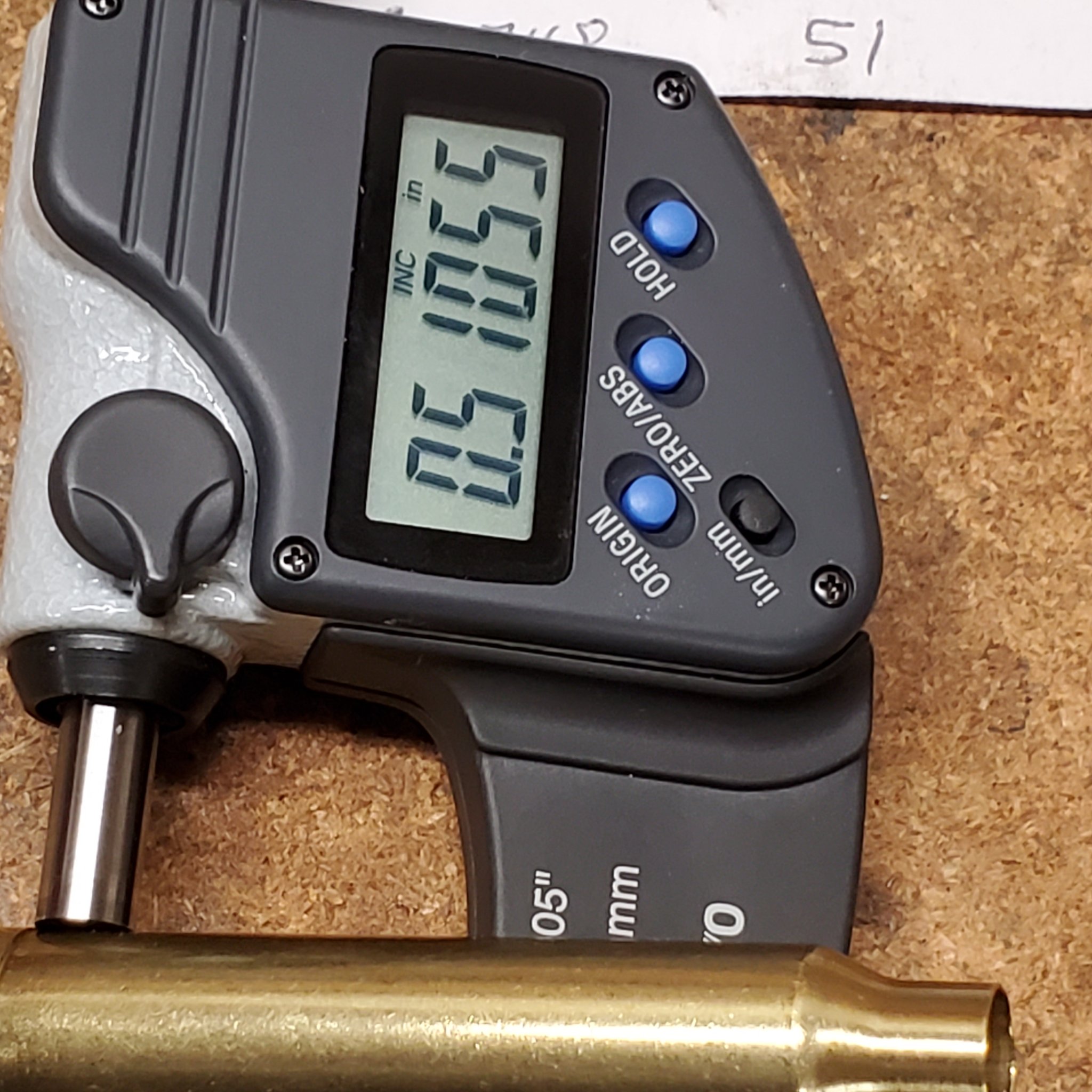

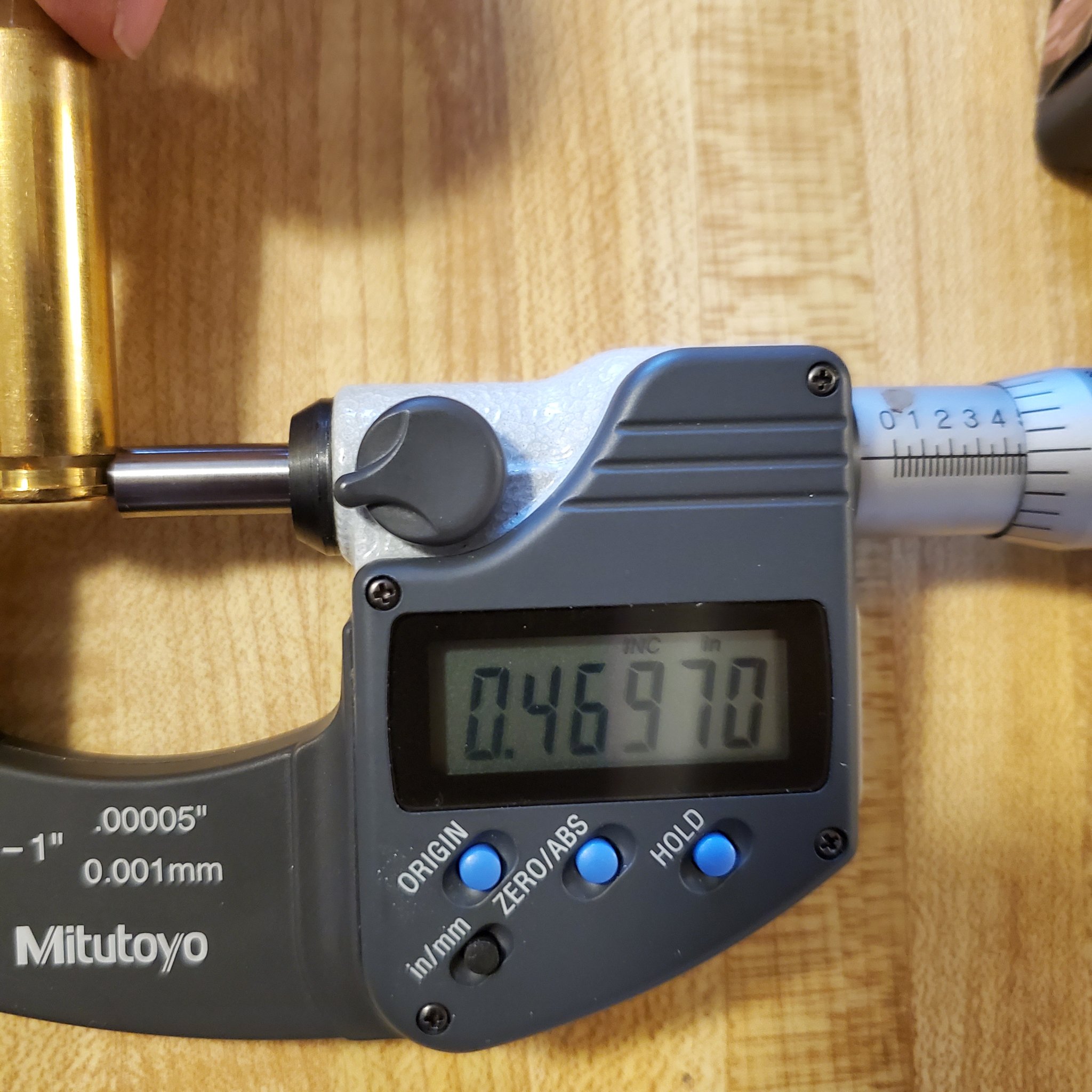

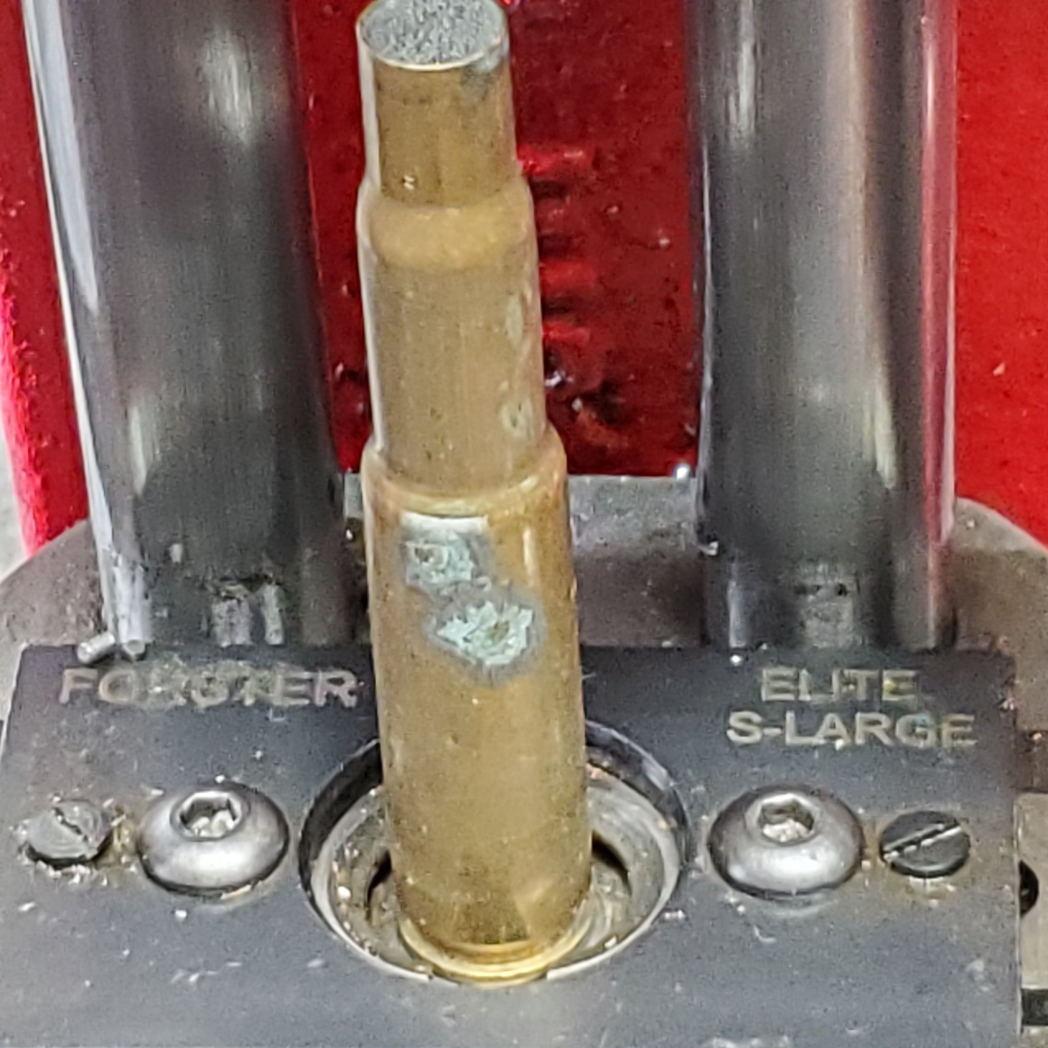

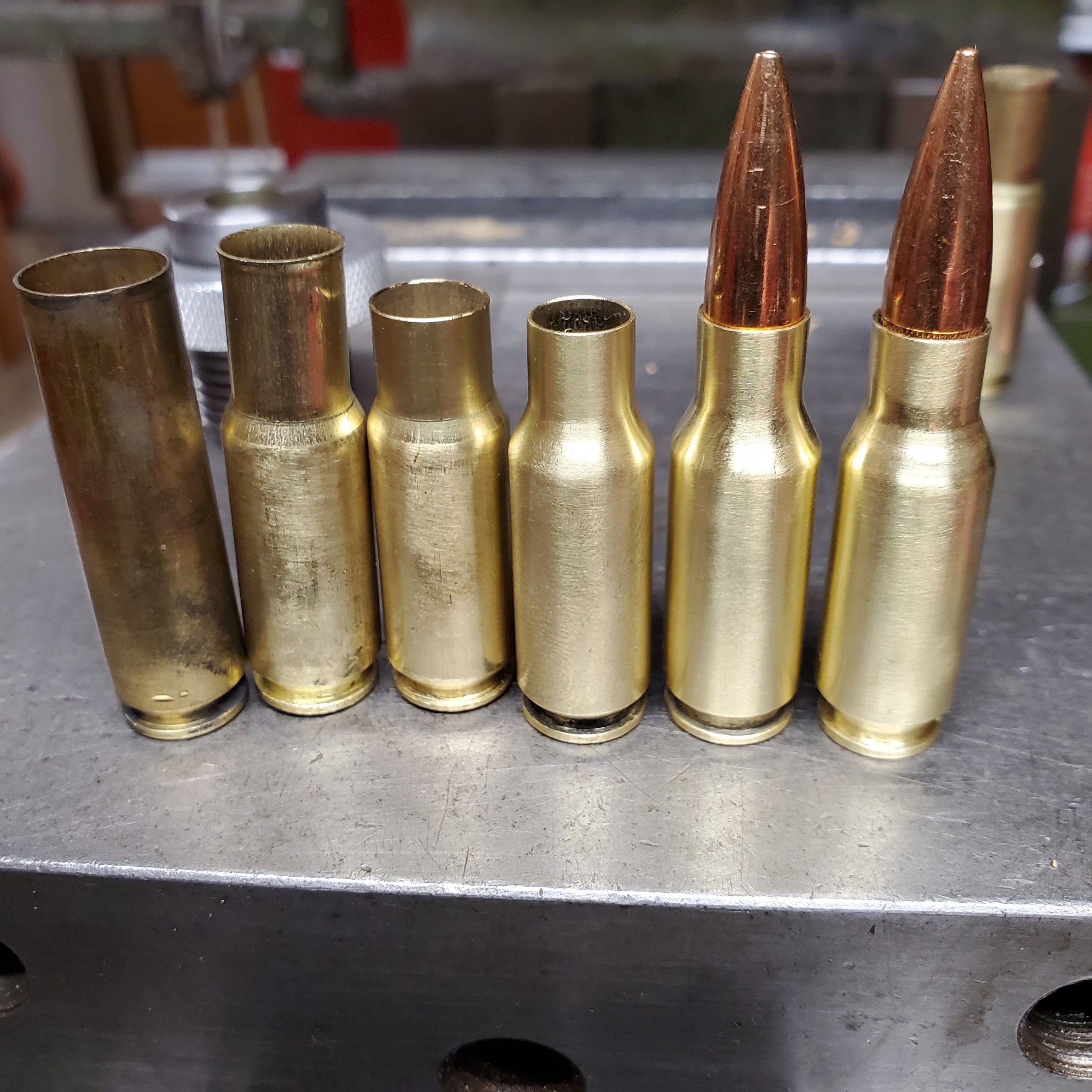

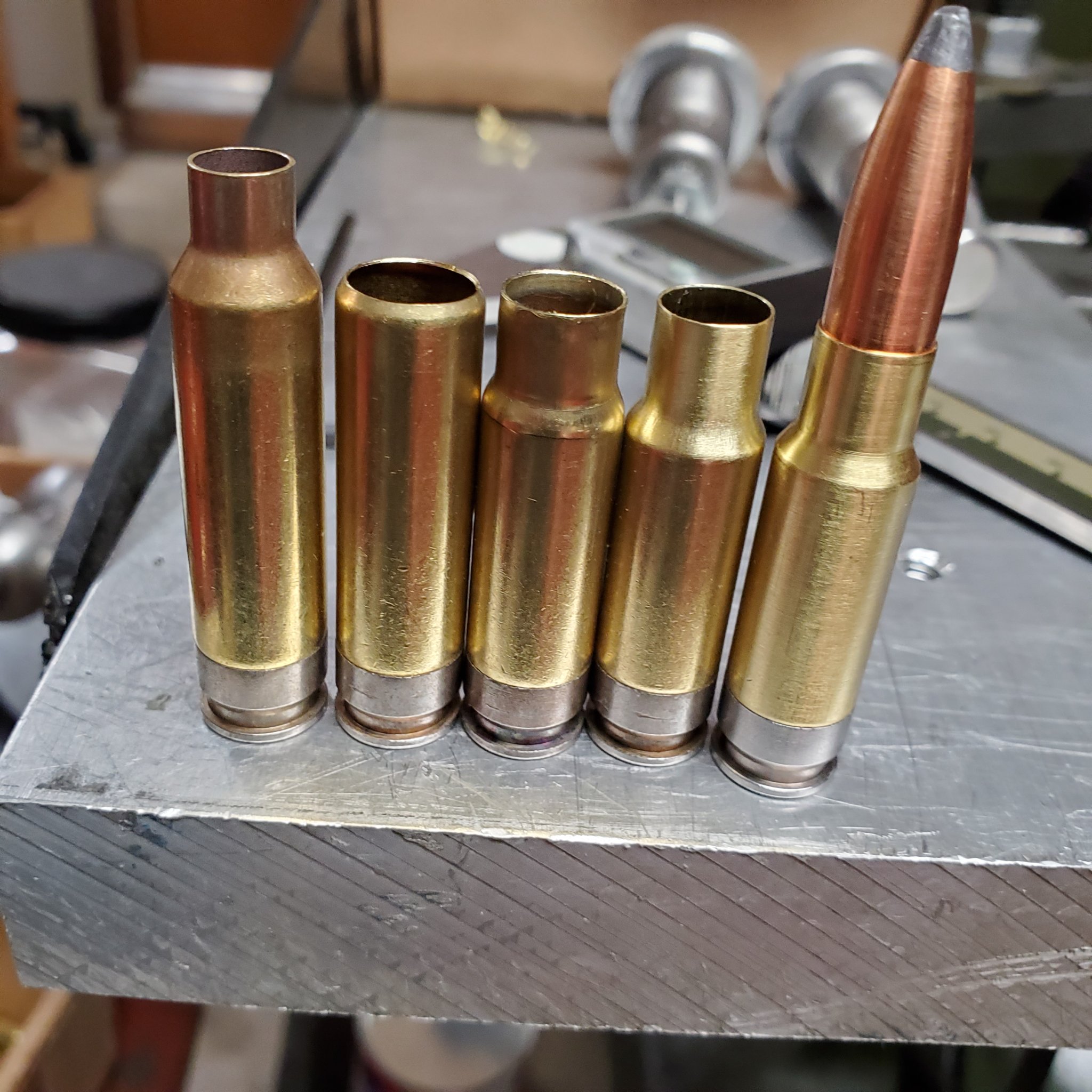

Here is a 308 developing case head separation the same place as a 300WM, where the bulge or "your donut" would be.
This next one is developing a crack.
This is not an isolated incident, I have maybe 5 or 6 hundred Lapua 308 cases this way....but the sizing die kept resizing enough in "that area", just ahead of where the belt would be, to keep the going in the chamber.
It's what happens when you push them to 40 reloadings.
Make a hook tool to go down inside the case and you will feel when this starts to happen, then discard that case, belted or not....same deal.

Two pictures are worth a thousand words... 100% of the time my belted mag dies alway size the area right up to the belt back to where they alway chamber easily....as even You can plainly see.
Never had a problem with the belted case not sizing down....but a few might, so get different dies or try the collet die, that's up to you.
So mostly it's a die problem.
My 300 Win mag die sizes the area in question back to .5105" after firing a heavy max 230 gr, 2962 fps load,... its .5122"
So all my belted mag dies size all my magnum cases enough to where they always chamber and extract easily, for 50 years never need a collet die... because the chamber /die relationship is usually manufactured correctly for many years, since 1912, with the H&H.
School is out, grasshopper...time for you to gain some practical experience, on your own.
Reactions: Aftermath
Obviously, since the well documented bulge does occur, has occurred and will continue to occur, your 50 year sample of all sorts of belted cases remains a bit of an outliar. Of course, if it hasn't happened to you, you MUST be doing everything so much more gooder than everyone else.
As you say, pics are worth words.
The sizing die has a chamfer or more commonly a radius cut where the steel meets the brass. Without this ease, the die would scrape or cut the brass as the brass is pushed up into the die. That area does not size the case. Unfortunately, in the belted magnum, that coincides where the brass is thinned due to the forces of compression. The die cannot run across that area due to the diameter of the belt interfering with the stroke of the die, unlike your example of the 308, the die cannot size that area.
Here ya go, Skippy, a cutout view of the base of a standard die showing a chamfer.
Your intelligence and knowledge of the subject is showing...
THAT'S NOT A BELTED MAGNUM
Your picture and statements do not apply.
Do you own a belted magnum?
You have no practical experience, just trying to apply a picture you found on the net, that does not even address the subject.
There is no bulge where the die does not reach it's solid brass with a flash hole...or you'd pull the case heads off by just sizing or maybe even firing, unless low pressure cartridge, like blackpowder.
Go look at your belted magnum die, ...oh, you don't have one!
It does not have a big champhered lead in, because of the big hole dia of the belt.
It only has a fairly sharp aprox .010" radius with the case having a .005" aprox radius, so it sizes right next to the belt, ....But the highest portion of the bulge is farther away from the belt....allowing it to be sized back down. As I have actually shown in pictures .512" to 5105" between fired and sized.
Plus the fact millions of other shooters, have been shooting and reloading magnums since 1912 in the H&H in Africa by professional hunters, followed by Weatherby, Winchester, for dangerous game...successfully all those years.
So you want to talk dies with your lack of basic knowledge, regurgitating things you've heard on line.
Here is a die set I made to make 35 Rem out of 308 for a shooting friend.
Notice one carbide die only has a small champher, and under cut with a modified shell holder to get down to the rim, way below where standard dies stop. Sizing the 308 W .470" portion to 35 REM dim.
No die maker on the planet has made a die that will take .270 Win to 8.6 Blackout with out lube in one sizing operation, as pictured with this crusty .270 case
308 to 6 dasher, 308 to 6mm ARC, obsolete and wildcat calibers, 401 SL, 351SL, 30 Rem, 30 RAR, 35 Rem, 510 Whisper.
Plus making cartridge gauges, brass go gauges, chambering my own barrels, building AR barrels from blanks.
I do not know it all and am always learning.
and willing to help and share what I've learned. I have the experience, and the tools, as well as a few others, you obviously do not.
Your clownish, immature, whinny, combative,attitude, like many, adds nothing. But shows alot about your wholly lacking character.
Plus if I had a problem with belted Mag cases I'd have already fixed it many years ago. I can make dies and collets.
Or just show a picture of you riding your tricycle...something you have actually accomplished. Or maybe a sized 300 Mag case?

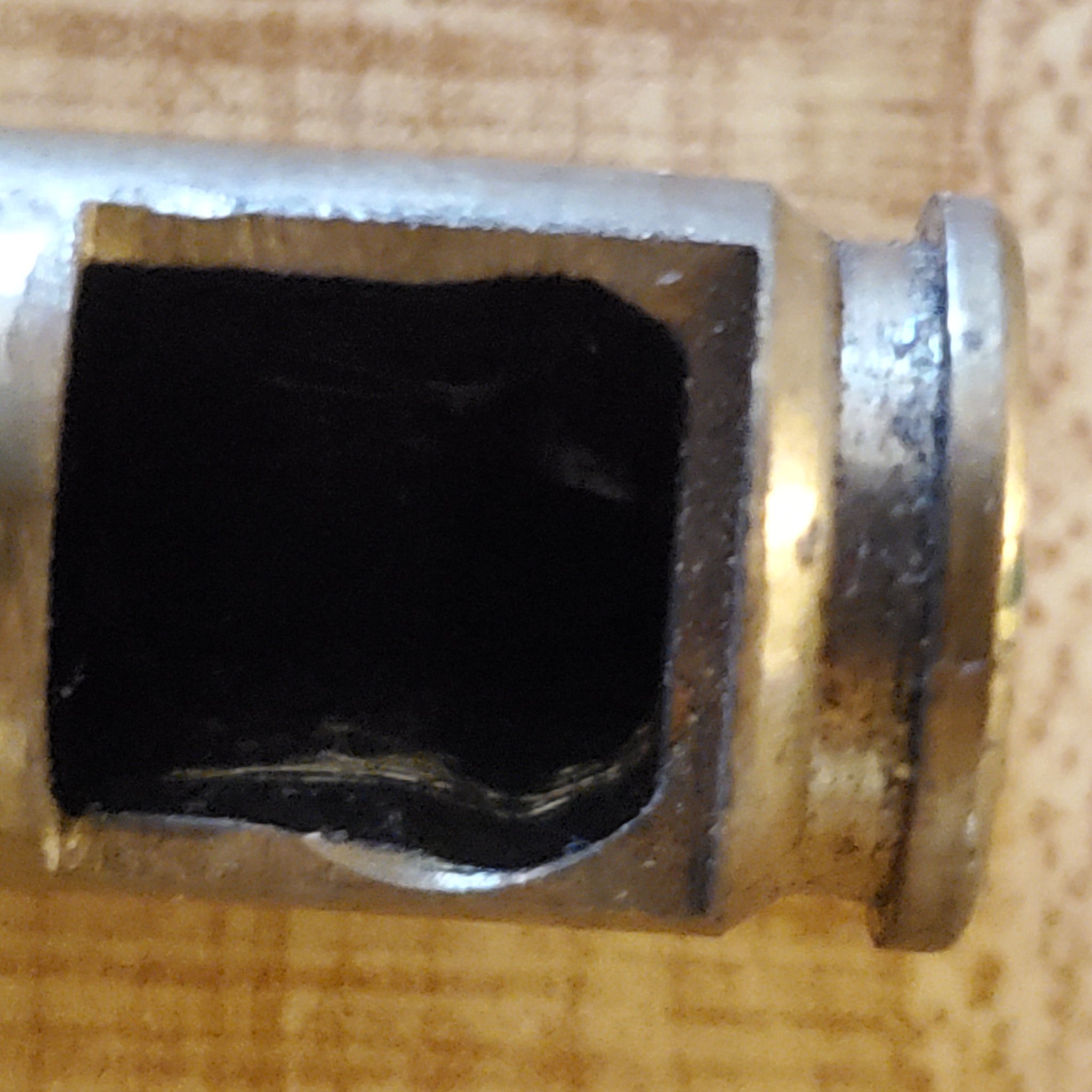

Rteague77,
I had a similar experience that might be relevant.
My buddy purchased a used Rem 700 Stainless (Sendero?) in 300 Win Mag that appeared to be in brand new condition in the box.
Live rounds didn't eject effortlessly and fired rounds required a very significant tap on the bolt to eject.
A quick glance didn't show any obvious pressure issues or chamber issues.
However, studying the brass under a magnifying loop showed a distinct scratch and tiny divot in the same place about a 1/4 of the way up the case...on every case.
A bore scope in the chamber showed a little galled spot terminating in a bead of stainless that I missed without the scope.
A slotted dowel in a cordless drill with a few seconds of 400 grit paper and green rouge, followed by 600 and 800 grit with pink rouge resulted in a polished chamber and no galled bump.
Brass ejects flawlessly now and I suspect I know why the rifle was being sold despite appearing new!
Not sure if that is what you are dealing with but I would spend a few minutes polishing that chamber before I gave up on it.
