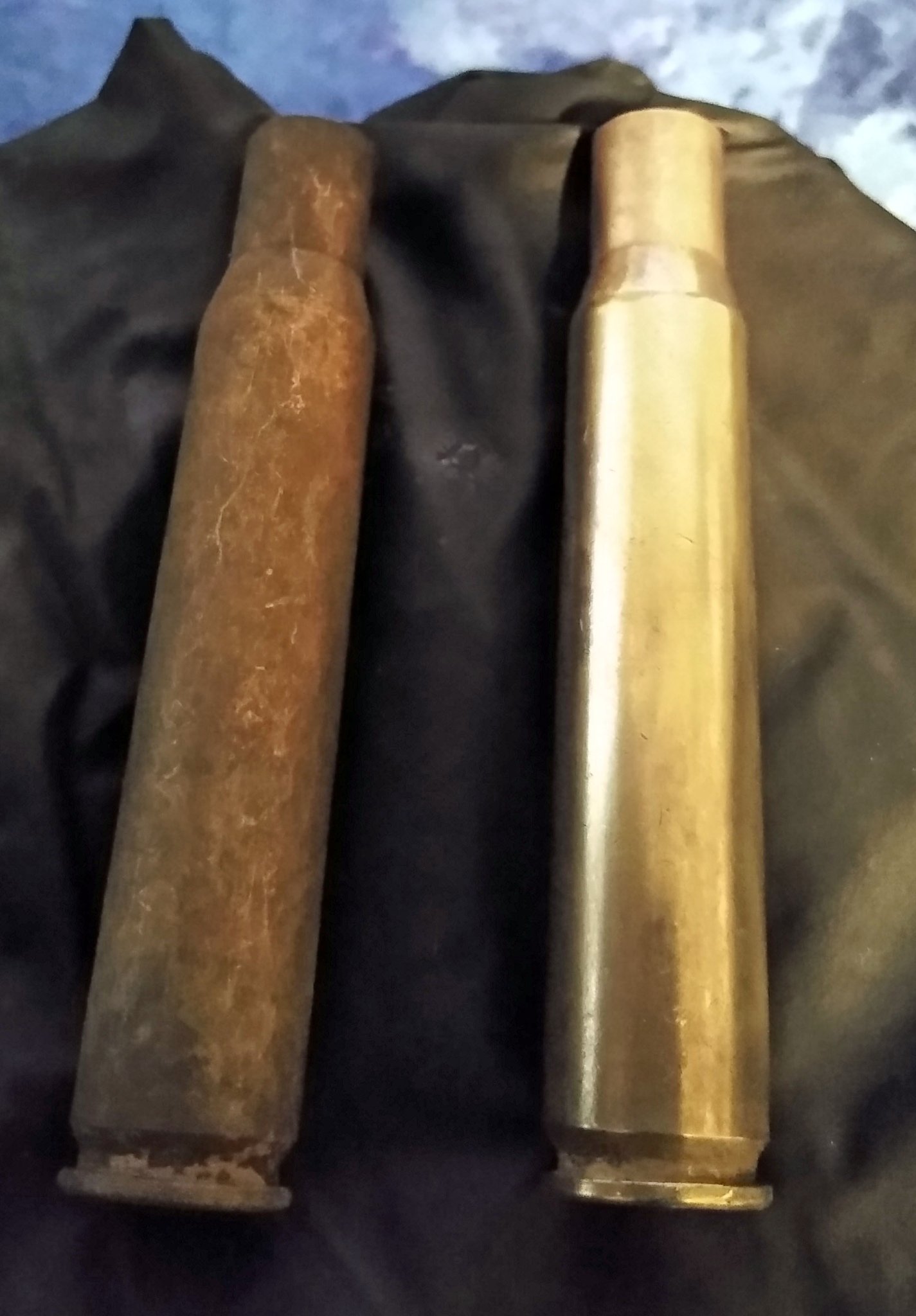

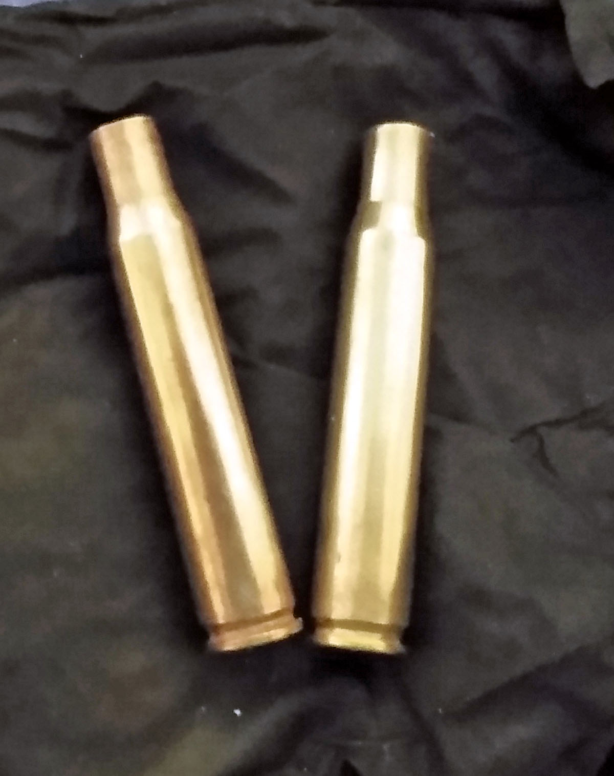

I use a sonic cleaner for my brass.
IF You are Using an ultrasonic cleaner , remove cases shake in a strainer rinse in plain water and then force dry with air and tumbling .
Good to go . Ultimate homemade cleaning solution ; #1 Gallon water ,#3 tbsp citric acid ,#2 tbsp Dawn Ultra dish soap .
Mix well try not to shake . Solution can be used over and over ,simply strain via paper coffee filter to remove debris .
Caution DON'T leave cases in solution longer than 3-5 minutes . Experiment with #1 minute intervals per Your # of case loading and caliber .

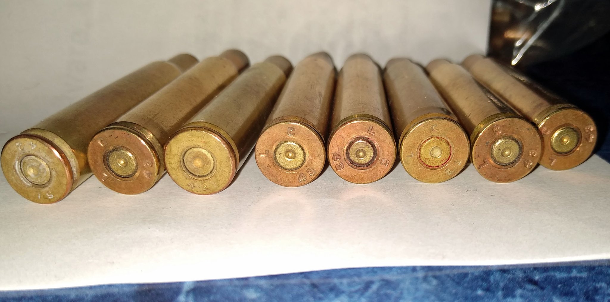

Mine are from 1942-43 UGLY left to the weather over 70 years .30 Cal . M2 cases . My transducers are industrial #3 varying KHz ,so clean faster than most . Example 3.5 Minutes .
All cases were initially partially neck shoulder annealed and again after every 3 Rd. firing and as of last week , #55 have #50 Reloads all within 1.0 grain maximum charge for M1 Garand . I had #56 in the test group ( 8X7 enblocs ) but cut one so as to actually measure case wall stretch . Obviously these are extreme examples ,so imagine what ordinary brass looks like and how quickly they clean .
