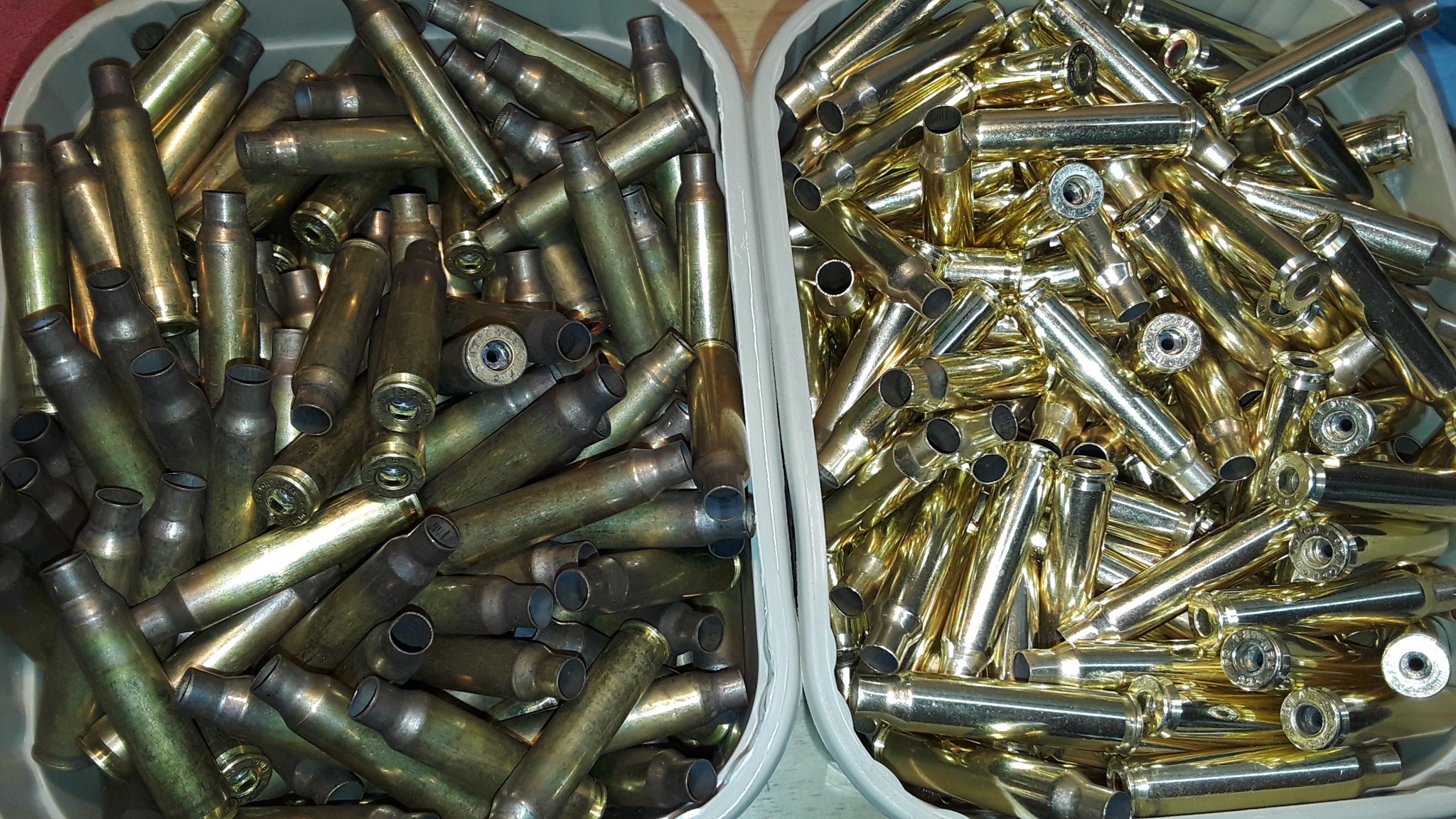

I use an old dehydrator. I can fit about 500 .308 on the trays and works great. Way better than firing up the oven

Just rinse the cleaner off and dry. Comes out spot free
I usually air dry mine spread out over a large grate. Spin and shake them real good to get as much water off and then towel dry them and put the. On the grate overnight.
Dry with a towel and then in the oven on [warm] for about 45min. I use a couple of those cheap tin pans like you would cook a turkey in. Got them from the dollar store.
This is what I use but there are definitely cheaper ones. I used it to make beef jerky long ago. Just found a better purpose for it
