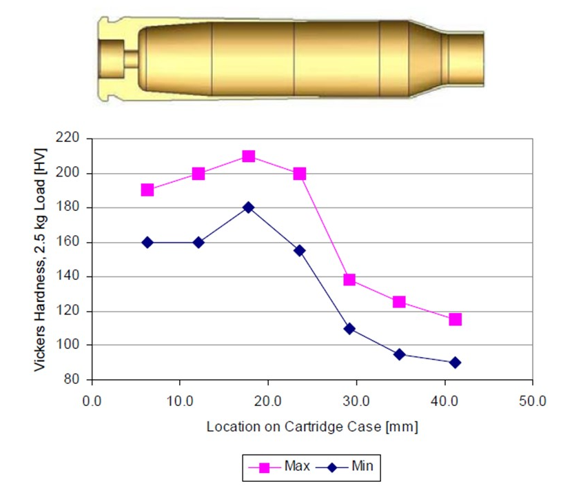

    If you flip through a web site like Starline, you might notice they sell two types of 223/556 brass, and the difference is the hardness of the head/rim area. Here is a plot of the requirement for a typical 5.56 case intended for the old M855 spec.
    Notice that there isn't a single hardness value, there is a hardness tolerance by zone. In this example, the head/rim area is roughly 175 while the neck is roughly 103. It may or may not sound like a big difference to you, but it is.
    Keep in mind, we use hardness as a proxy value for other material properties. In other words, it isn't really specifically the hardness we are all that concerned about. We use hardness because the other properties like tensile and yield strength that are coupled to the hardness are so much more difficult to measure, thus we use hardness in production control because it is easy to test. The main point is, when that hardness is right, the modulus, yield and tensile strength are also going to follow.
