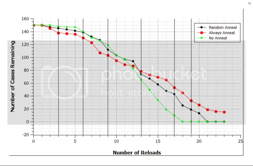

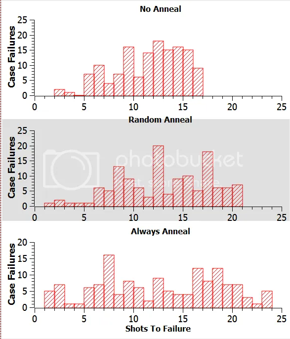

    Some folks did testing a few years back on ARFCOM and shared their work. In terms of defining brass life, you have to set goals for what it even means to you. For example, split necks and loose pockets, or some other parameter?
    Here are the summary graphs that dealt with the value of annealing in their context. They started with a fairly good population (150) of brass for each treatment, No Anneal, Always Anneal, Random Anneal, and tracked how many survived. Cases that could not be reloaded or were not found were considered lost. This represented a year of work. Photobucket went downhill and started watermarking all the photos and graphs, and has ruined many good web posts. A good part of his testing was done to examine the concept of using range pick-up brass.
    Their work forced me to look at annealing my Service Rifle and Prairie Dog brass differently. YMMV
    Here is a link if it helps plan your testing.
    https://www.ar15.com/forums/armory/-/42-422324/
    ETA: that represents 5977 shots, with 2027 for randomly annealing, 1858 for No Anneal, and 2092 for always anneal.
    The work was done in 2013 time frame.
