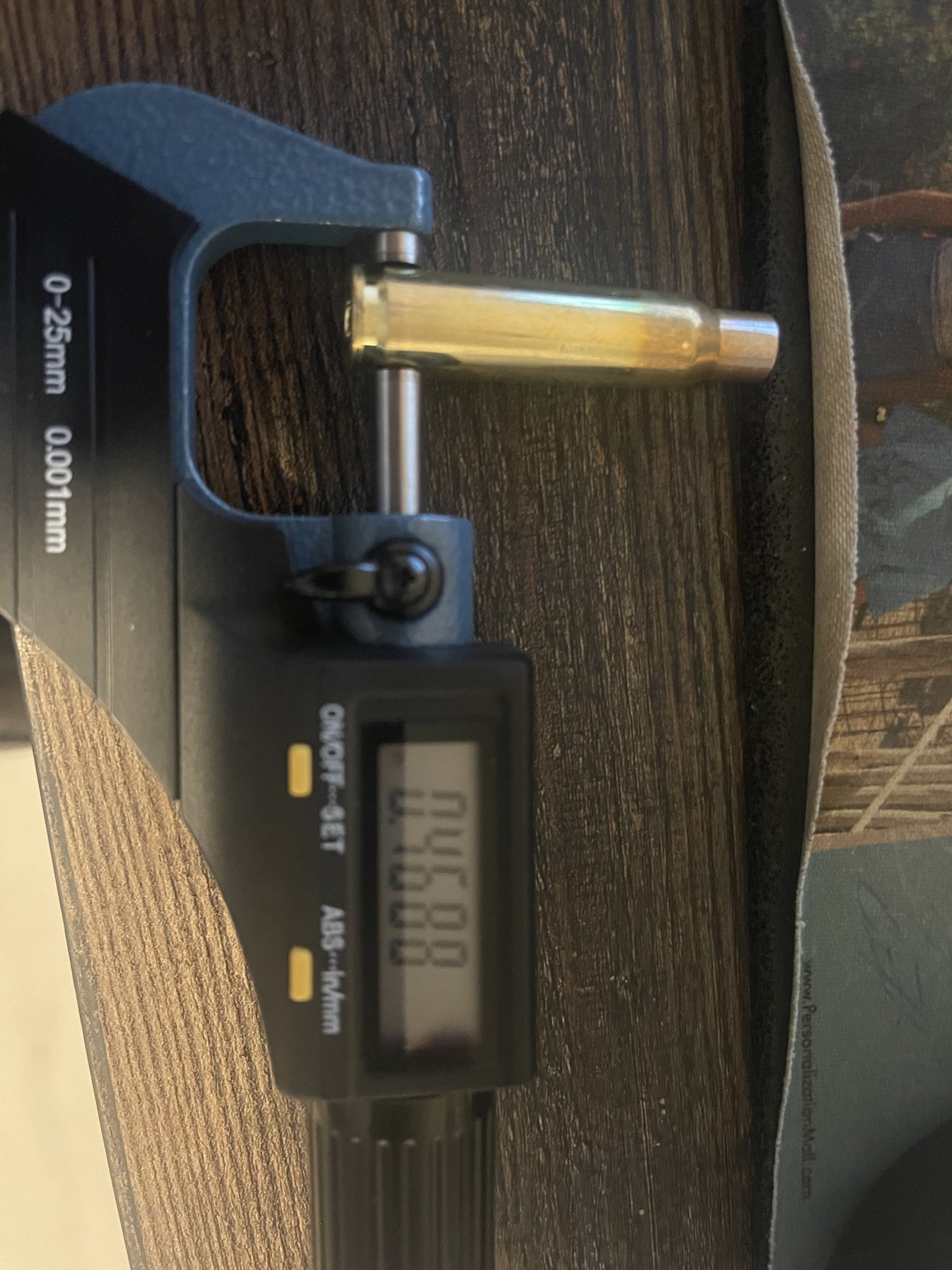

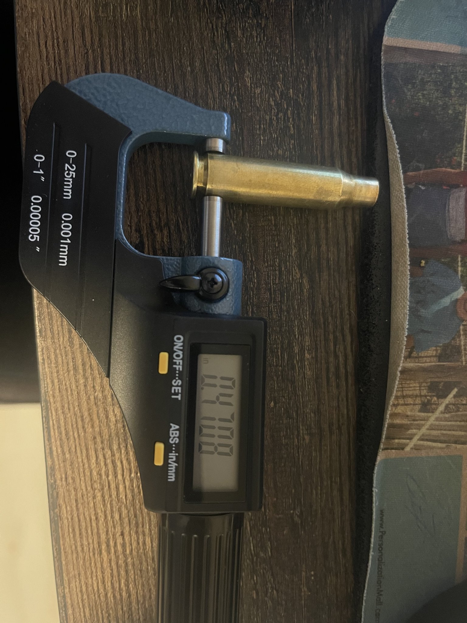

Here is a coupe of measurements compared to new brass and one that got stuck… looks like it’s .002 difference… also you asked if it was a savage??? Have you experienced this with savages? And what makes them specifically do this???

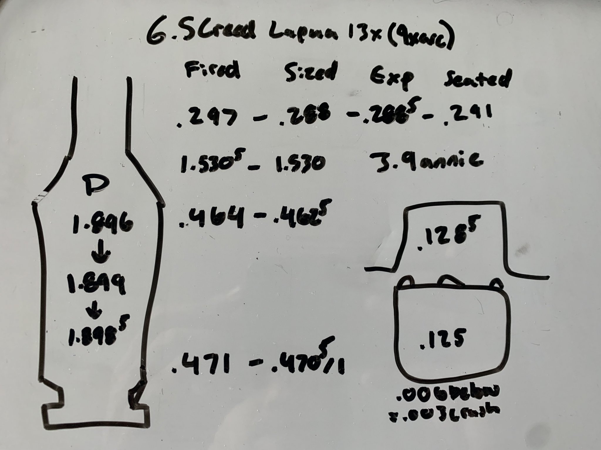

Just make it easy and provide the actual dimensions instead of a relative one. And for all of the dimensions, diameters of base, shoulder and neck, not just piece meal one at a time thats impossible to track after a couple posts asking for further clarification. And actually write them all down.
But if it really is taking it that much smaller I would be surprised if its sticking. Id still suspect that the sticky outliers arent taking that number.
