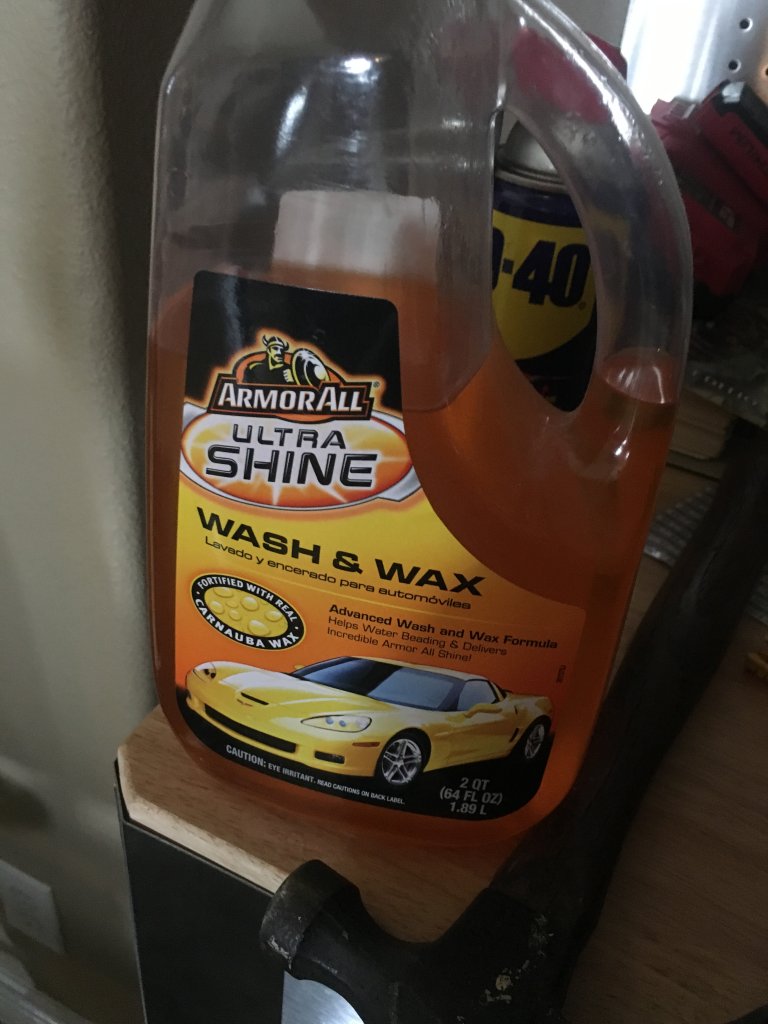

I use a little carnauba car wash in my ss F.A.R.T. I only tumble about 20 minutes on normal brass, 3 hours on nasty range brass. I use Redding dry neck lube in my long range rifle loads but not my short range stuff.

I tried the armorAll. Worked great. Seating much easier and length to ogive is much more consistent.

Brass too clean? No, I assure you your brass is not cleaner than when it was new and you didnt have any seating issues then did you? I stainless tumble but its the first step, then onto one shot lube and sized. Trimmed/debur etc...... if necessary, and I have found this to be very consistent for me. If you are noticing difference in seating pressure its not from the brass cleanliness but it is possible you may feel a difference from something else. I have used ultrasonic cleaners in the past and I will stay away from those but vibratory cleaners work well for me also. When I used to leave carbon in the neck it did act as a natural lubricant but the amount left behind wasnt easily kept consistent so thats when I switched to SS and just get them all "clean" to start. Annealing has also helped keep my seating a consistent "feel" over time. There are many ways that work and reasoning to go along with them, if armor all works for you then run with it.
