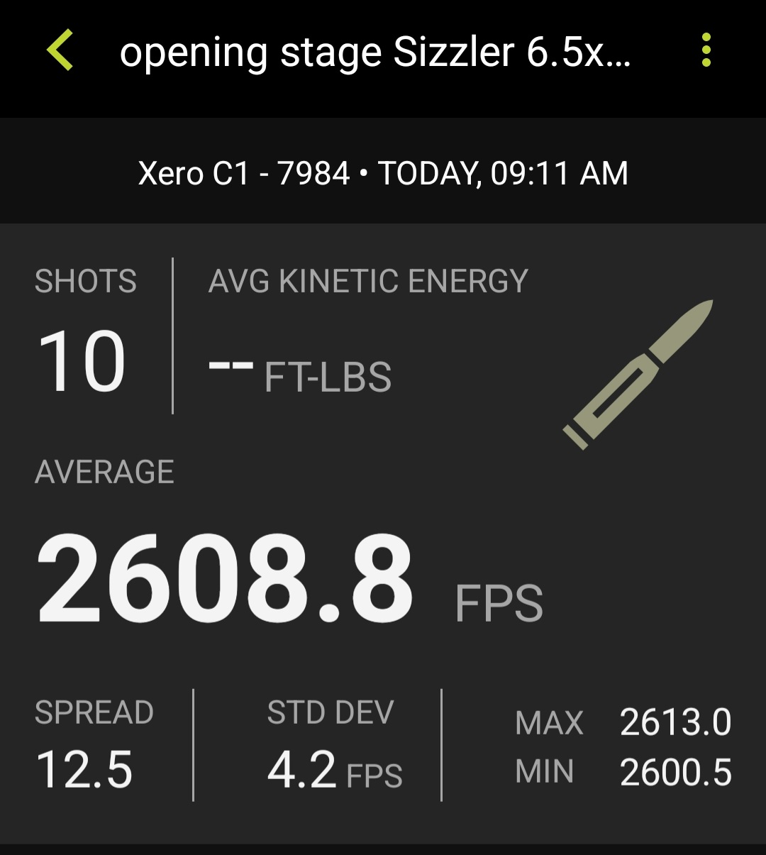

Peterson has been as consistent as Alpha in the loads I've used. Here is the first 10 through the rifle on day 1 stage 1 of the SAC Sizzler this past weekend.
