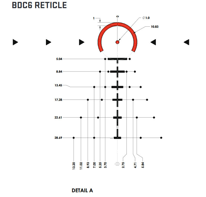

I have an Sig Bravo 5 mounted to my AR10.
My question is, let’s say I have it zeroed in at 50 yards, what are the BDC values for each of the reticle hashes?
Or if I zero it in at 100 yards, what reticle do I need to put it on to shoot a target at 200 yards? I can’t find a chart for this.
Haven't a clue, we'd need more information about what ammunition you're shooting to be able to give any kind of accurate answer, specifically what bullet and at what velocity.
Sig doesn't have good information out there but from what I can tell the 5.56/7.62 BDC reticle has the same subtensions as some of their others. The below is from the Tango MSR
Plug your data into JBM and you can compare trajectories but just running some basic numbers through JBM I'd say that it's designed to be zeroed at 100 yards.
