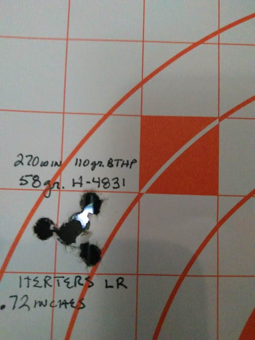

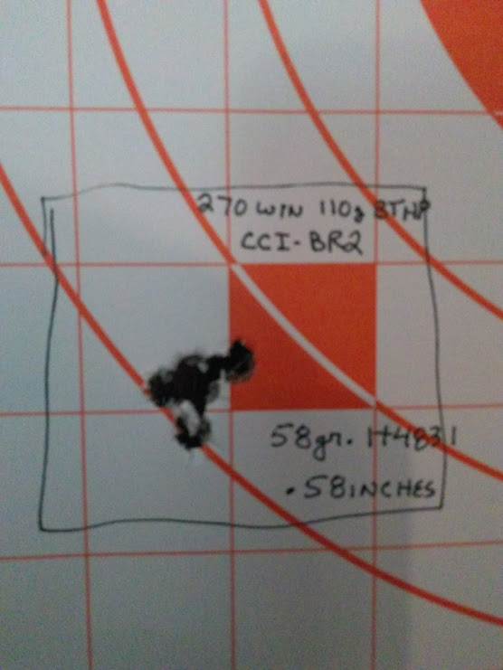

Thanks for the replies. Concentration seemed to be much better on my next trip at my 100 yd range and my first test load with some new bullets in .270 Win.

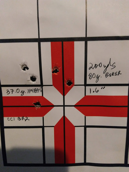

Playing with a bunch of new bullets in a 6mm Remington which has never shot as good as I liked. 80 gr. Berger shot better at 200 than it previously did at 100. Go figure.
Appreciate all the advice. The 6mm was stringing some loads horizontally that I don't think was wind related. I will be checking the stock before my next trip to the range to see if I have any weirdness going on there.
