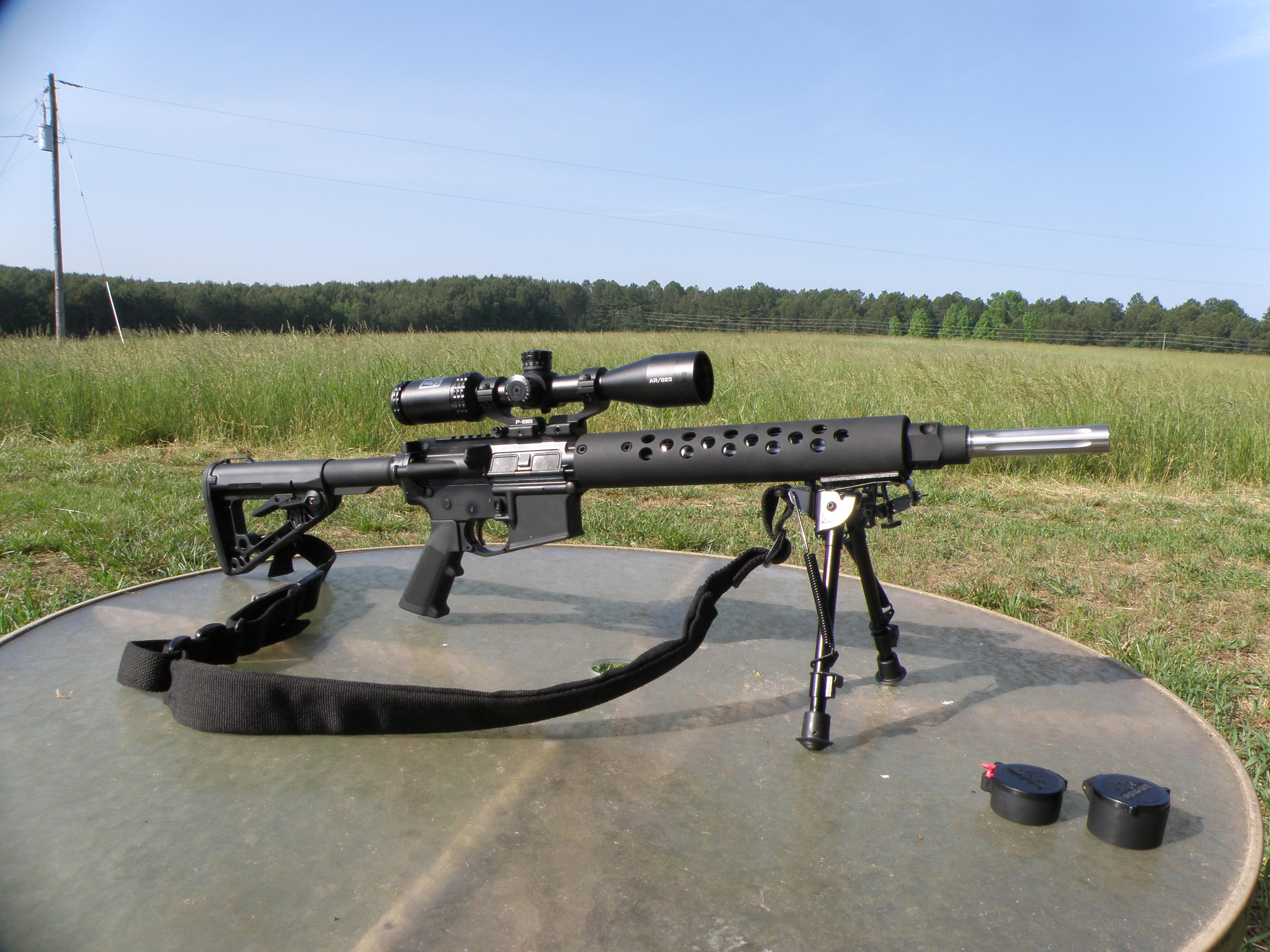

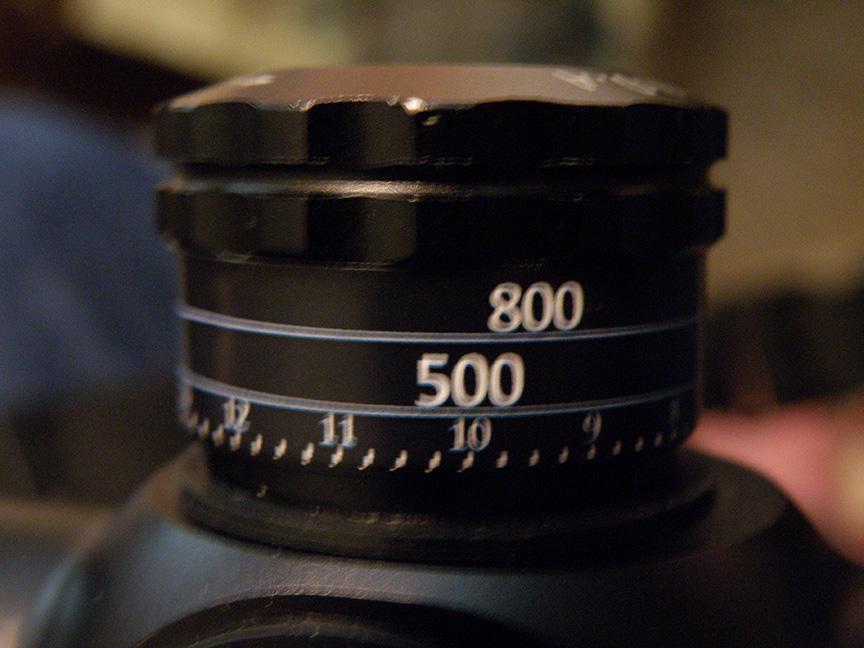

I'm going to have to compare the MK6 to my Bushnell AR/223 4.5-18x40mm scope. The Bushnell IMHO is clearer, sharper and has better contrast than my Leupold scope. I can easily see the .223 bullet holes on my targets at 100 yds. The clicks are very close to and as accurate as my Vortex 6-24 PST FFP MOA scope. The Parallax adjustment numbers are spot on for all ranges also. I also put a Custom Turret Label on the elevation turret also which gets me out to 900 yds. All I have to do is range the target then turn the turret to the distance on label hold for wind and shoot. No computing necessary.
