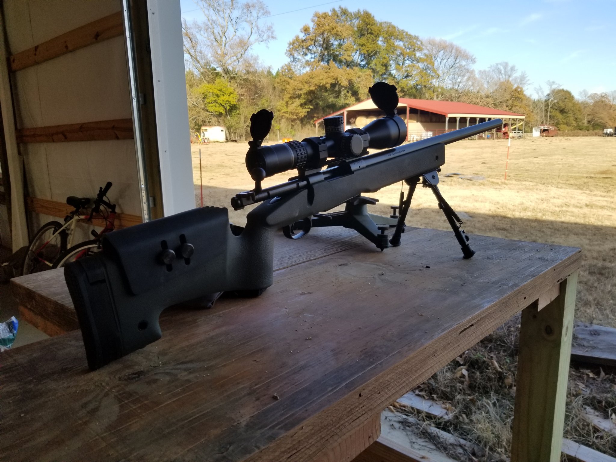

    I have a thing for these rifles. I've picked up several near new ones over the past few years for around $1K, and they have all been excellent to me.
    I found a NIB A2 model about two years ago for a whopping $1,300 and scooped it up. Put a 3-15 Burris XTR II on it and Krylon'd the stock green as this is as close to an M40A3 that I'll get.

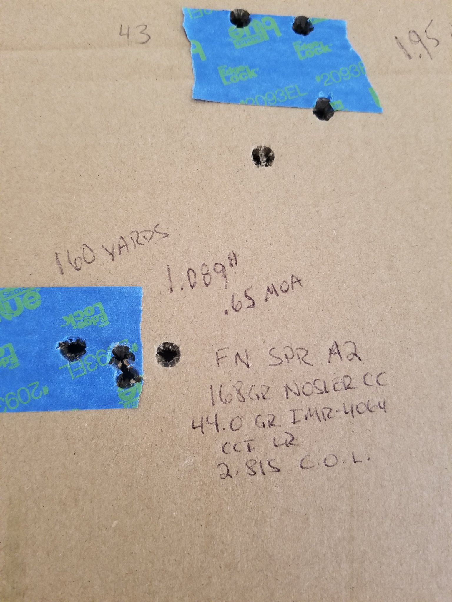

    I finally started load development today with some IMR-4064 and 168gr Nosler CC that I have a boatload of (both).
    There is definitely an accuracy node for this barrel as only a grain of powder less threw a wild string. It was so bad that the 5th shot for that load isn't in the photo.
    44.0gr though gave me this. **My range is 160 yards** this is from my shop to a pond berm. I have to walk to my driveway to reach out past that.
    There is definitely more in this gun with some experimentation with other powders. I have a ton of Varget and RE15 too.
    Round total on this rifle is exactly 50 now.

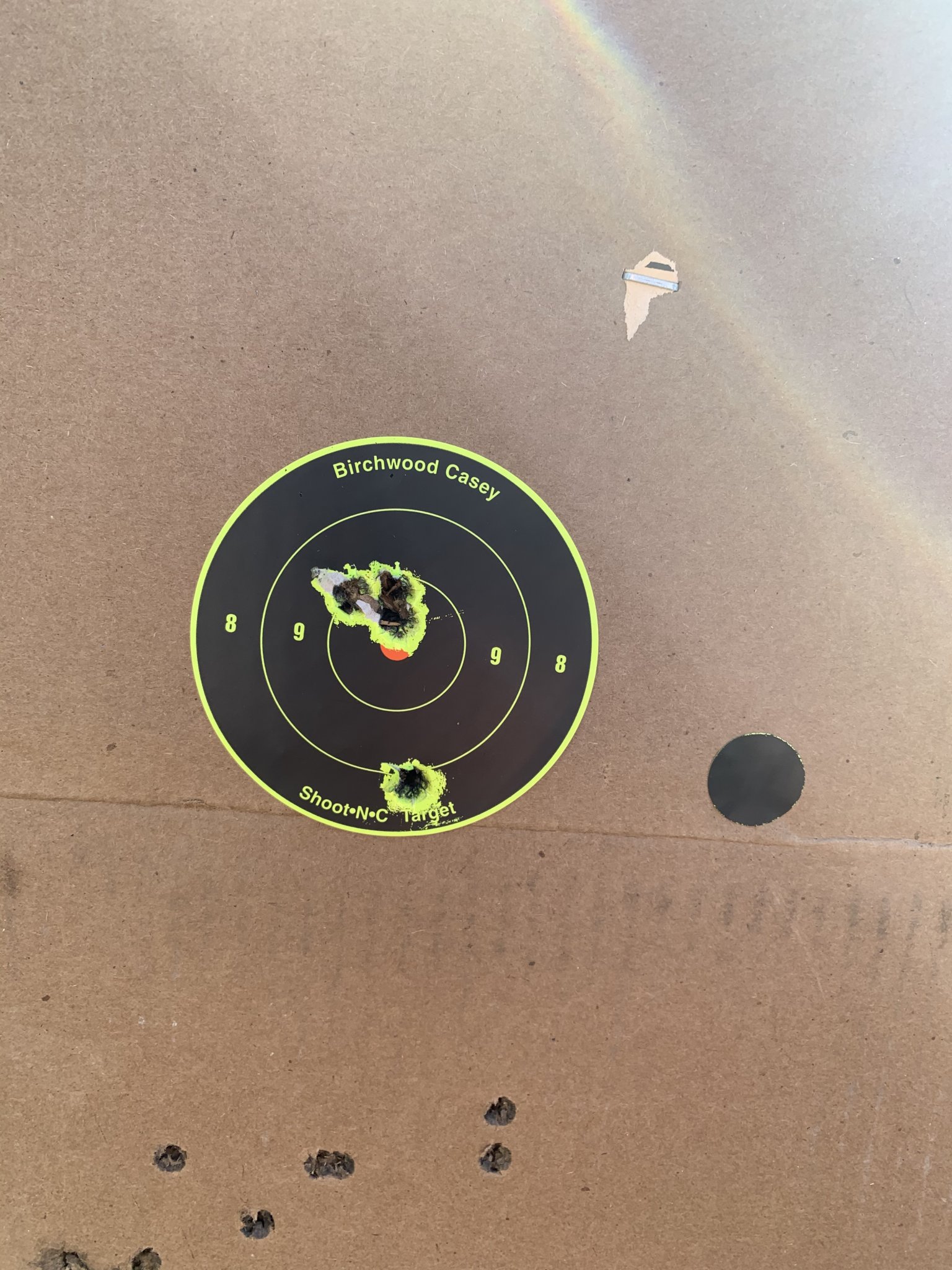

    Finally got a chance to take out my Fn spr a1. Man this think is a tack driver.
    I haven’t reloaded for it yet but it really likes 168 fgmm. Bottom one is a sighter, then a 3 shot group. Next need to chrono and do a 5 shot group.
