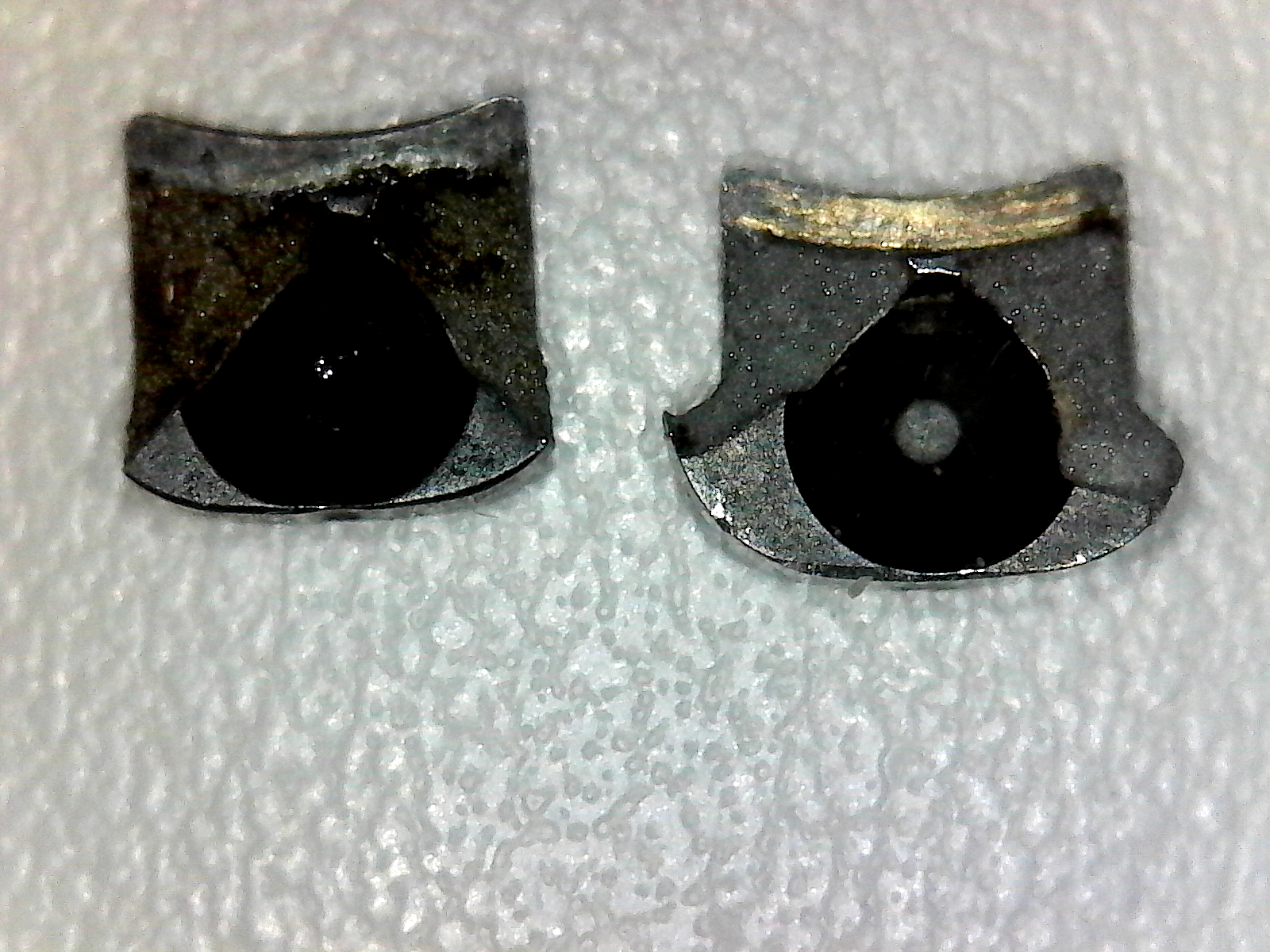

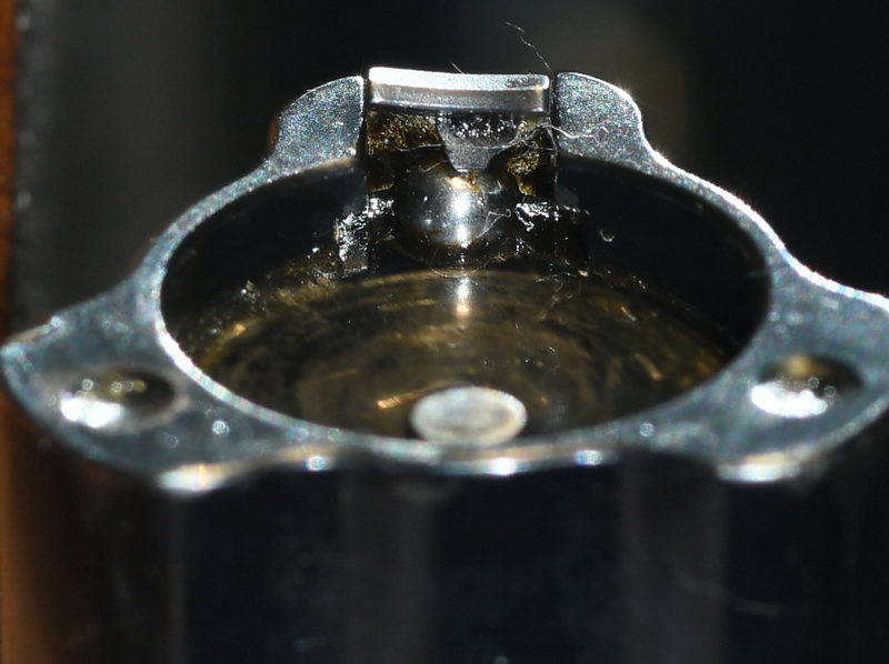

Last month I started neck sizing using the listed load. No issues until the 10th round, failed to extract. Extractions appear to require higher force when compared to full length sizing. When I got home I noticed the extractor (small MIM small part) was chipped. Called Ruger and they sent me a new extractor.
Yesterday using 93 Gr after ~20 rounds, I broke the replacement.

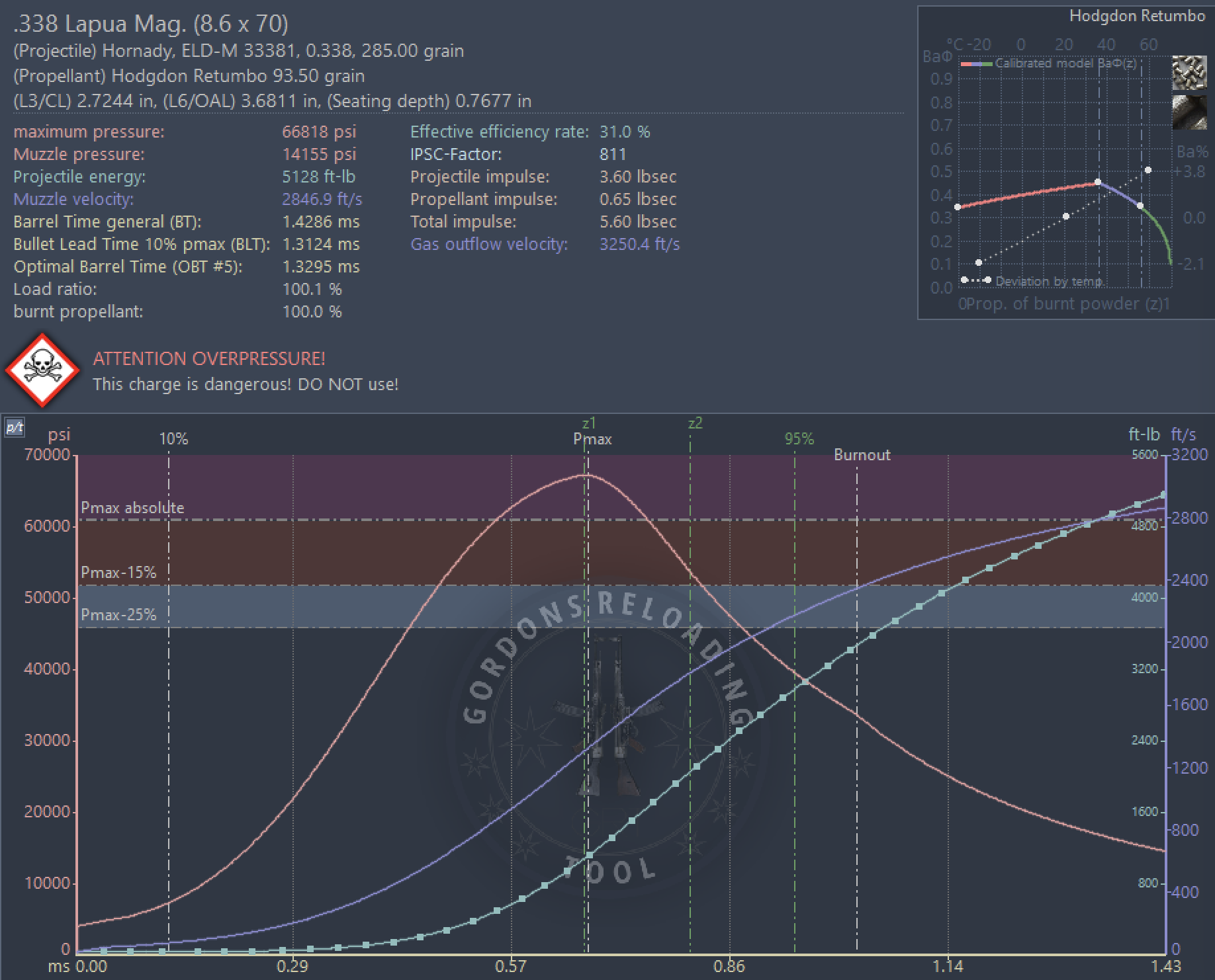

Hodgdon says 89.0 with a 275 grain bullet in Norma brass. I would think your bolt would be stiff after neck sizing only with a stout load like yours. That and , possibly, the extra amount of pressure is causing the extractor failure.
Have you ever seen pics of a catastrophic failure with a 338LM? It really does make a mess of (in the last case I saw) bench, shed roof, shooter's face, and undies.

I will contact Ruger and request a new extractor and will stop necksizing for the 338,. I am still not convinced that MIM for a highly stressed component is a good idea. The extractor on the 338 RPR is small with sharp corners (stress risers)

For a magnum case running some pressure you’re absolutely right.
And I’m guessing that’s some up there pressure and tight cases help things get spooky REAL fast.
