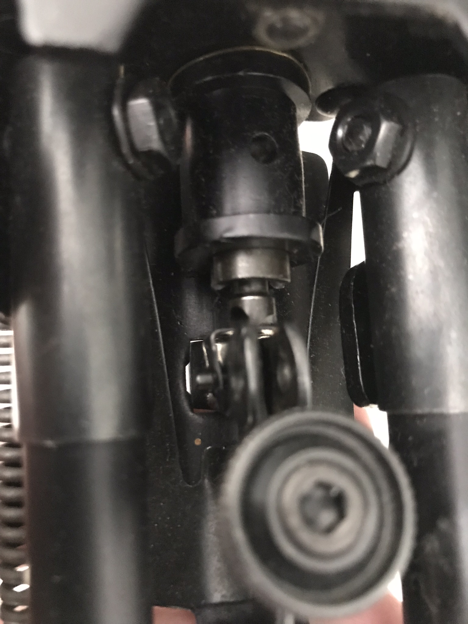

I busted up my Harris B-SRM with a PodLoc. It seems to have overtightened and destroyed the internals of the locking mechanism for the tilt. Has anyone else done this? Is there any solution-will Harris warranty it?

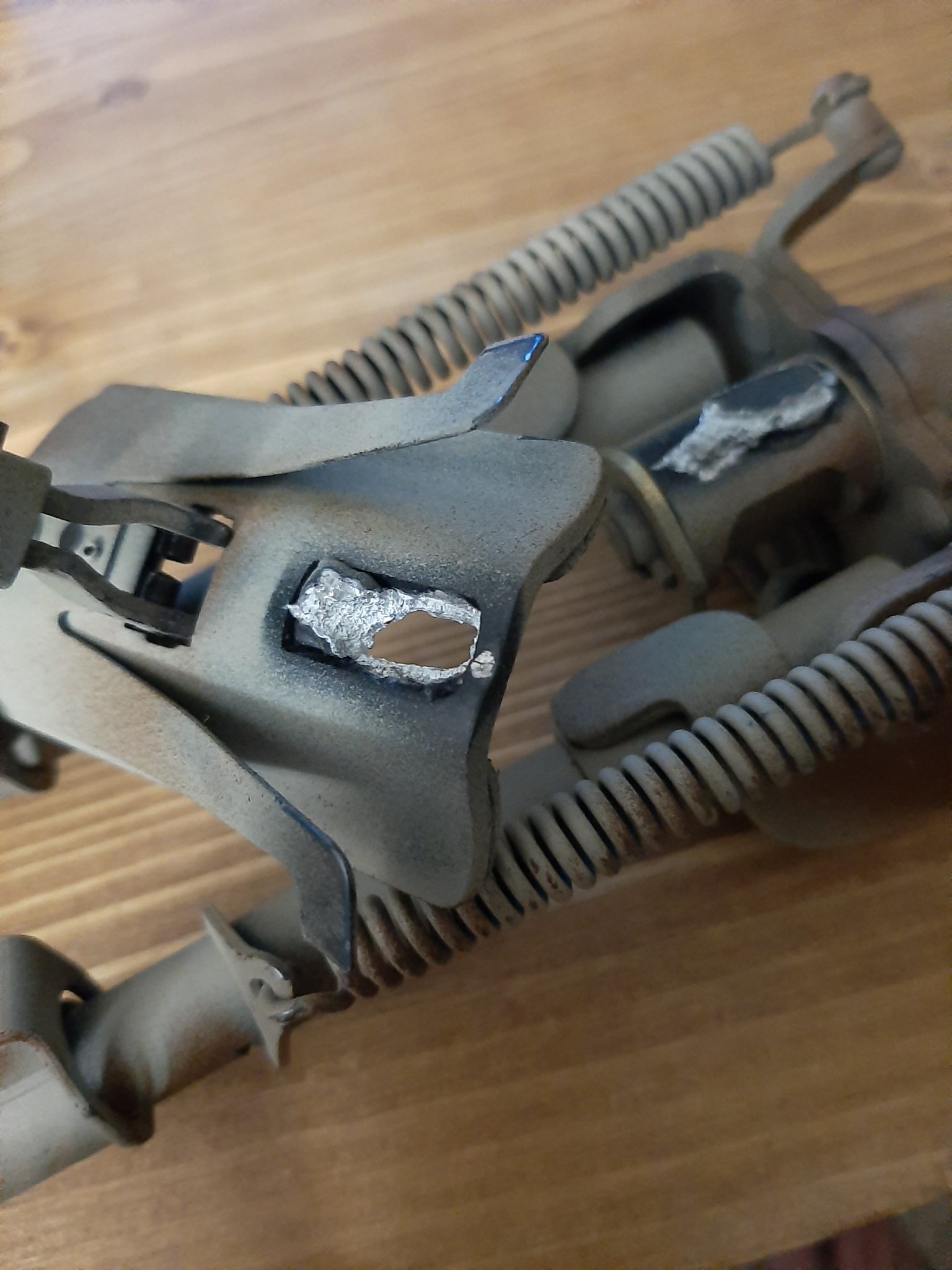

My Harris bipod broke the other day while shooting in the AK PR1 class. Thankfully Mark had a spare that I borrowed for the remainder. Do you have contact info for their CS? I upgraded the feet and switched to a PodLoc. It failed at the weld between the mounting surface and the barrel portion of the swivel. I’ll post pics tomorrow.

Looks like you just snapped or lost that pin and the brass plate that goes under it?

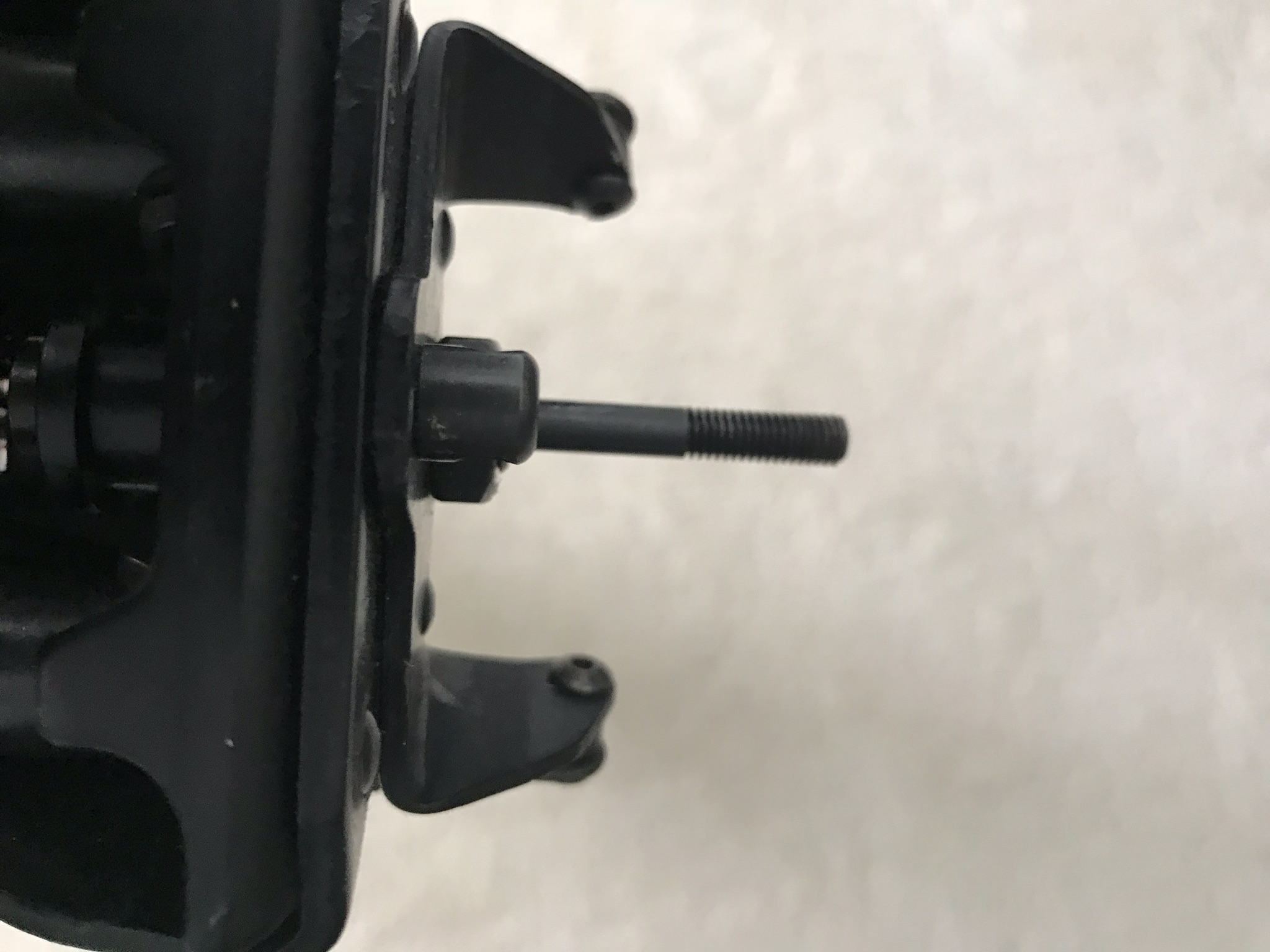

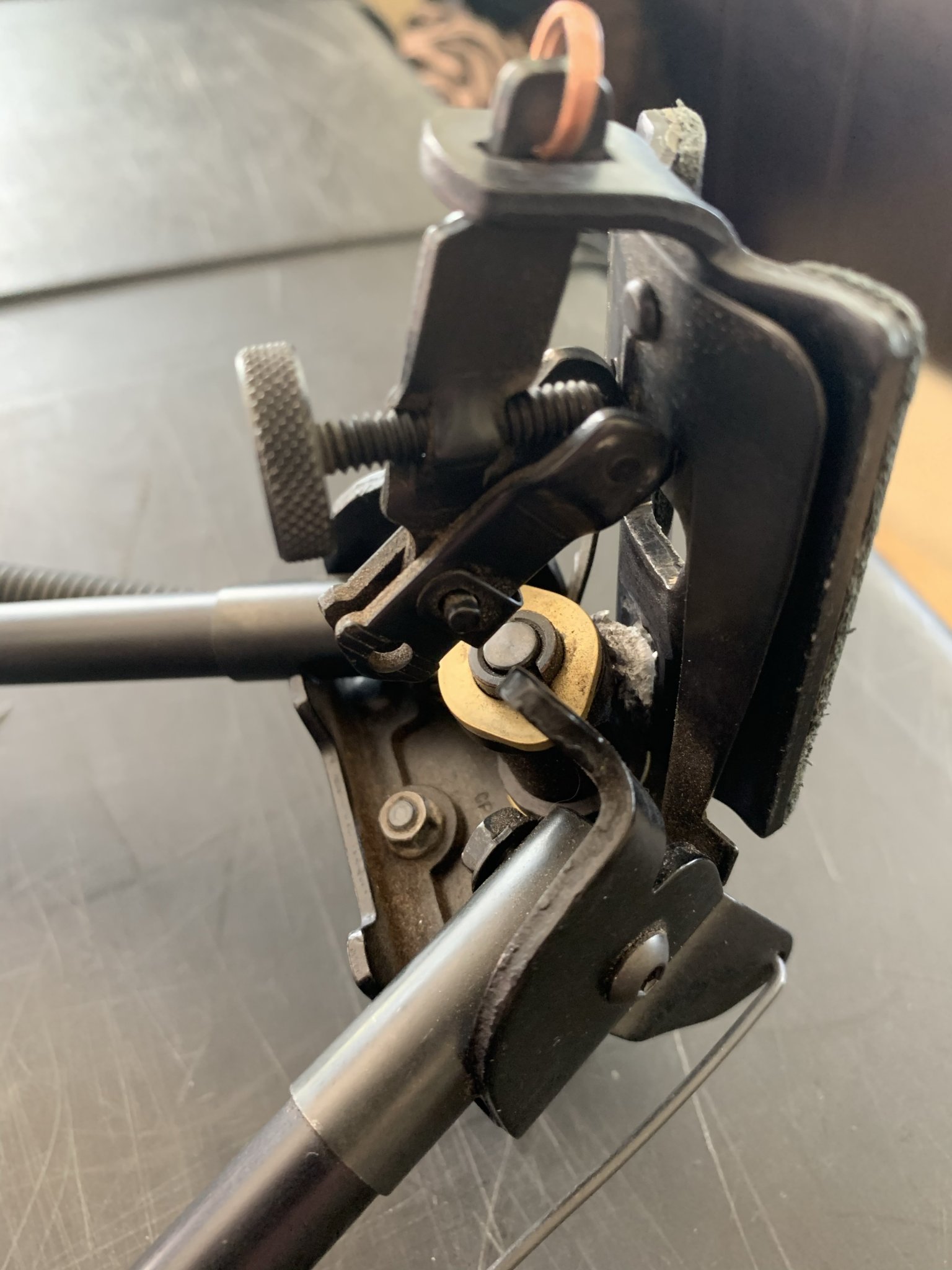

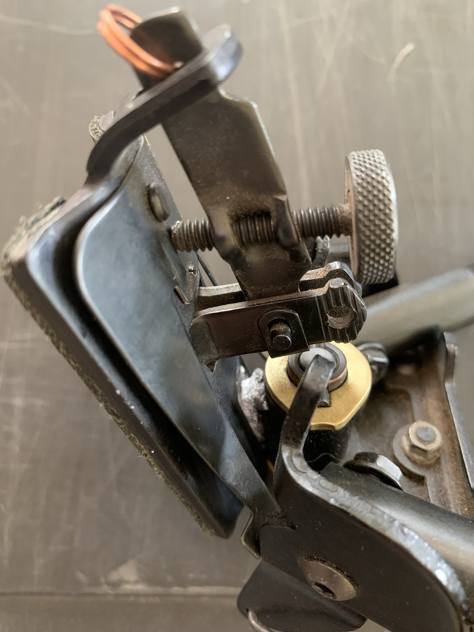

Here are the pics. Thanks for the contact info. I’ll update with my experience.

Fun Fact regarding the threaded rod holding the Harris pivot body together....
When Harris introduced the first "S" series with the tilt feature (Late 1990s) more of these threaded rods were getting snapped than before the introduction of the Pod-Loc kits.
Want to venture a reason for this? :)

People like me tightening them wth vice grips?
Really close!
All the early MIL and LE adopters were grabbing the little knurled factory knob with Leathermans, Gerber Tools, etc. and wrenching the hell out of them.
The idea of the Pod-Loc came about when competing against a couple of USMC Scout teams at the 1999 North American Sniper Championships and starting a conversation with them (turned into a lifetime friendship with a couple of them). Within a few months I had some prototypes sent to Precision Ground Weapons at Quantico. They sent some to the west coast and kept some there for T&E. Within the next 6 months there were fast tracking the cataloging and documentation to get an NSN assigned to it for inclusion in the new M40A3 program.
Within 2 years of the Pod-Loc launch, Harris was already seeing a reduction in the broken pivot rods. Go figure.
Email sent Thursday
Reply received Friday
Part shipped to me today
They offered to fix it there with me paying shipping to them and they pay return shipping. I opted for them to just send me the part and they paid for the shipping.
Bottom line, great Customer Service.
