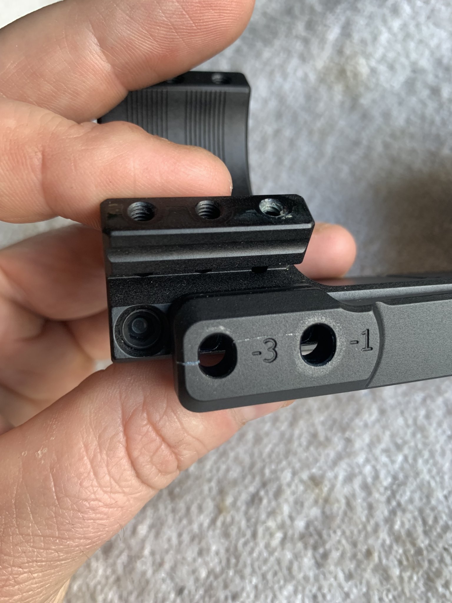

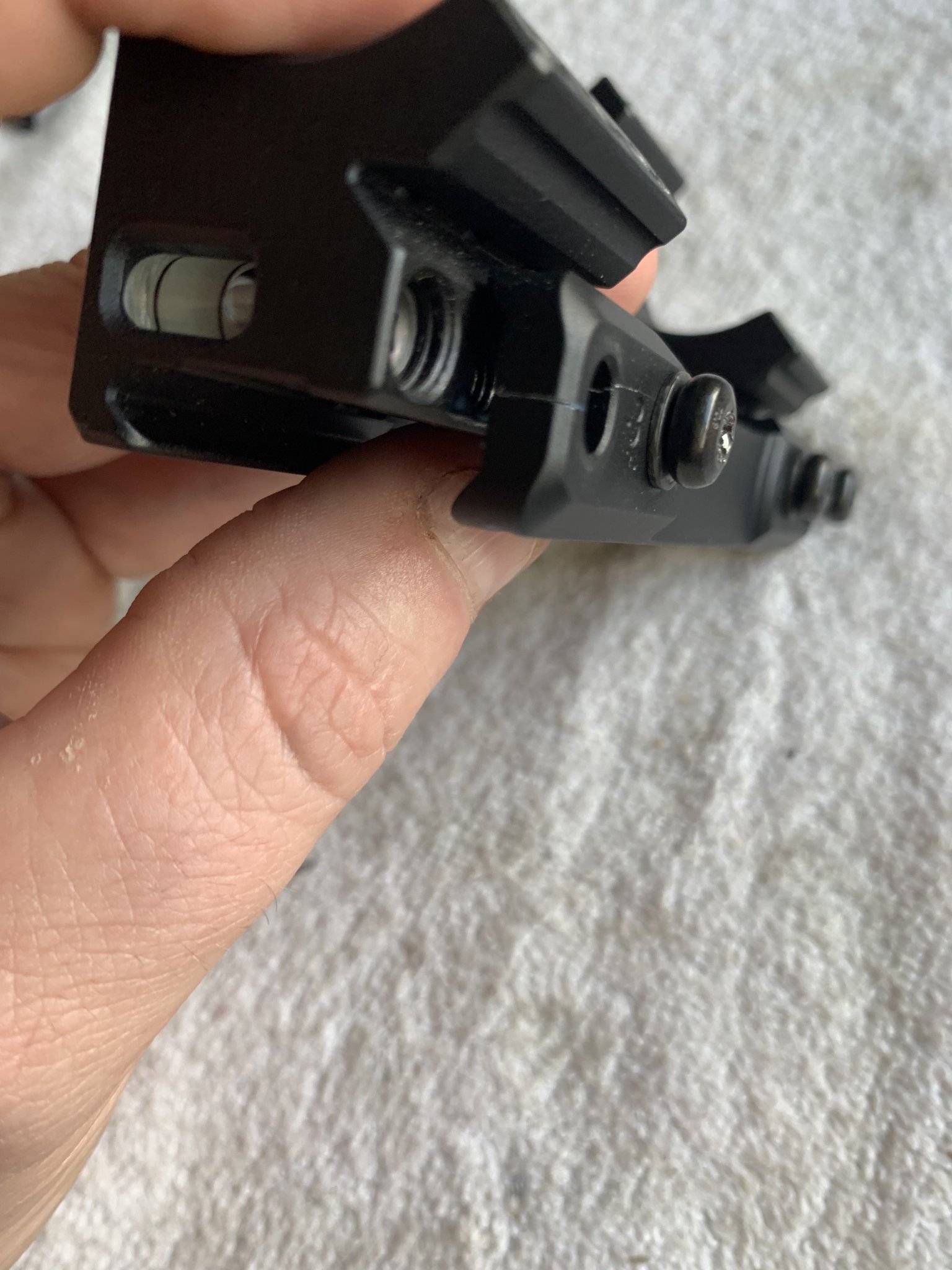

    Well, it finally happened to me. Mounting a different scope on my AI, and cracked the mounting bar...........from what I have read, this has been a problem for a while. I've got an email out to Mile High...........so we'll see how that works out.........
    Who is making a good mount now..........looking for suggestions ............Thanks in advance for any help.

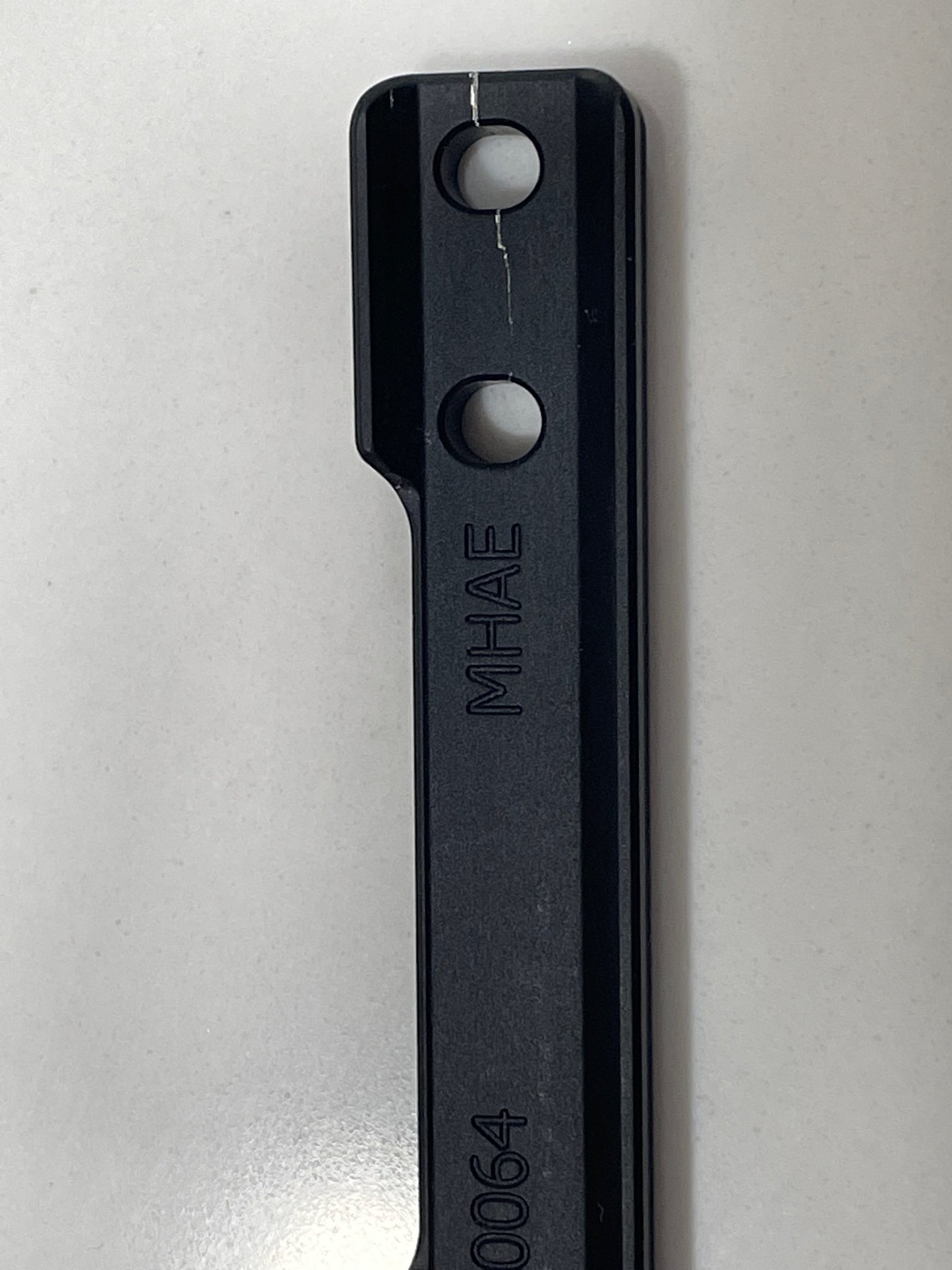

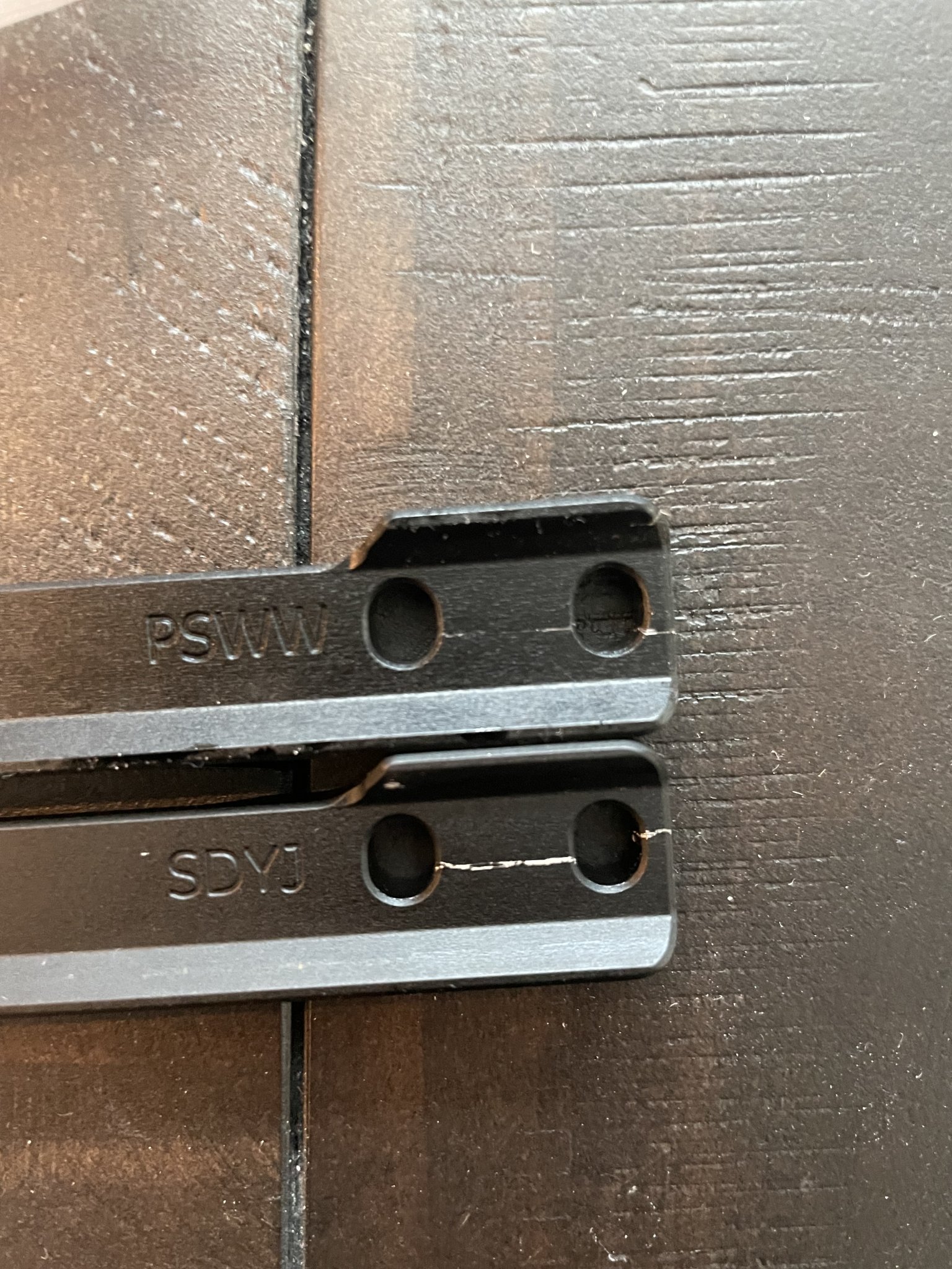

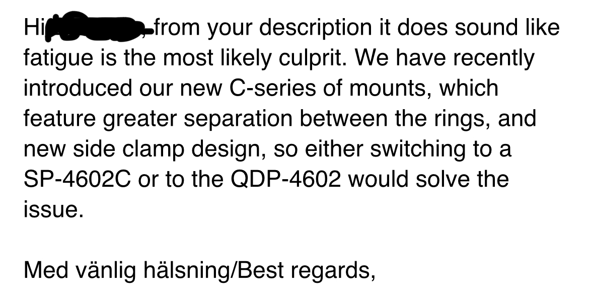

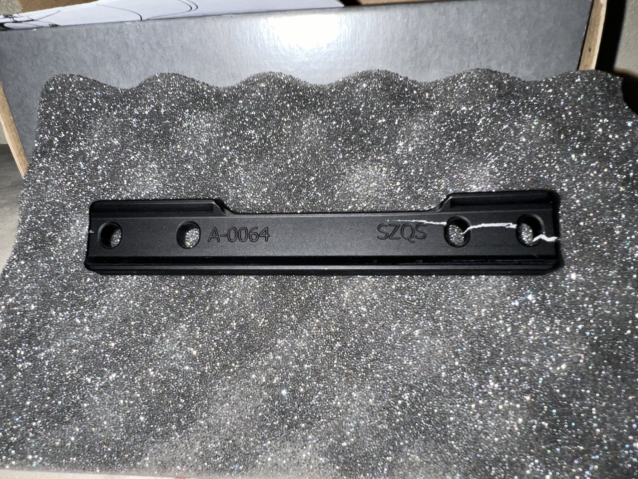

    MH will take care of you. It certainly doesn’t build any confidence. I also cracked a bar as well. Well under torque spec when it cracked. Mine was the updated thicker bar as well

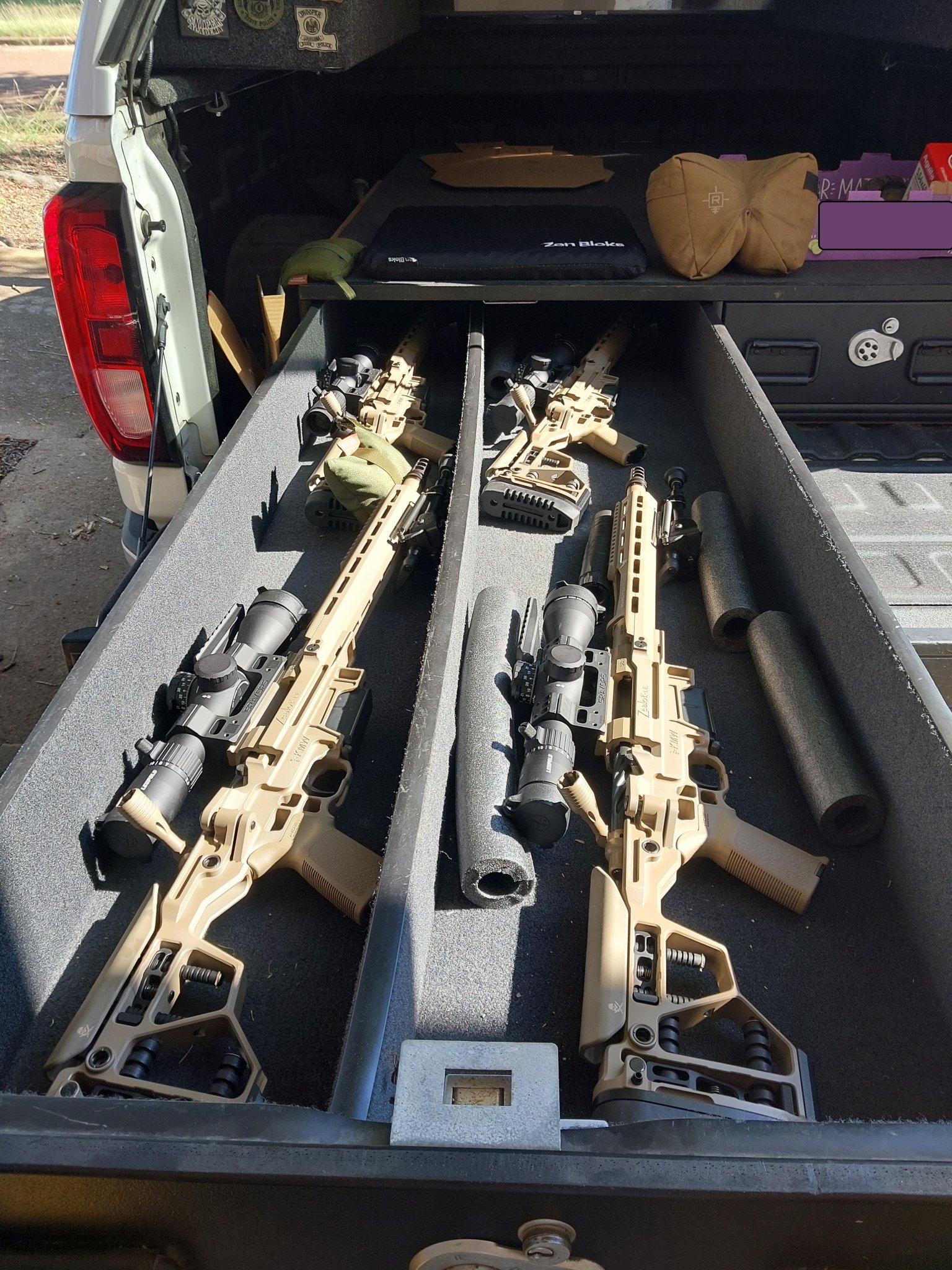

    Can I just say I love you have a pull out drawer in the truck with not 1 but 4 bolt guns lol... I need to pick up one of those chassis....

    Do you have a picture of the broken bar? Not trying to seek proof, just want to see the stress point
    This is where mine broke.
    SPUHR needs to make the clamping bar out of steel IMO.
    Edit: I wanted to add I used a Seekonk torque wrench set at precisely 45" pounds, followed the numbered sequence on the screws never saw recoil above a 308 on a bolt action.
    I used to think SPUHR was second to none for one piece mounts now for one piece mounts I use ADM.
    Same for mine. Was a wheeler FAT wrench. Wasn’t even up to 45 inch lbs yet when mine went
    Reactions: Steel+Killer
    Check out Griffin Armament SPRM (lol) or the newly named GRM.
    I just bought one because I needed a spuhr-like mount, but no way I would pay spuhr prices. Got the GRM for under $200 and, at least preliminarily, I can't see how a Spuhr would be better.
    I ordered one of these when I couldn't find anything else in stock. I also own a Spuhr, so I'm not just cheaping out. These things are built like tanks. I liked the first one so much that I now own another.
    Reactions: Namekagon
    Damn disappointing. I finally bought a Spuhr after years of wanting one. I really like the visibility of the turrets. Seeing this crap is disheartening for the kind of money they cost. Also the level is not correct. Why bother if you are not going to do it right.
    I’ve had it happen three times. I switch to 40 in-lbs (Fix-it sticks). One time it happened back to back and Spuhr basically told me to buy a new scope mount (as in new model).
    Here's mine..........looks like they are all breaking on the same end.........I was also using a Fat wrench going from 35 to 45.................
    I'm sure there's lots of these in service not cracking, but it's pretty amazing considering while I'm sure it's happened, I've never really heard of other mounts failing like this, and we're STILL hearing about Sphur's failing in this manner and for awhile it was reported quite frequently. It does seem like a steel cross bar would likely solve this. The mounts are already heavy and be putting on 20lb rigs, pretty sure no one would notice another once or two if it kept them from failing.
    I love that Sphur's response was to buy their new updated mount, reminds me recently when Beretta USA acknowledged the fact that Sako s20's had a defective run of mags, and they had updated mags in stock. However, they would not replace them under warranty, but instead offered me a 10% coupon to replace mine at full MSRP in their store at my cost.
    I bought a couple some time back because they were direct mount on my AI-AT and TRG, but I would not buy another mount from them today. Too many other great options that you never hear about failing at lower cost.
    Don’t buy that junk
    NF or ZCO make quality mounts.
    Don’t buy that junk
