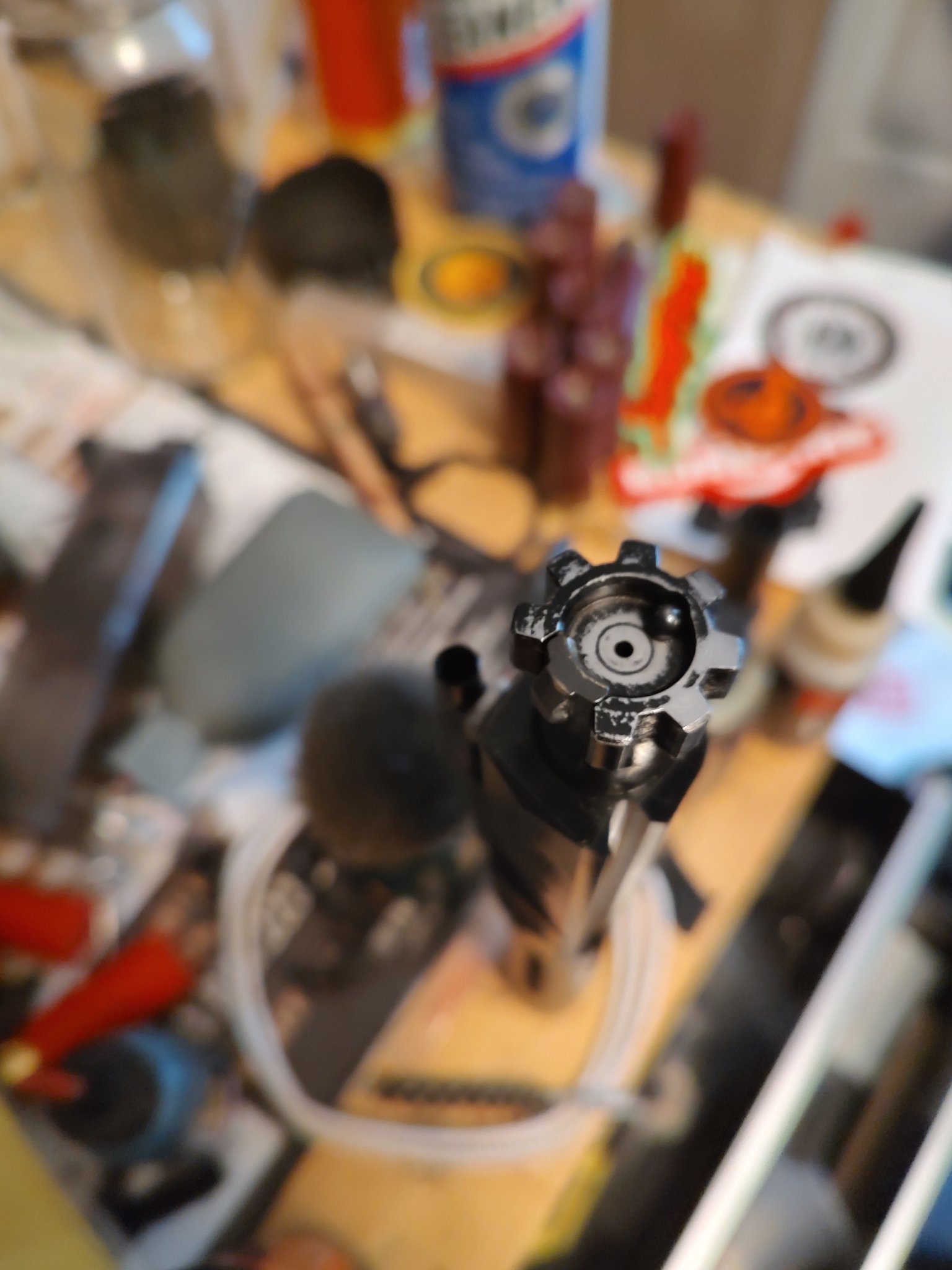

I have used the Brownells Ti 308 bolt carrier, no issues, with adjustable gas block.
I went light weight... with carbon fiber handguard, magnesium upper, titanium muzzle brake fluted SS 16" barrel, for a 6 lb 3 oz AR 10.
With a variety of handloads 155, to 208 eldm.
Even single loaded the 225 eldm...hot loads turn down the gas, but normal 155 to 179 SMK loads all run the same setting. So far it's handled every max load, without issue. Haven't used the JP product at all....but it's your dime, as they say.

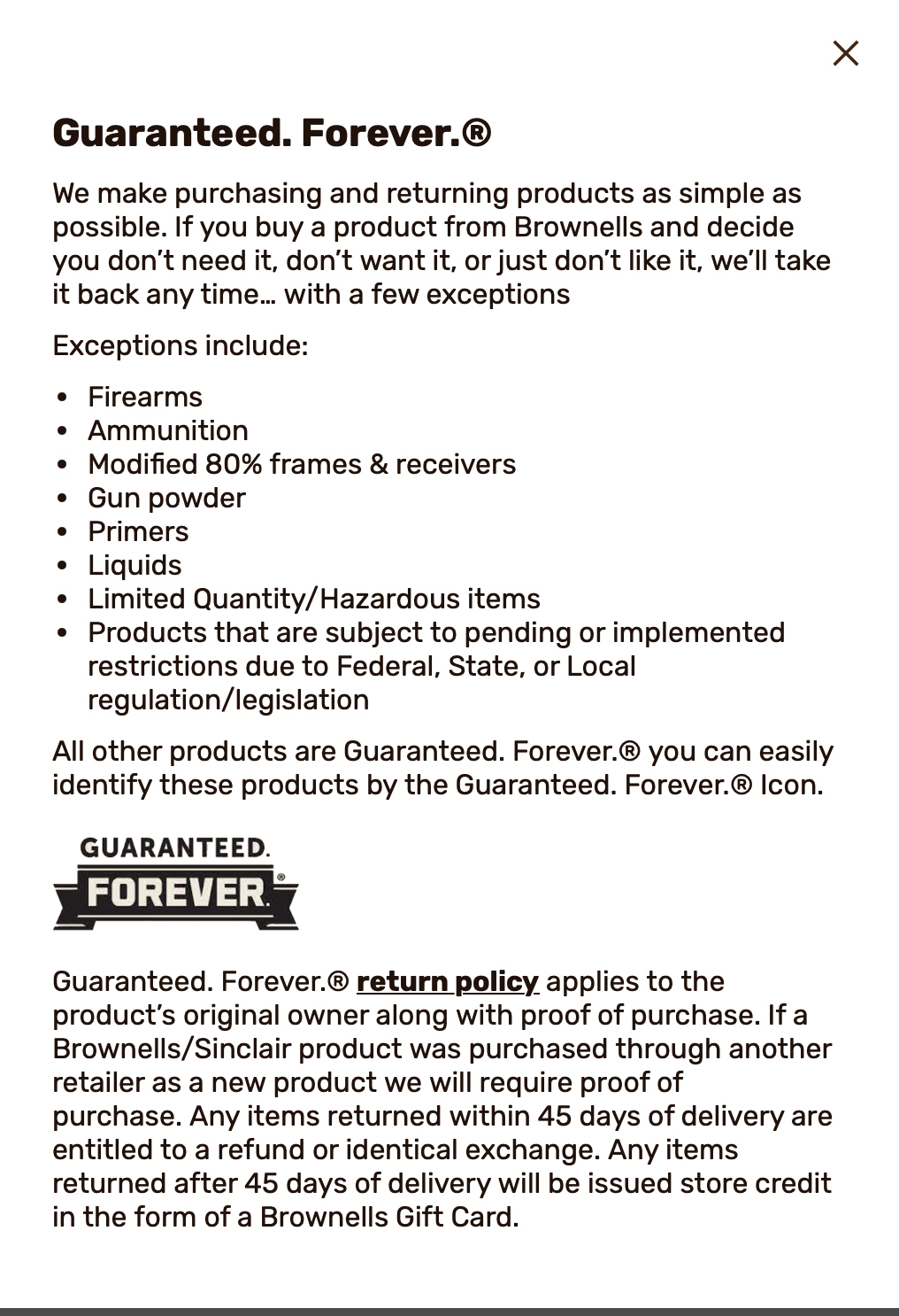

I just read Brownells "Guaranteed Forever" warranty, which allows me to return it at any point....and get credit for it. I may go ahead and grab the Brownells and just return if if I end up needing a HP bolt.
Reactions: 45-90
I actually used that guarantee once, when a major manufacturer tried to delay the return, to run out their 30 day return policy. I ordered their part through Brownells, and Brownells said sure return it...I did for a free replacement.

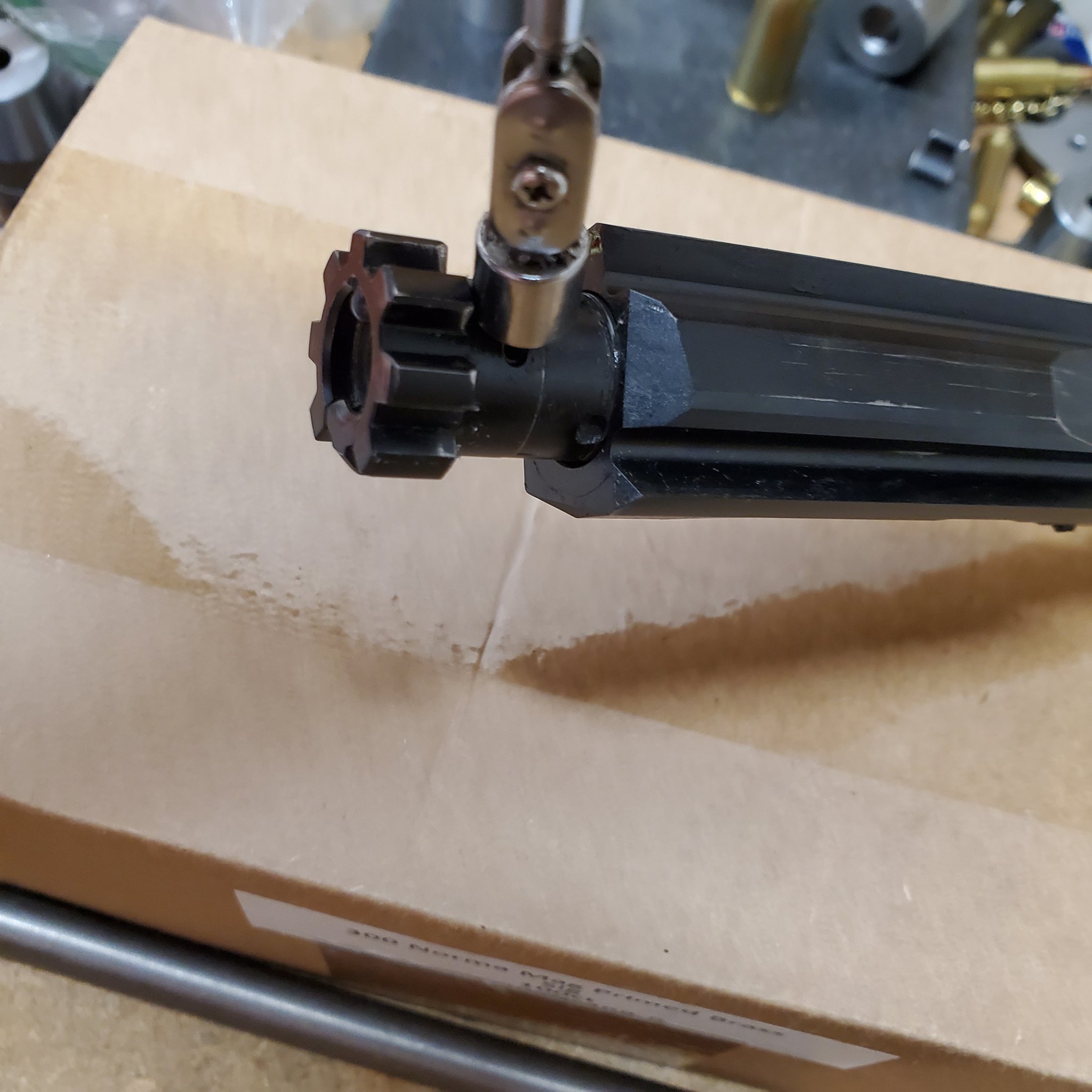

FYI also my coating is more matte gray - yours looks shinier black, at least in the pic - unsure if they changed it at some point. Think I bought mine in late '22. If it's good Ti, can't see why we'd need a coating at all. Since lifetime warranty, maybe run it some more and see how it evolves?
The bolts are steel, just the usual stuff.
The carrier is titanium.
Mine has close to a thousand rds, with nothing unusual.
It can be replaced with any bolt of your choosing, they are pretty much all identical made out if the same 2 steels from the same few factories, with the same heat treat and inspection. On CNC machines.
I'd just run it, it's working, the coating will wear. It's the steel bolt doing the job, not the coating. Just keep it lubed.
The titanium is great... but the aluminum carriers will wear once the anodized finish is worn off the carrier, the bolt is still steel.
