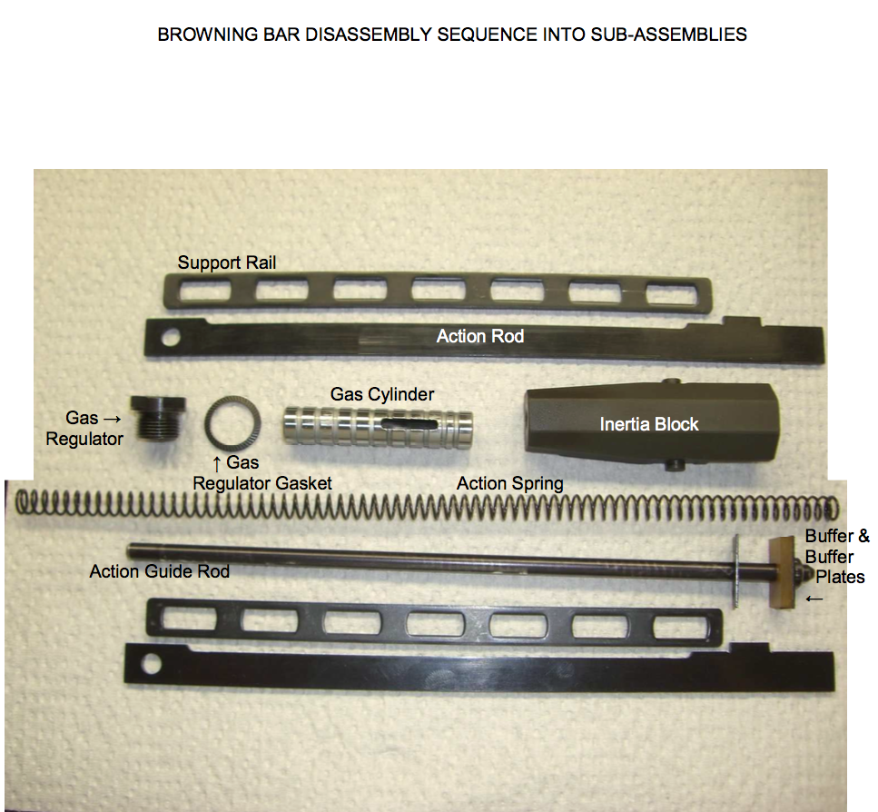

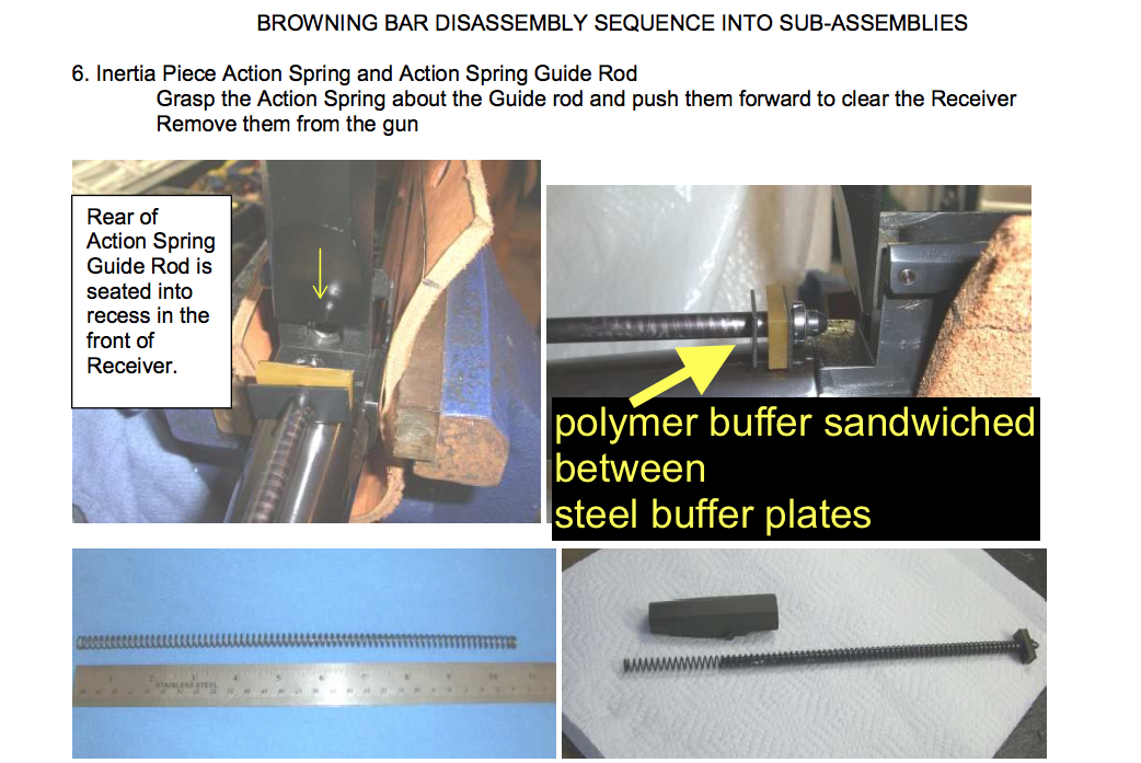

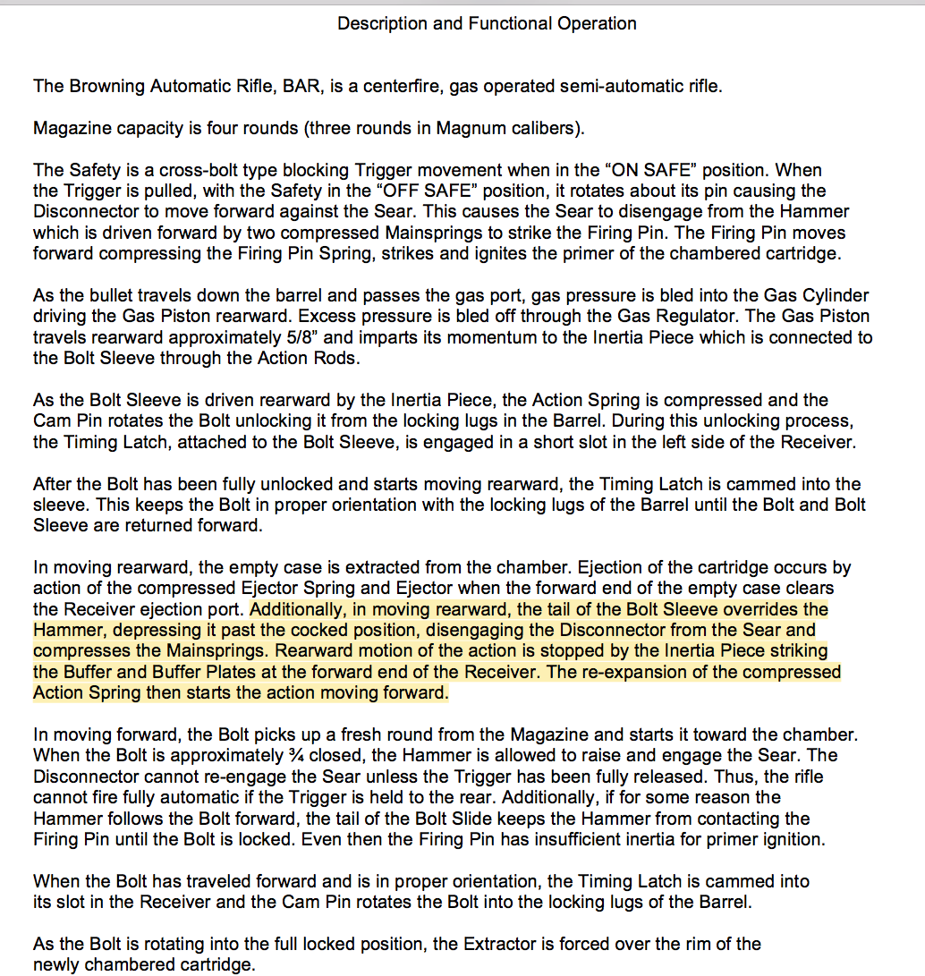

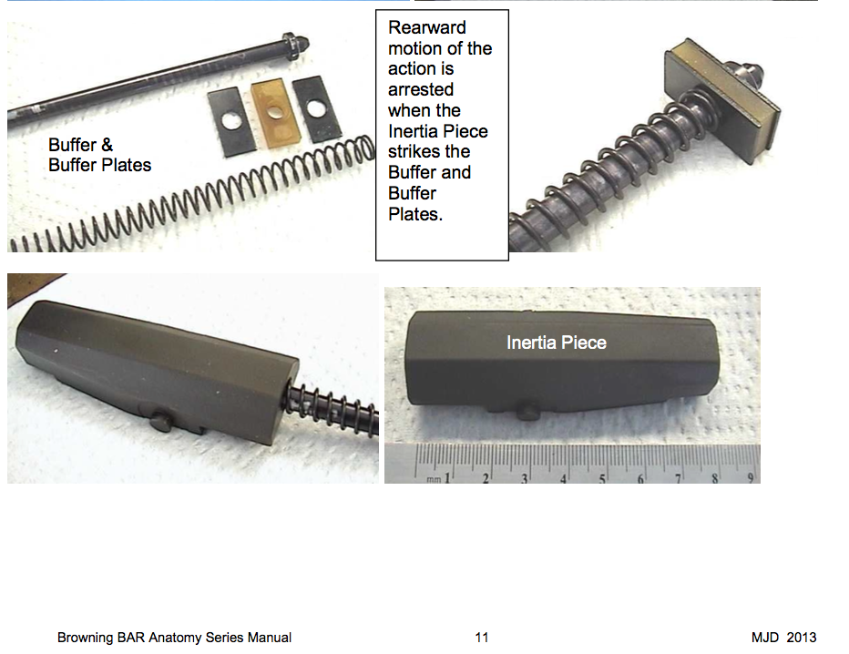

Cease & desist shooting it! With the polymer buffer crumbled / crumbling its effectiveness to prevent the inertia block from beating the parts to
death, is zero. Simple disassembly and replacement. Carry on. I authored a technical Manual for the Browning BAR rifle many years ago.
