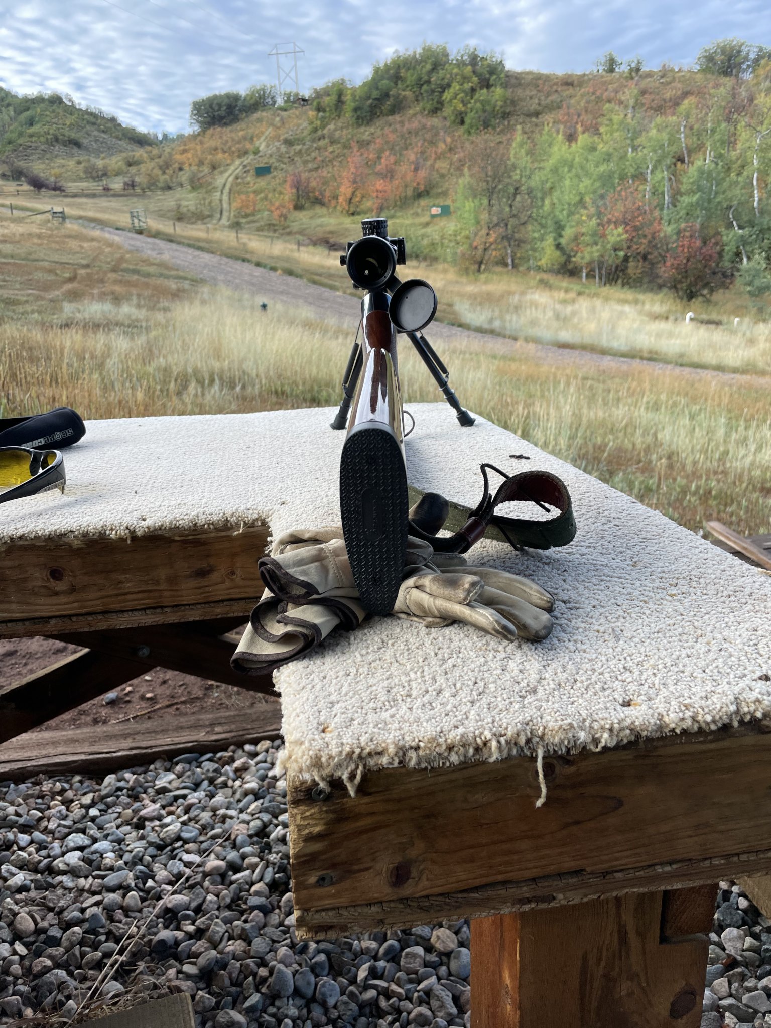

I have a browning BAR 30-06 that has shot well enough for years-as it’s been a 100 yard deer rifle. Took it on a hunt and it jammed up, got it cleaned and functions fine now but I am having vertical groupings 5-6” apart vertically but groupings are fine horizontally. Changed ammo and problem replicated.
Any idea what this is? I checked the scope and everything is tight. Never been an issue prior. Scope is a Leupold vx-3i.
Pictures attached.

Man, that really looks like a scope or mount issue. Did you pull it all off and put it back with loctite? I'd go through that first. If you already did all of that, check your bolt face for damage maybe? Maybe when you "jammed it up", you somehow damaged the bolt face or the chamber itself.
When it jammed up, was it dirty enough that maybe you've developed a carbon ring? That Could make a mess of your groups, but it does seem that you have consistent vertical stringing. If I had to guess though, scope, rings or bases.
