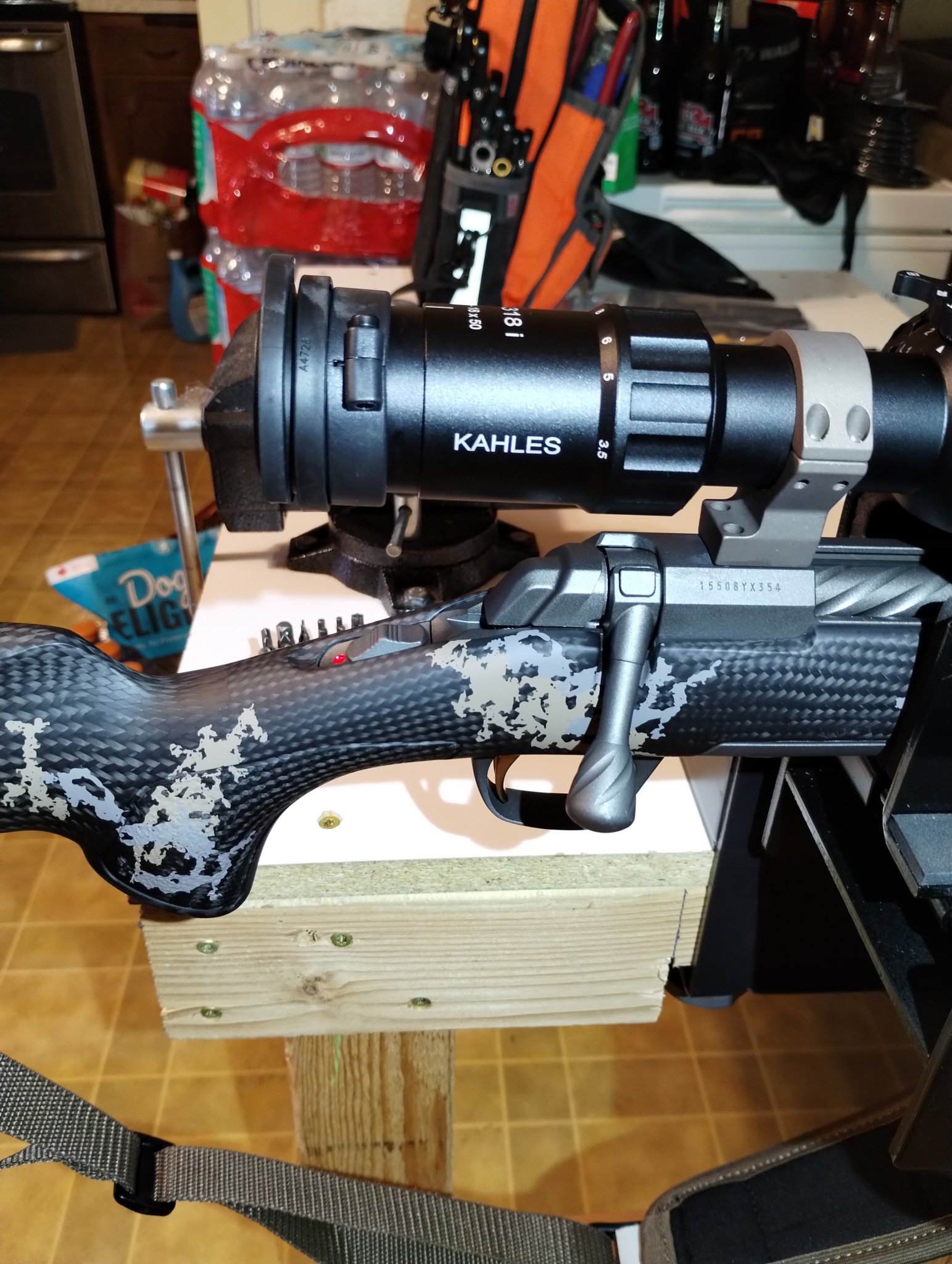

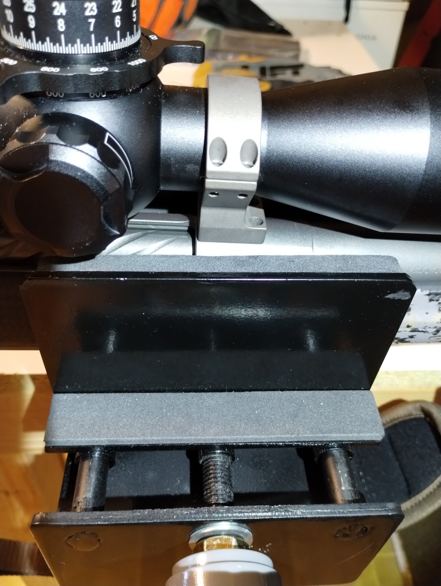

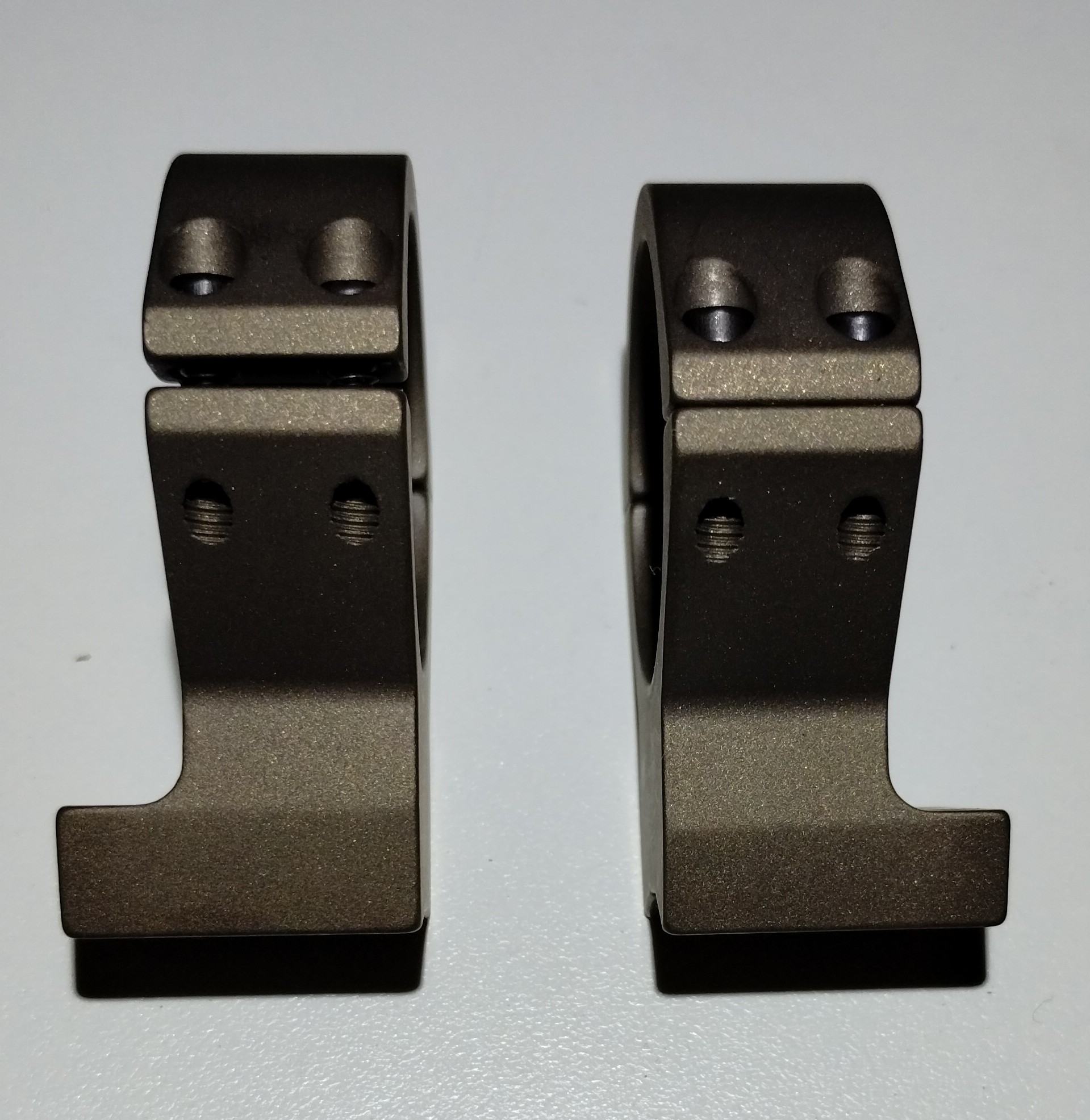

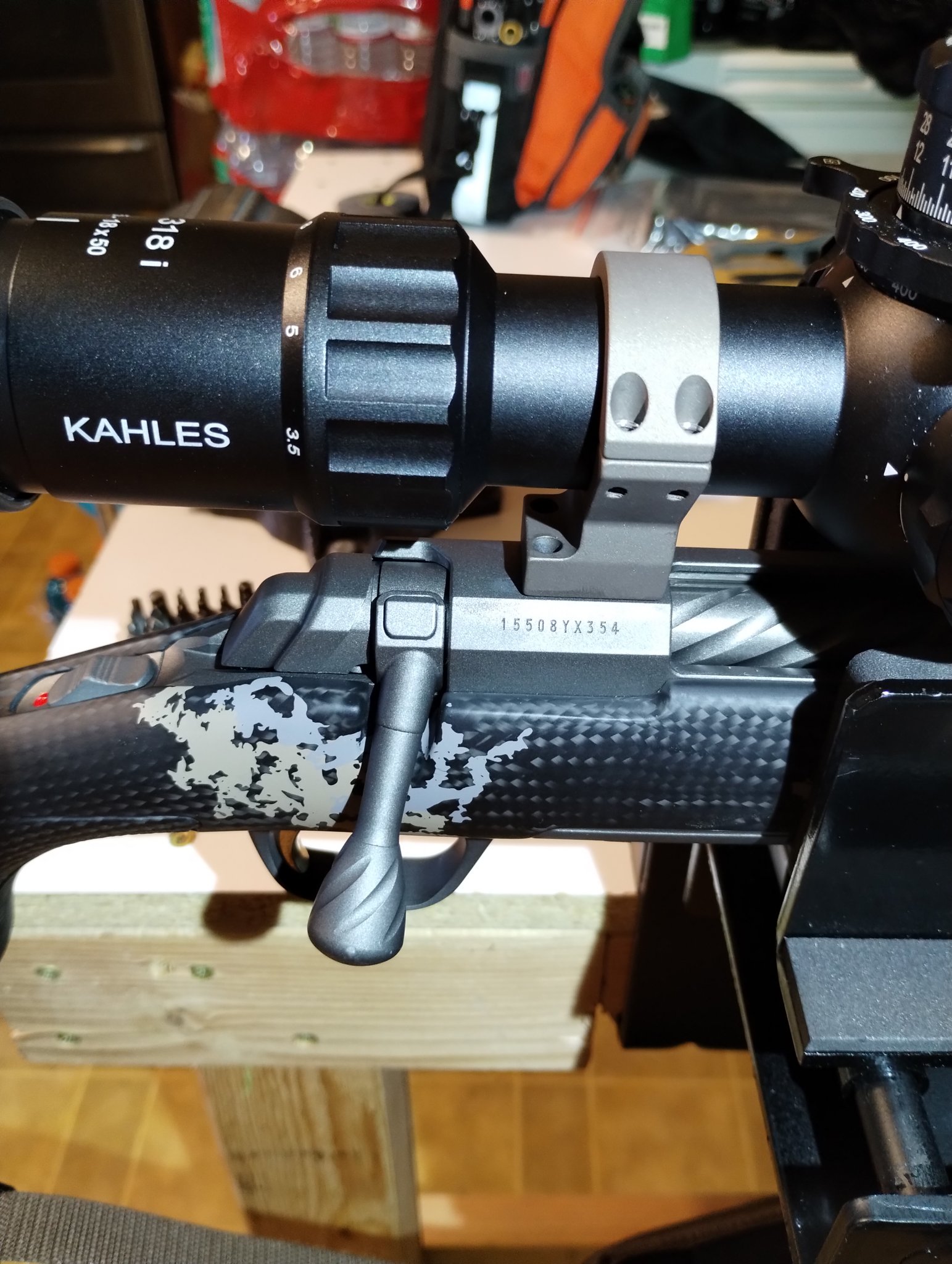

Hello Snipers hide. I have hit a wall. I bought a Browning X-Bolt Mountain Pro. I want to mount my Kahles k318i on it but I can't seem to find the correct way. I thought by going with the Talley rings specifically designed for the X-bolt I would be good to go but I do not have the proper eye relief. The scope sits too far forward due to the short tube of the scope. I'm thinking the scope just won't work with these rings and I need to get something with a longer tube or use a pic rail and rings. The scope came off an AR10 I have so there were no issues with that rifle. I only need another inch or so rearward to get the proper eye relief needed. Any ideas would be much appreciated.
Long or short action, pictures of the rings and rail setup

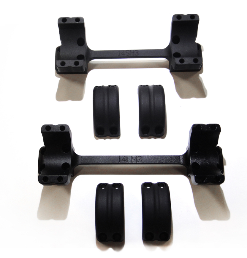

I used a DNZ 215 Tactical mount on an X-Bolt with a short tube Leica scope, worked fairly well. I no longer have the rifle, but may still have the mount. It's for a 30 mm tube.
From DNZ's site
Reactions: BAJACRACKER
