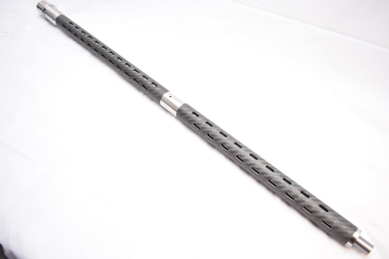

Hopefully you don't have to wait too long. Finally got word my barrel is finished and will hopefully get delivered by this weekend. Mine is a 24" 22 Nosler 8-twist. Here's a picture of it.

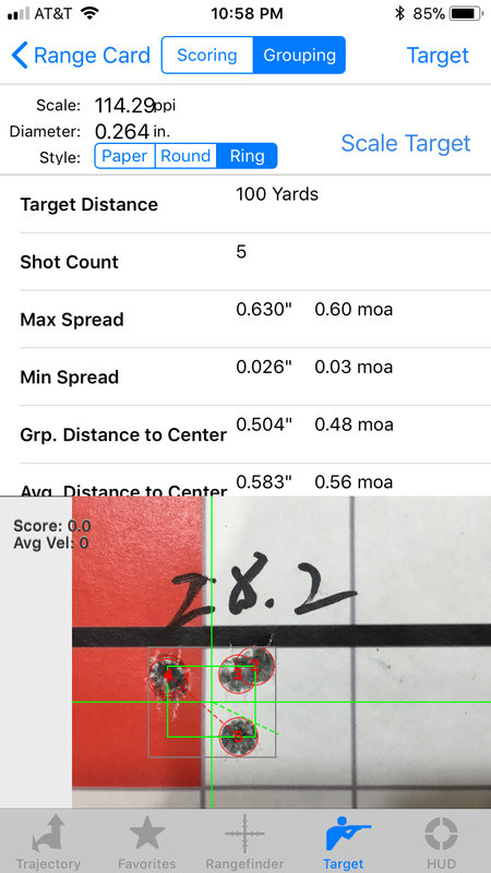

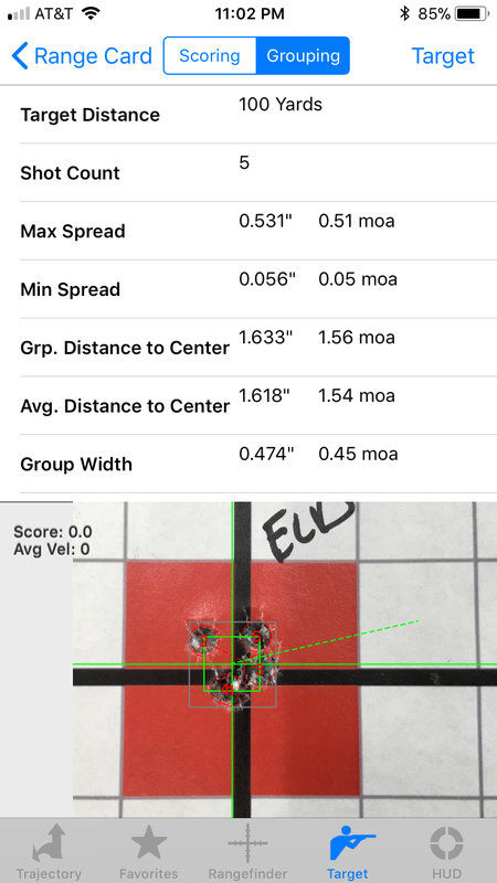

Second round... results are still solid. The first is Lapua 123 over 28.2 gr of ARComp and the second is Factory 123 ELD. Probably going to try some ELD handloads.

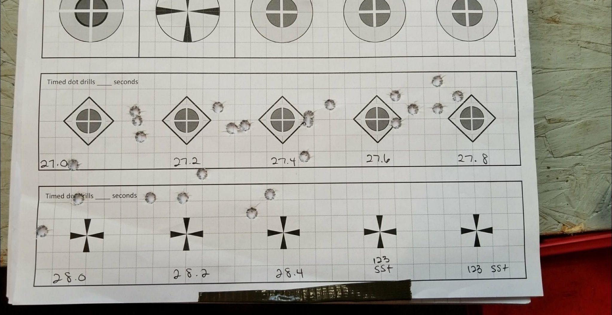

Reviving a dead thread here.
Finally finished my load dev.
I'm running a 123gr custom comp with imr8208.
Velocity could be more but for the yardages i shoot it won't matter much. Maybe give up .4 mil in elevation and .1 or .2 in windage.
Anyway results as follows.
2400fps
Es15
Averaging a little over .5 moa at 100 yards.
3 shot group.
Plan to load 100 rounds on the progressive and see if they still shoot good.
Found a good flat node
