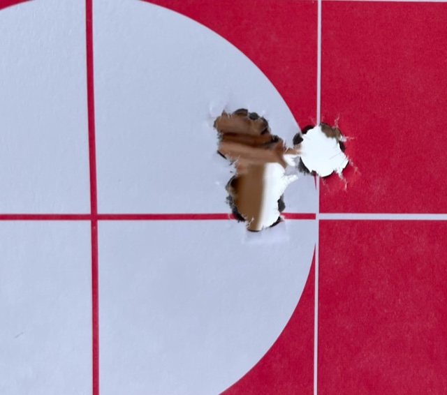

I've been looking at getting another bsf barrel and so this topic is important to me also. I contacted the same rep that I had spoken with at length previously and just gave him the run down. He told me that they did have some small issues with some "walking" after their barrels got hot (of course any barrel does that when it gets very hot, I don't care who makes it).
BUT- they addressed this issue a few years ago and have eliminated that issue. He also sent me a target of a 5 round group, which was done after a 10 shot dialing in the glass. This was done at 100yds with a 6.5C, and it's probably 1/4 MOA. Pretty damn good and the barrel would have to be pretty warm to do it.
Here's the target
Reactions: Solid308
Makes sense. The info I found seemed just a little dated. There’s not much info out there on them and what was out there pretty much 75% of it spoke of POI shift after a short string of rounds.
Thanks for the additional information, and clearing up the issue. Looks like all green lights to me.
