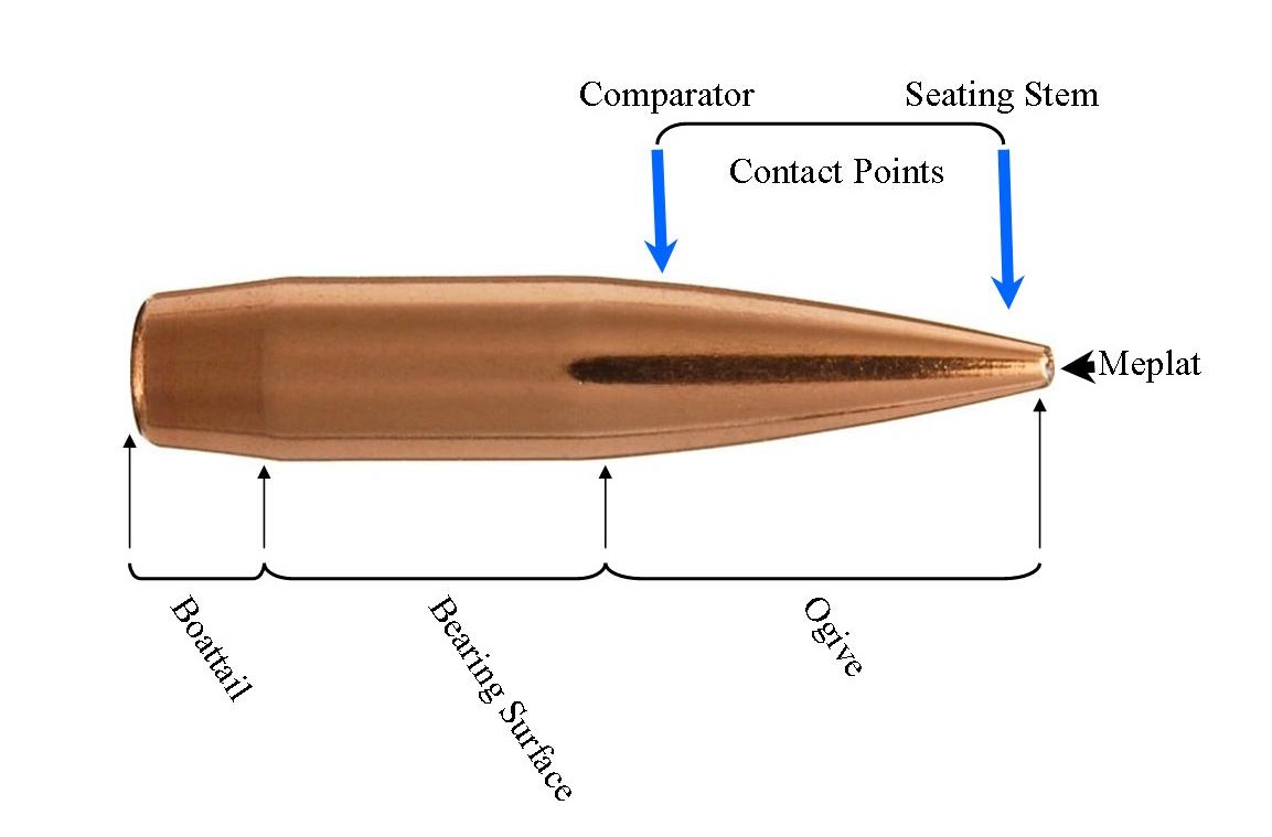

Comparators don't go all the way to the start of the ogive at the bearing surface, but are somewhat close. AND, not all comparators are the same. Like the difference in comparator measurement between my Hornady comparator and my Sinclair comparator is ~.063". And there can be some little variation within on brand too. This is why when someone states a CBTO for their loaded cartridge on a forum, it really has no meaning because we don't know what the dimensions of the comparator being used. Though there can be substantial differences in a bullets OAL, it's better to state the average COAL where readers can take their own comparator and figure out how the CBTO relates with their comparator.
A single comparator works just fine for one's own reloading purposes as it'll stay relevant to the relationship of one's own chamber they're reloading for. This is for a starting point from the lands. Once you find a starting point, the distance to the lands (the "jump") is not otherwise important as what the actual seating depth is that you find a good tuned load.
Yes, bullets are often not uniform and can have different BTO measurements. . . especially from one lot to another. This is why some people short their bullets by the BTO's.
I sort my bullets by the BTO's, but not by the standard comparator. I only use a standard comparator to determining where the lands is. I use a comparator that has a hole that touches the ogive at the same contact point as my seating die so that I get very consistent seating depths (the depth the base of the bullet go into the case). There's variations between the two contact points (sometimes not much), so that's why I choose to sort this way.

While it would be ideal to use a measurement tool (anvil) to make the bullet measurements at exactly the same diameter as the gun's touch points, having a difference in those diameters and contact areas is not the only reason you will see variation. Even the seater stem probably uses a different contact area and diameter. (It isn't the end of the world.)
Now add in the concept that there is tolerance to the bullets, the materials, and your tools versus the barrel are probably not using the same place on the bullets to reference, and you can begin to understand that this is a complicated discussion, but we can simplify it by saying we just need to be consistent with our process and trust that comparative measurements in this context are going to be nearly as good as absolute measurements where things are perfect.
The next step after accepting how difficult it is to just check bullets as a component, and how friction and contact forces make this difficult, now add in the seating force variation due to your case prep and workmanship. There can be a significant difference between virgin brass and cycled brass just due to friction differences in the neck after firing.
The measurement tooling doesn't need to be an exact copy of the gun, nor does the stem of the seater in the die. It helps to have good quality tooling, brass, and bullets, but you can master your loading without trying to turn your measurement tools and seating dies into a copy of the gun's touch points.
