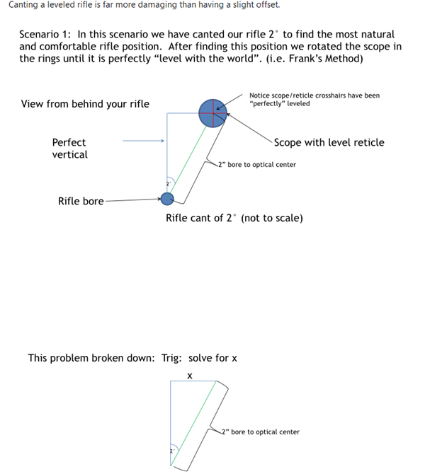

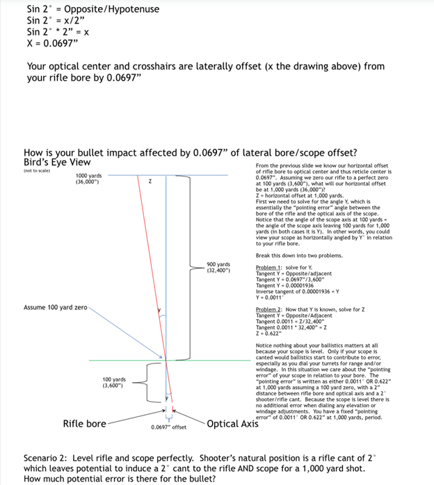

Ok, let’s put this differently. Let’s imagine that your scope is 5 degrees off of level from the rifle’s “true level” (such that you cant the rifle toward your body to make the reticle level) and sits 3 inches above the bore. The reticle center would sit 0.25” (laterally) away from the center of the rifle bore. If you were to then zero the rifle at 100 yards, you would expect your average impacts at 1000 yards to be off by 2.5”. That is well within the error of the myriad of other factors that affect bullet flight.
Five degrees is a huge amount. The average human is likely to easily identify and correct a 1 degree error. Leveling the scope to the rifle is overblown and largely irrelevant- within reasonable bounds.

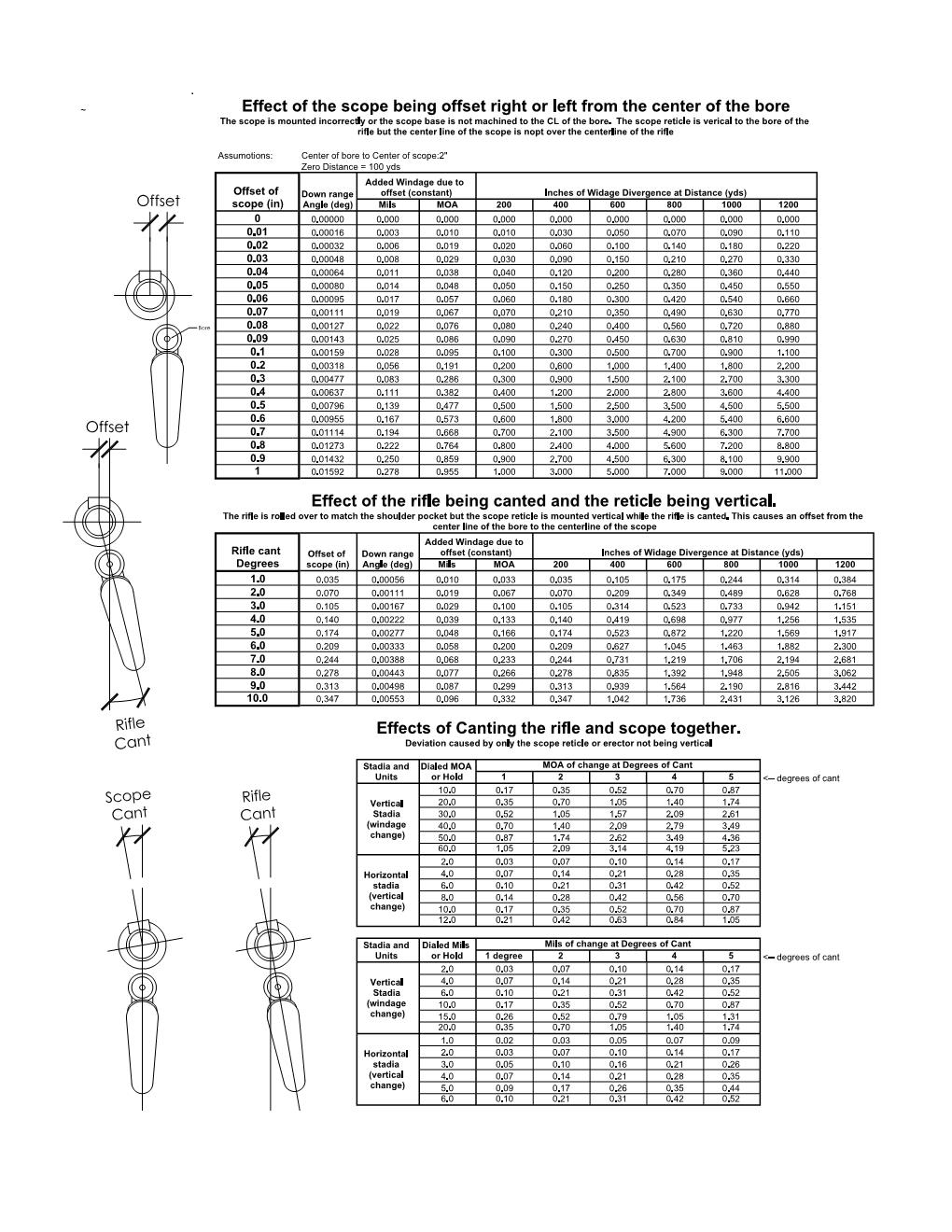

But doesn't it matter also that the rifle's bore axis is in line with the vertical line of the crosshairs? I would think that this is what needs to be aligned, not some flat surface on the rifle which may not be perfectly parrallel or perpendicular to this. And what effect does a 20moa scope base add to the equation?
I guess I'm splitting hairs here needlessly for the ranges I'm likely to use my rifle/scope for. Honestly, I simply eyeballed the three turret caps and tightened the rings to 18 in-lb. If you really think about it, you're only "eyeballing" when centering a bubble in a level anyway. The vertical crosshair checks out against a plumb surface at distance, and it also aligns with the center of the bore (I took the bolt out and boresighted to compare the relationship between bore centerline and crosshair centerline.)
You are correct that all these things matter… but they matter less than you seem to think. You’d have to be pretty noticeably off in your scope/bore offset to even get 1/8” of offset. This would result in 1/8” difference in point of impact at 200 yards (assuming a 100 yard zero).
Nobody in existence shoots well enough to notice 1/8” at 200 yards (benchrest scores prove this).
Get out and shoot. You’ll soon see why most of us aren’t taking this super seriously.

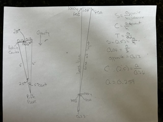

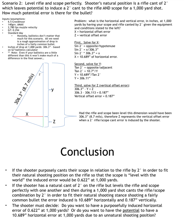

The scope does not need to be level to the action. (read as the error is lost in the noise)
The reticle needs to be plumb to gravity when you pull the trigger. If the reticle is canted you induce the elevation and windage error.
I've got the diagram some where with the math but 5 deg of rifle cant under a plumb scope is something like 1" of windage at 1000 yards
Reactions: Jefe's Dope
A 5 deg cant of a scope mounted 3” from the bore will be offset laterally by 0.26”. If zeroed at 100 yards, the rifle will be off by 0.26” laterally at 200 yards, and an additional 0.26” for each 100 yards thereafter. At 1000 yards, your impacts will impacts will be off by 2.34,” on average.
Reactions: Taylorbok
A 5 deg cant of a scope mounted 3” from the bore will be offset laterally by 0.23”. If zeroed at 100 yards, the rifle will be off by 0.23” laterally at 200 yards, and an additional 0.23” for each 100 yards thereafter. At 1000 yards, your impacts will impacts will be off by 2.07,” on average.
I didn't feel like doing the math but ya that looks right. 3" is a hella high scope. I checked my diagram and it was 1.5" HOB which is low but still we get the idea. it'll be lost in the noise of a wind call.
I use 3” because it is “hella high” and with 5deg- which is hella canted- illustrates the point that it’s lost in the noise.
And, 3” is high, but not unreasonably so for a large objective scope mounted over a rifle with an enclosed handguard- like an AR.
Hi Taylor - are you thinking of this pic or the attached pdf (actually figured out how to embed it in the post also), which I believe Frank originally posted (dunno who generated it originally).
  • Reticle vs Rifle Cant Analysis.pdf
