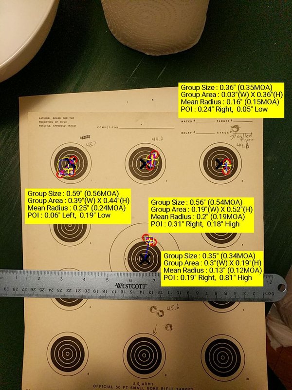

    Just an update on the Wilson barrel/budget build. Sorry for piggybacking but this has gotten many more views.
    16.5in Wilson barrel
    168gr SMK
    Varget powder
    CCI 200 primer
    1972 Lake City Match Brass
    2.800 OAL
    I called the one flyer on the 44.6 group. Target is NRA Smallbore at 100 yard. Below 43.2 was huge but the "middle" of my OCW is shown below. I don't think I as a shooter can shoot any better than this and even this is better than I normally shoot.
