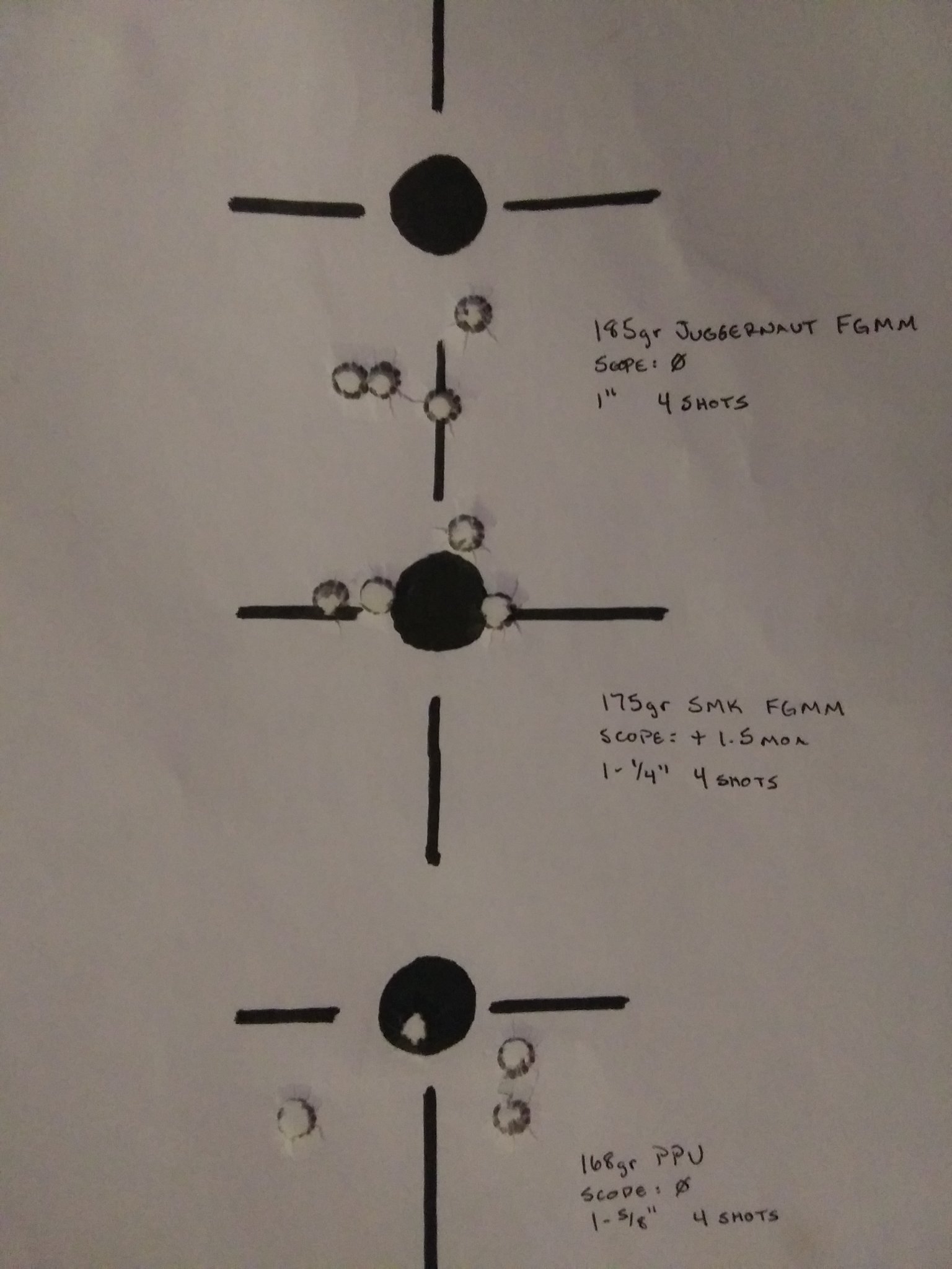

I built a lot of my AR308 from parts I got here. I got a Seekins SP10 barrel, 18", 1:11.25, with ATC comp included for like $175 iirc... I picked up a JP enhanced bolt here too, like new. It may take a little patience but you can find pretty much anything for a large frame build on the px.
Afaik, the SP10 barrels are Rock Creek blanks. Here's a few groups I shot with this set up:
The top group I forgot to adjust my scope back up for the 185's. 4 shot groups and the 185's went just below MOA. Definitely took a lot of shooting to get myself to a point where I could get an AR to shoot under MOA.

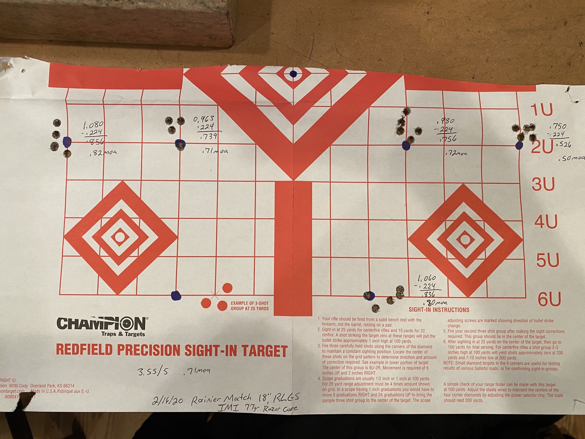

I need to get an ARP to try. I’ve been using the Rainier Match series barrels for budget 223wylde. When on sale, they are sub 160$.

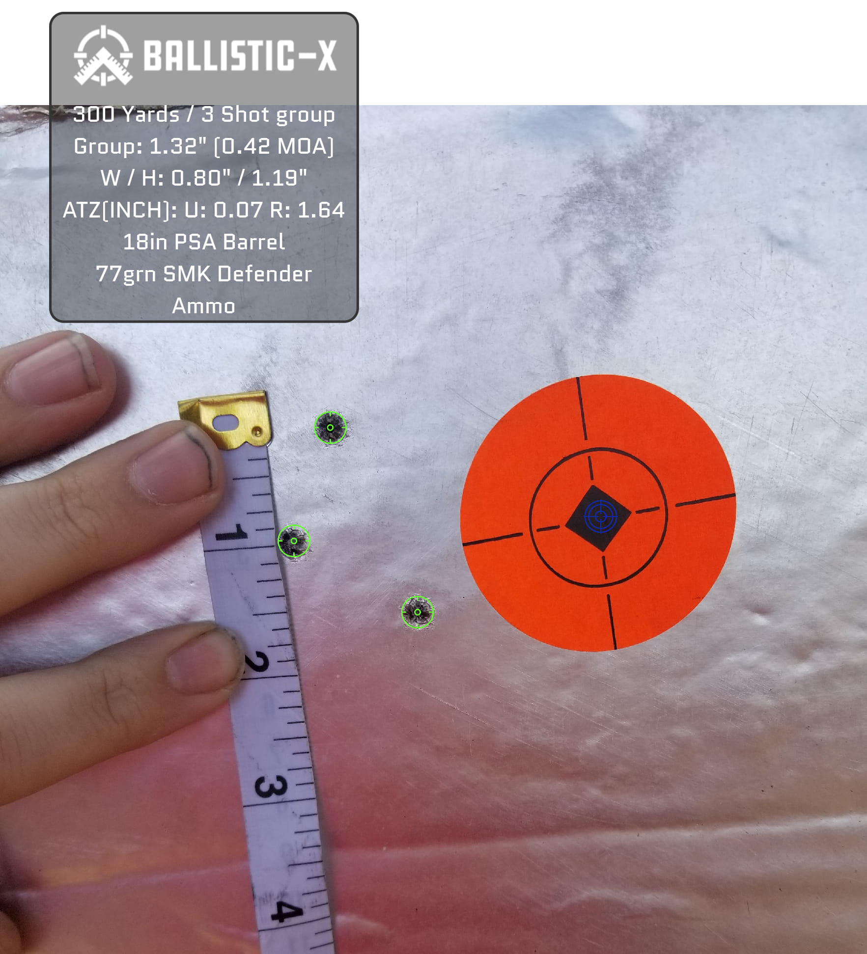

They aren’t Kriegers, but you can get them to shoot in the .6-.75 moa range with little load development. That’s good enough for my use of the AR platform. The stress relief on the blanks is pretty good too. The groups open a little but poi shift is almost nonexistent as the barrel heats up. I’ve built 6 rifles with those barrels and they’ve all performed about the same.
