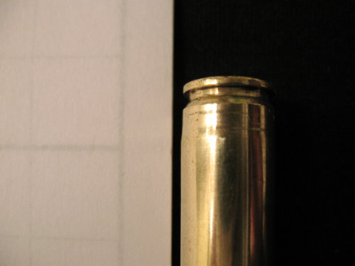

Not specific to the OP, but a question for any budget reloader: Is your rifle's chamber close to "match" dimensions, or is it oversize?
If it is match -or close- proceed with all the great advice above.
If "I don't know..." What does your brass look like after being fired? Is it visibly stretched?
If it's oversize, prioritize getting your barrel set back with a match reamer, or possibly having your rifle rebarreled.
One can reload with an oversize chamber, but it might increase the amount of fire-forming and brass prep you need to do, and shorten the life of your brass. Fixing a bad chamber can pay for itself (for cartridges with long barrel-life) with time and components saved.
