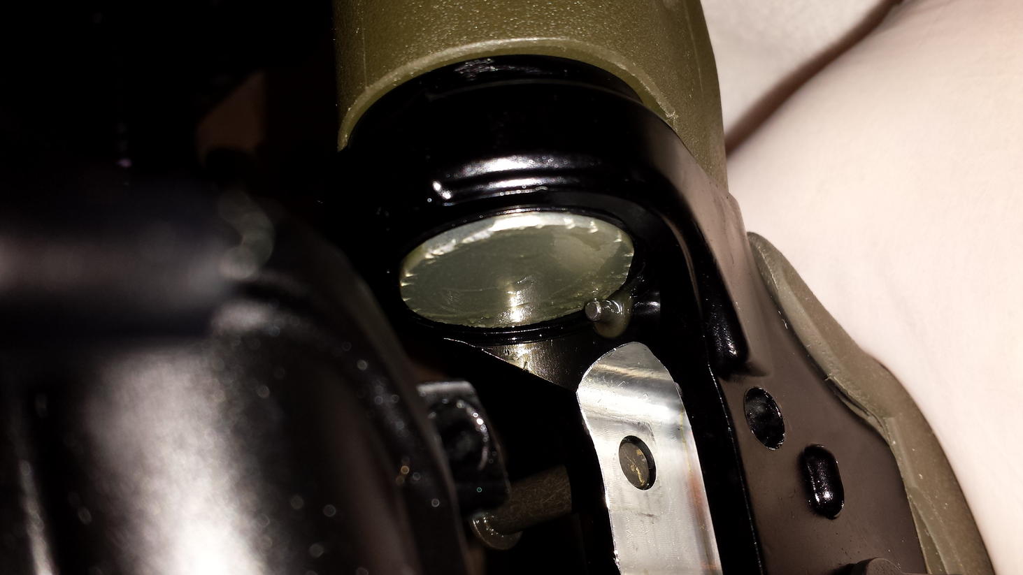

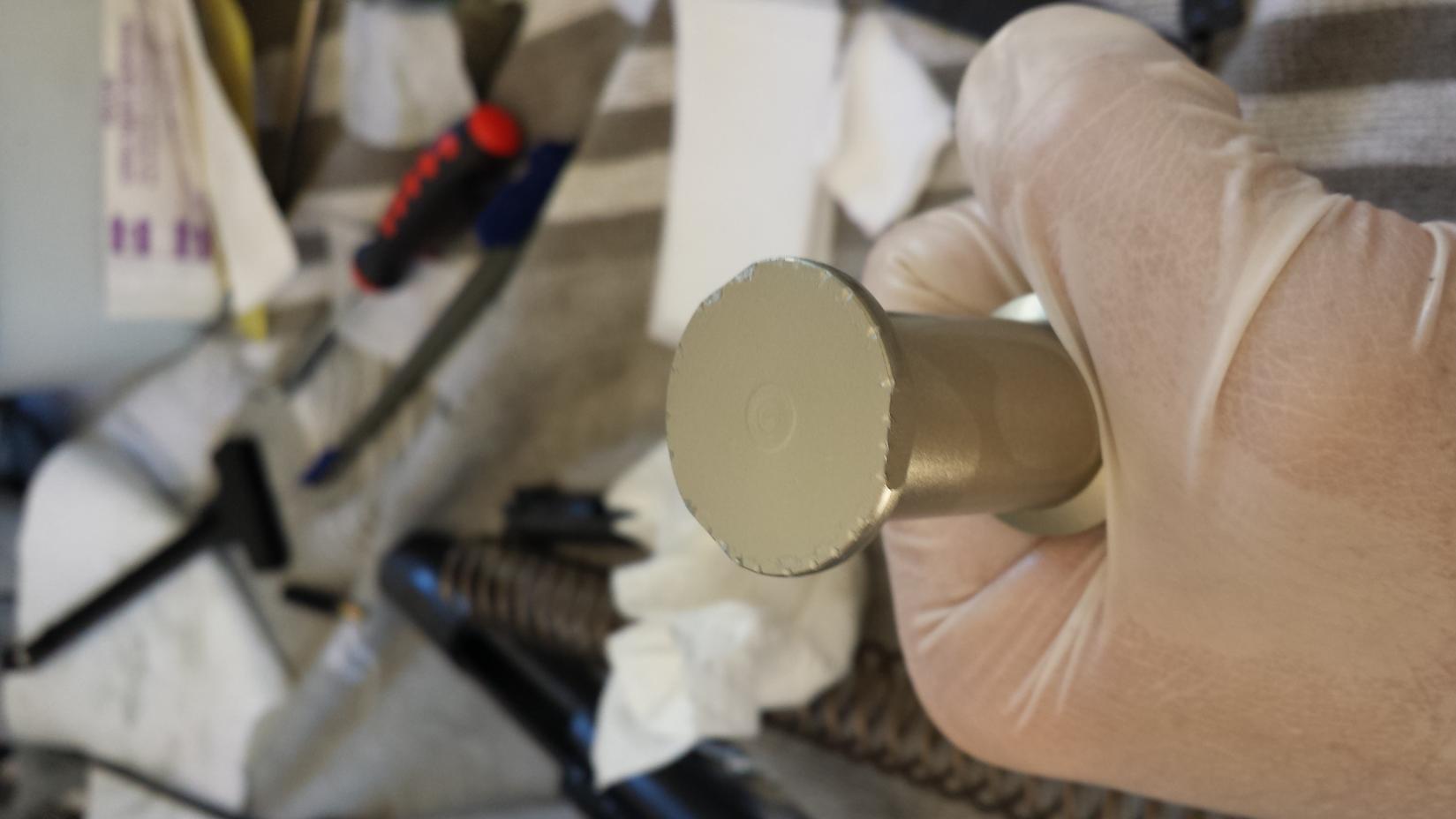

    I have a new Grendel and was cleaning it when I found this... It looks like the buffer retainer plunger is hitting the buffer, what can I do to solve this? if I back out the buffer tube it will make the stock loose. I have a Magpul PRS stock with Standard length tube, spring and buffer.
    That should not be happening as the bolt carrier should always be keeping a little tension on the buffer and never let it come forward far enough to hit the buffer retainer.
    IMO your carrier is out of spec.
    It may not necessarily be the carrier that's out of spec. I have seen similar results on ARs where the lower was out of spec. Specifically, if the buffer detent pin hole in the lower was improperly placed too far rearward...toward the receiver extension/buffer tube...it can allow the buffer to make contact with the detent pin instead of the back of the carrier and cause exactly the buffer damage you are experiencing. The only time, on an in-spec, normally functioning AR, that the buffer should contact the buffer detent is when the upper is pivoted up or removed completely from the lower. All that pin does is "capture" the buffer and spring from popping out of the lower/launching.
    What kind of lower receiver (make/model/etc.)?
    Since that buffer is already boogered up I might would cut a notch around it where it is hitting. It might work and is cheaper than a new lower.

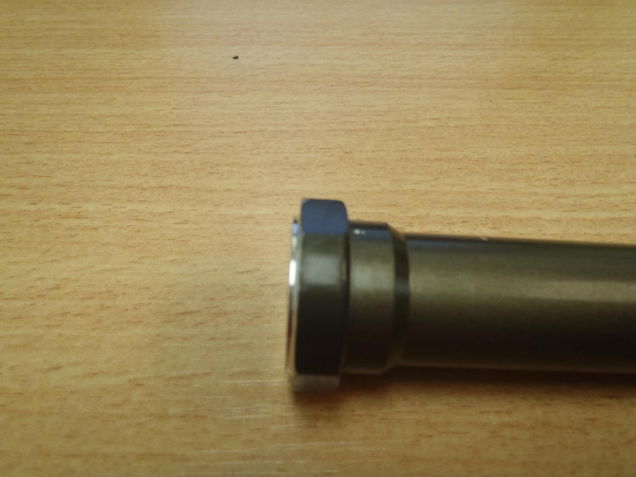

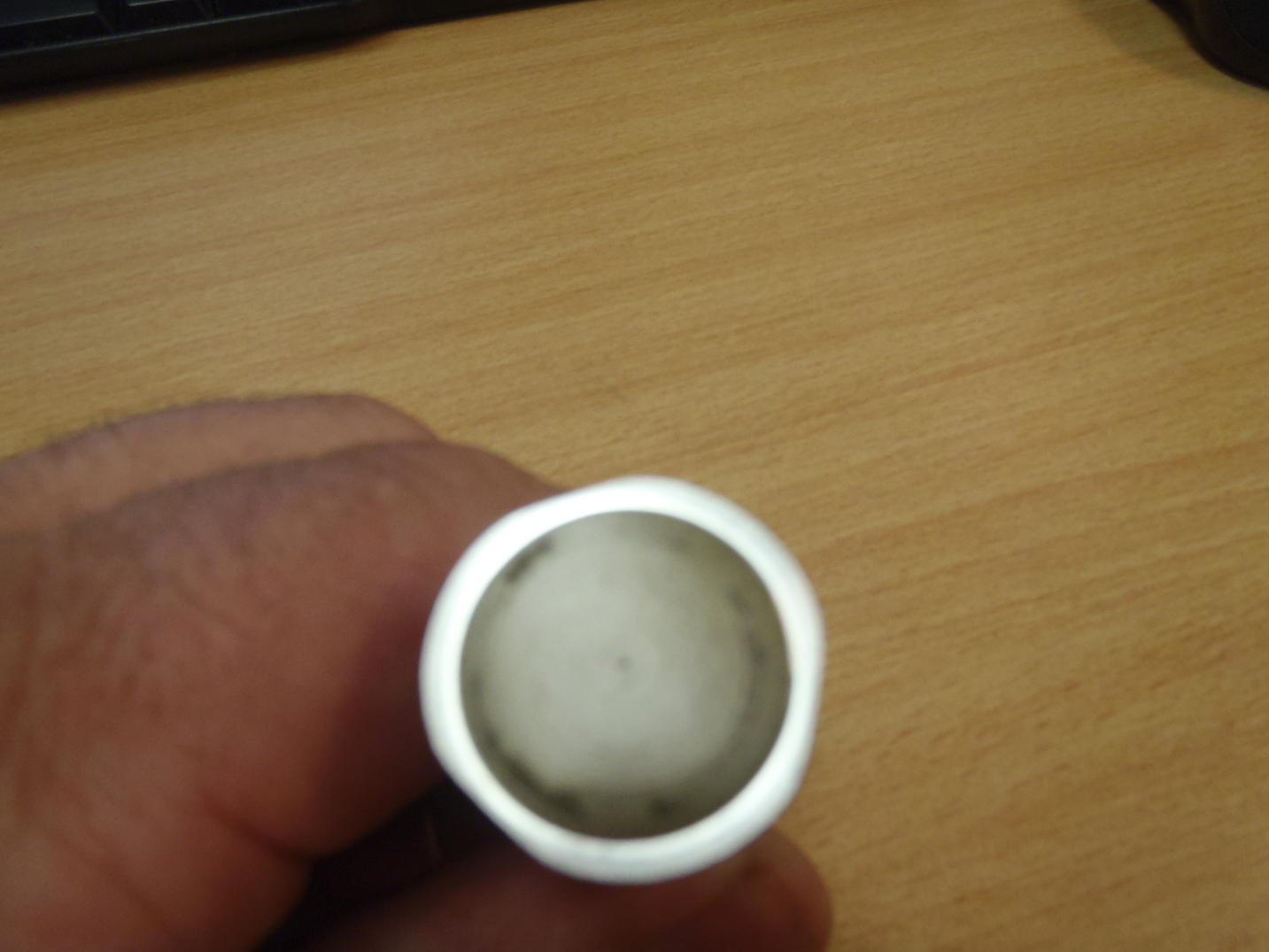

    Can I just run the weapon with no spring and pin for the buffer? Then just watch out for a flying buffer when I field strip it? I am going to take some pics shortly...
    can you post a pic? The damage is consistent with the explanation by ORD.

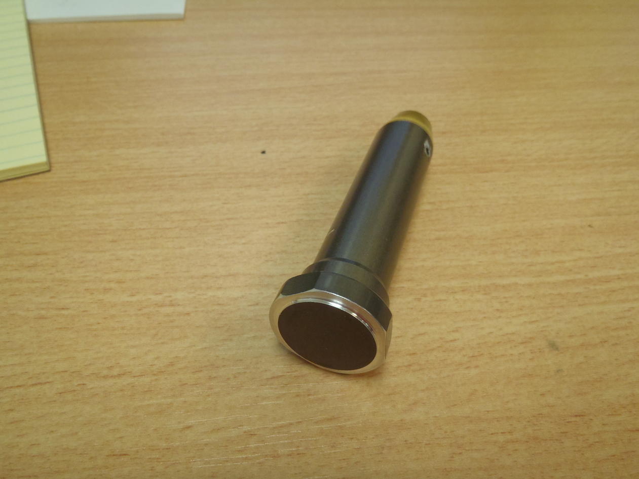

    here are some pics. there are no burs anywhere, it's as thought the buffer spring is causing the buffer to hit the retaining pin too hard... if that makes sense...
    Its always difficult to tell much in the way of where a problem might rest (especially the prob you are experiencing) just from pics. I stand by my original statement that its the detent hole milled/drilled too far rearward in the lower that it causing the problem.
    As for your proposed "fix" of just removing the buffer detent and spring and running the rifle without those parts...the short answer is YES, that WILL work. However, as you observed, every time you pivot the upper on the lower or remove it completely, you'll need to be prepared to catch flying components! ;)
    Milling the face of the buffer as also suggest may work depending on how much you have to remove to resolve the problem, but in turn, you weaken the buffer face somewhat which could result in other problems. You could also look into one of the "anti-cant" style buffers made for piston driven ARs that look like this: Heavy Buffers | Products
    Those buffer were designed to deal with the issue of "carrier tilt" which won't be an issue in a DI rifle, but they do have the face of the buffer milled in a similar fashion to what you'd be doing to yours. The problem with doing that on a "standard" buffer is that there isn't nearly as much material on the face as Slash's anti-cant buffers and may cause the weakening of the buffer I mentioned above.
    The best course of action is to replace or repair the lower, but I realize that gets expensive and poses other issues too.
    Good luck!
    Another solution, albeit expensive, is a JP silent captured buffer & spring. No retaining pin needed as the weights and springs are held captive by the guide rod.
    Another option would be to fill the buffer retainer hole, possibly with JB Weld or similar, and redrill it in the proper location. Or machine the front radius of the hole forward and back fill the area that shouldn't have been removed. Not really a high wear area,as the only time the retainer will move much is when the buffer is removed, maybe a bit of movement when the upper is removed and the buffer rests upon the retainer.
    This is not only bad idea but it's a cunt hair past patently stupid.
    I'd just run it without the detent and remember when it is time to field strip. Or, forget about it, and have some extra components on deck!
    Appears to be the cheapest solution...Problems like this are pretty damn aggravating, but it could certainly be worse.

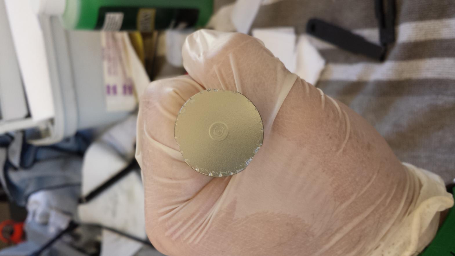

    I CAN FIX THIS!!!!! Done it before. You will NOT have to make any expensive/tricky alterations etc. All you need is access to a lathe or take your buffer to a machinist. I just gotta figure out this picture attachment thing...... I'll get back with you soon I hope.
    Here you go. Chuck the buffer in a lathe and make a cut on the buffer face 0.125" into the diameter and 0.030" into the length of the buffer. The pics explain it a lot better than I can. This will allow the buffer to protrude farther forward before it touches the retainer pin. When you hinge the upper closed, the bolt carrier will push the buffer back into the buffer tube slightly, as it is designed to do, preventing contact with the retainer during operation. Simple, cheap, effective. Your "out-of-spec" lower is now useable in a normal manner and all the nay-sayers be damned.
    View attachment 16998View attachment 16999View attachment 17000
    Seems like that would reduce the surface are in contact with the BCG, may or may not cause a wear issue, i.e. mushrooming or chipping of the contacting edge of the buffer. Though it may be better than running the gun without a retainer, that seems like it would increase the odds of losing/damaging parts or smashing fingers too much.

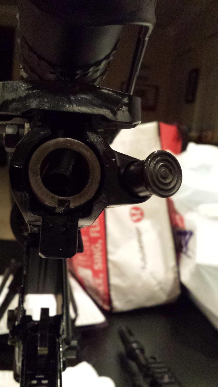

    Mtrmn's idea would work. Another thing to look at, is your barrel extension flush with the inside of the upper receiver? If the extension sits in from flush, you can have the face of the upper cut down so that the extension sits flush, thereby moving the carrier back enough to contact the buffer when closed up.
    I've only seen this once on one of my AR15 builds and that was my problem. Fixed by using an upper receiver facing tool and valve lapping compound.
    I have 2 beater AR's at home that have been repaired this way. One is my truck gun that probably has a couple thousand rds through it with no noticeable wear. Whereas it only took about 50 rds before I noticed the face of the buffer getting beat up by the retainer. I would think running one for very long like this would elongate the retainer hole. When the gun is assembled, the bolt carrier is SUPPOSED to contact the buffer and push it backwards slightly-preventing contact between the buffer face and the retainer. The buffer and retainer should only meet when the upper is removed.
    The buffer IMO is the sacrificial part here-much better to modify it than risk having to buy a new lower. And I was as surprised as anybody to learn that my idea actually worked as well as it does. I have not found a downside to this so far, and if I do buffers are cheap.
