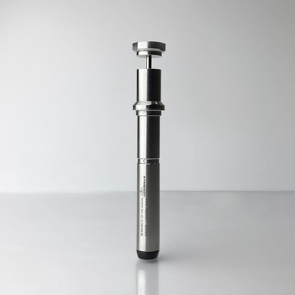

Building a new AR10 in 6.5creedmore. I have a Geissele Super 42 braded rifle length buffer spring and a KynSHOT hyd buffer (RB5006).
When putting the buffer into the spring it is very tight up against the buffer. I have to force and "screw" the spring onto the buffer. It seems to cycle with the charging handle but i have not fired it. (Scared of messing it up lol)
Any idea if this is ok or what I should do about it? It should be a loose slip fit shouldn't it?
I will upload a picture when i get a chance.

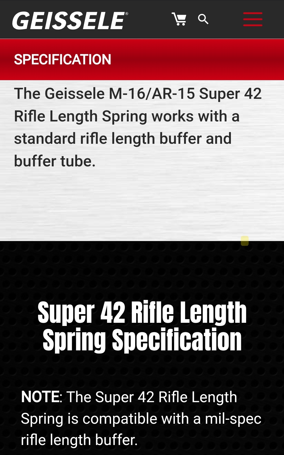

I thought you HAVE to use the Geissele buffer with the twisted wire recoil spring.
Because the twisted wire is "thicker" then a regular AR recoil spring.
From the webpage.. "The Super 42 spring and Geissele buffer are designed to work together as a set; the spring will not fit over a standard buffer. If installed with a standard buffer damage to the rifle or receiver extension will occur. )
I would check and make sure you have the rifle spring and not the carbine by accident

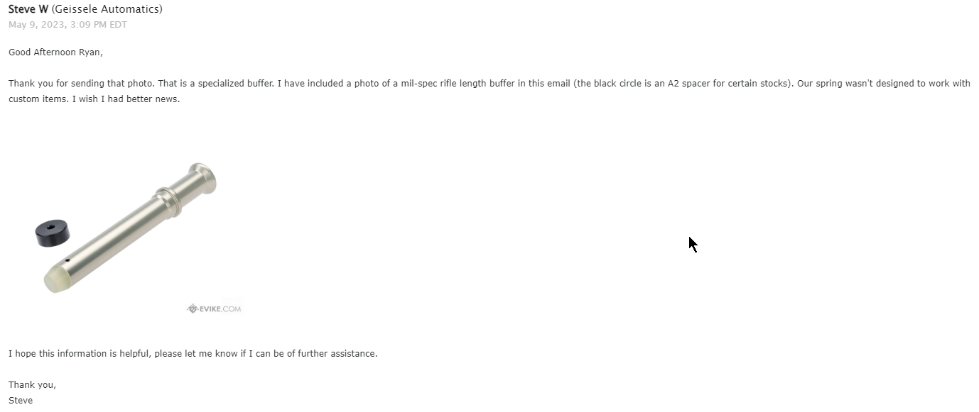

it mentioned length not diameter. I reached out to geissele, ill update this when I hear back.
If these do not work together, would you keep the spring with a geissele buffer or change the spring and keep the Kynshot buffer?

Geissele pretty well just brushed me off when i told them what buffer I was trying to use. I tried to find it, but can anyone tell me what the diameter of a mil-spec buffer is?
One more question, would yall rather the kylshot buffer or the supper 42 spring? Looks like i will be returning one of them.
how is that being brushed off
I felt that as soon as they saw anything not "standard" it was immediately assumed to be the problem. there were more emails with me trying to determine why this would not work and what diameter the buffer should be but was just set a list of links where I could buy a new buffer. (Brownells, Midway, …)

The KynShot lower area measured 0.745" with a 53 thousands difference makes since why it wouldnt work
