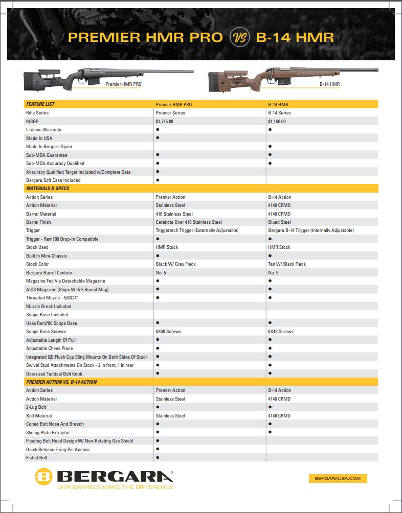

I hadn't heard of the HMR pro yet, so I found this on Bergara's site.
http://www.bergarausa.com/pdf/HMR_vs_HMR_Pro.pdf
Thats a good find

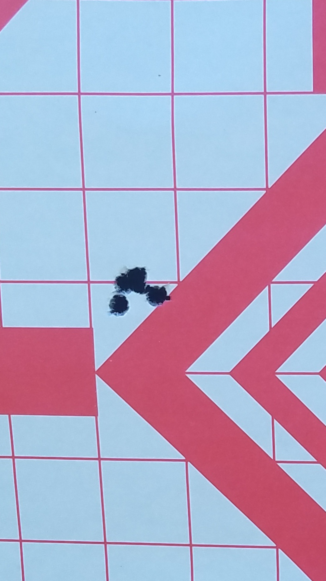

I love my HMR. Ll of my Rem 700 accessories have worked for it perfectly (Nightforce 20 MOA rail, Triggertech Primary adjustable trigger). I would have grabbed a Pro had I known about it, but I really can't complain about the standard HMR. I'm a terrible shot, this is my first rifle one could consider to be 'long range,' mine is chambered in 6.5 CM, and with Hornady ELD-M, it consistently prints groups around .6-.7 inches at 100 yards. Haven't had a chance to take it out further yet though.

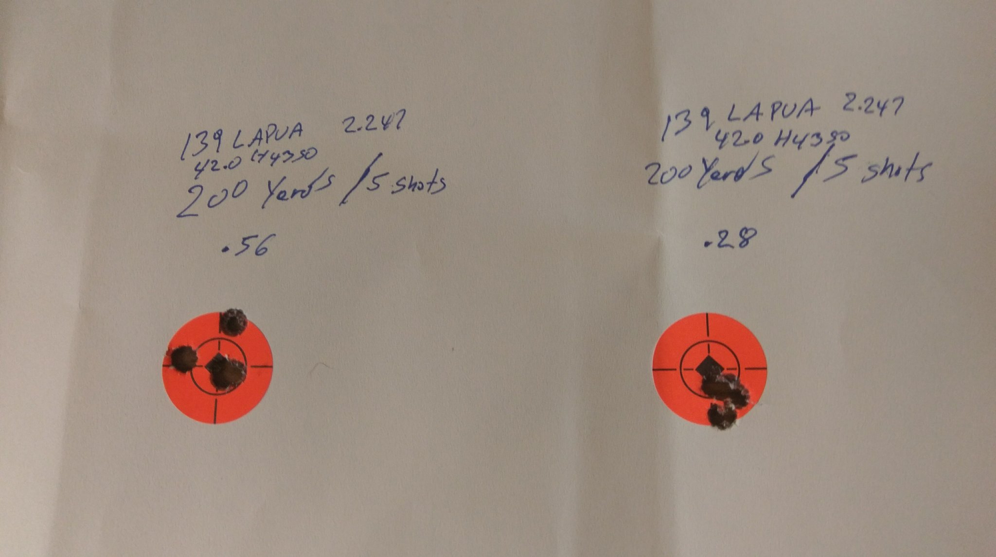

Yesterday with my Bergara B14 6.5 creedmoor at 200 yards 5 shot groups no cooling time between shots bipod and rear bag.
Have around 680 rounds through it and it has held up fine.
Gripes, throat is very long on mine, makes you seat bullets long but long rounds get stuck under feed ramp so you either remove some feed ramp metal or seat short.
6-48 scope screw holes, I have a heavy Bushnell XRSII on it and it has been rock solid but Bergara should of used #8 screws.

Pretty nice grouping
