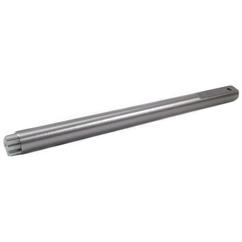

Barrel is installed from the factory with a smooth barrel nut so I guess a vise and pipe wrench would work since I dont need the factory barrel nut to install new barrel but I hate to resort to that.
Two things that may or may not help:
Scroll down a couple/eight posts and there are some good methods shared on how to remove the barrel nut.

For what it's worth, my Anarchy Outdoors action wrench was way oversized for my action. I'll be interested to hear if you're experience is better.
Since mine is intending for a hunting rig I may well be lugging around snow-covered New Mexico elk territory, the factory barrel is staying (rumor has it the weight is handy enough and the barrel will still shoot true for a good 3 shots- hunting standards).
All that to say this- That wrench is probably the only item they offer for the American which I didn't buy.

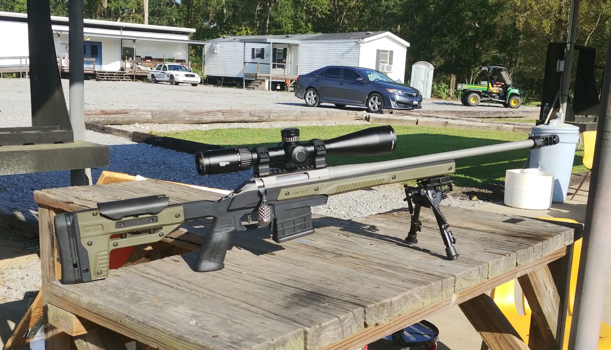

This is my Ruger American Predator stainless in an Oryx chassis. It's stock except for an Anarchy cocking piece and bolt handle. Shoots 1 1/2" at 200 with Hornady 140gr ELD. I topped mine with a bought on clearance PST II and even with an atlas bipod I have under 2k in a rifle that shoots better than I do.

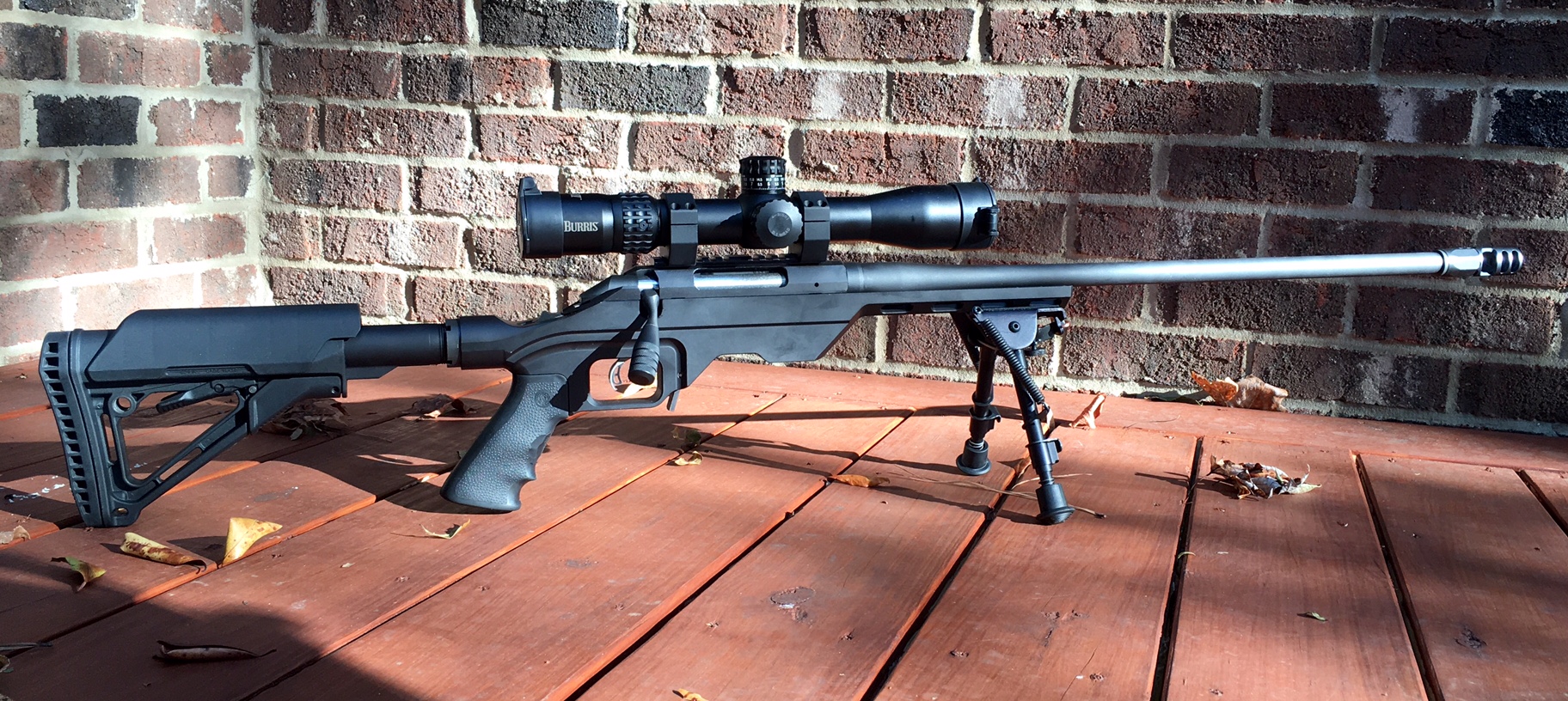

Had one of the first Predator 6.5 Creedmoor rifles (predating the Precision Rifle's introduction)...early adopted MDT's first Ruger American chassis (middle of 2016). Upgraded to an XLT buttstock in 2018 (can't find the photo). Factory barrel prints nice groups with factory Hornady Match and variety of reloads.
Also have a Ruger American Grendel in a Magpul stock (floating around in a thread here somewhere)....

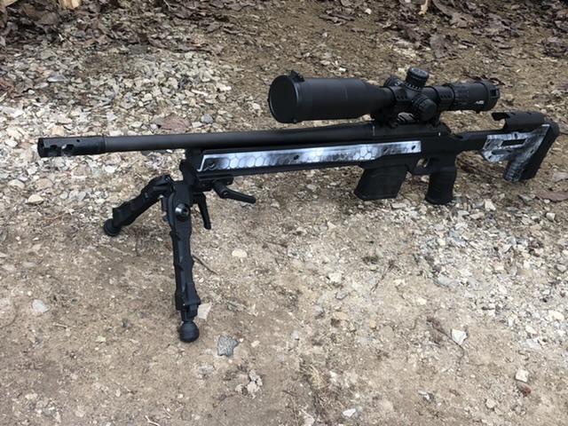

I have a rap in .308. I put mine in an oryx chassis, added the oryx specific arca rail. The factory trigger is nice enough that I can’t justify the timney just yet.
shot under an moa out of the box with factory ammo. if I’d didn’t have the need to mess with everything it would have been a good hunting rifle from the factory.

Did you take the plastic off and paint that yourself? Looks nice thats the only thing about my oryx that i really don't like ... with the budget chassis everyone has the same one

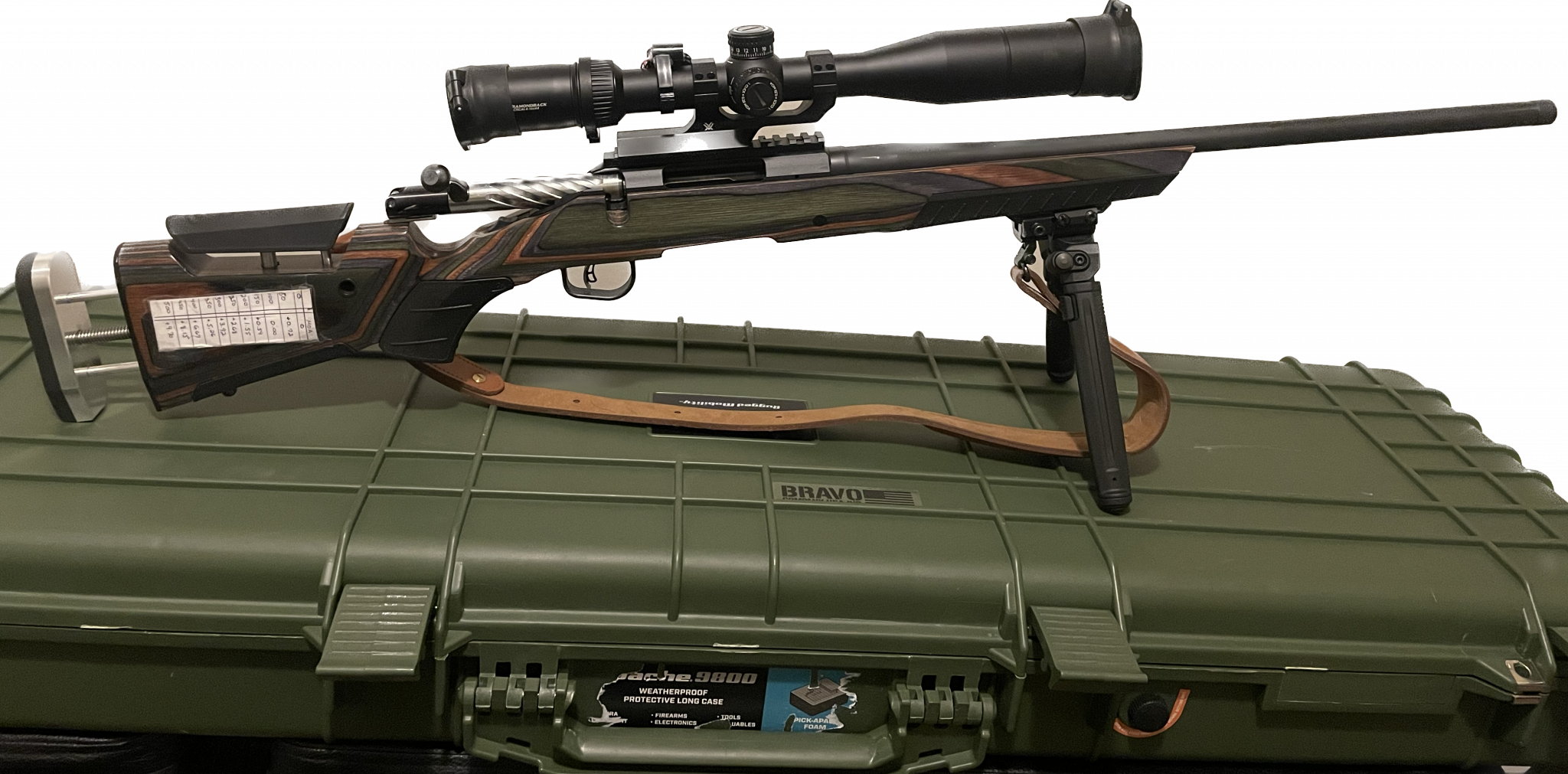

Below is my Ruger American Predator that I built up. Boyds At-One gun stock (bedded), Vortex Diamondback Tactical 4-16x44, Ruger Cobra Leather Sling, Magpul Bipod (picatinny rail version), Bravo picatinny rail, fluted bolt from LRI, and a custom swivel stud attach and turret light.

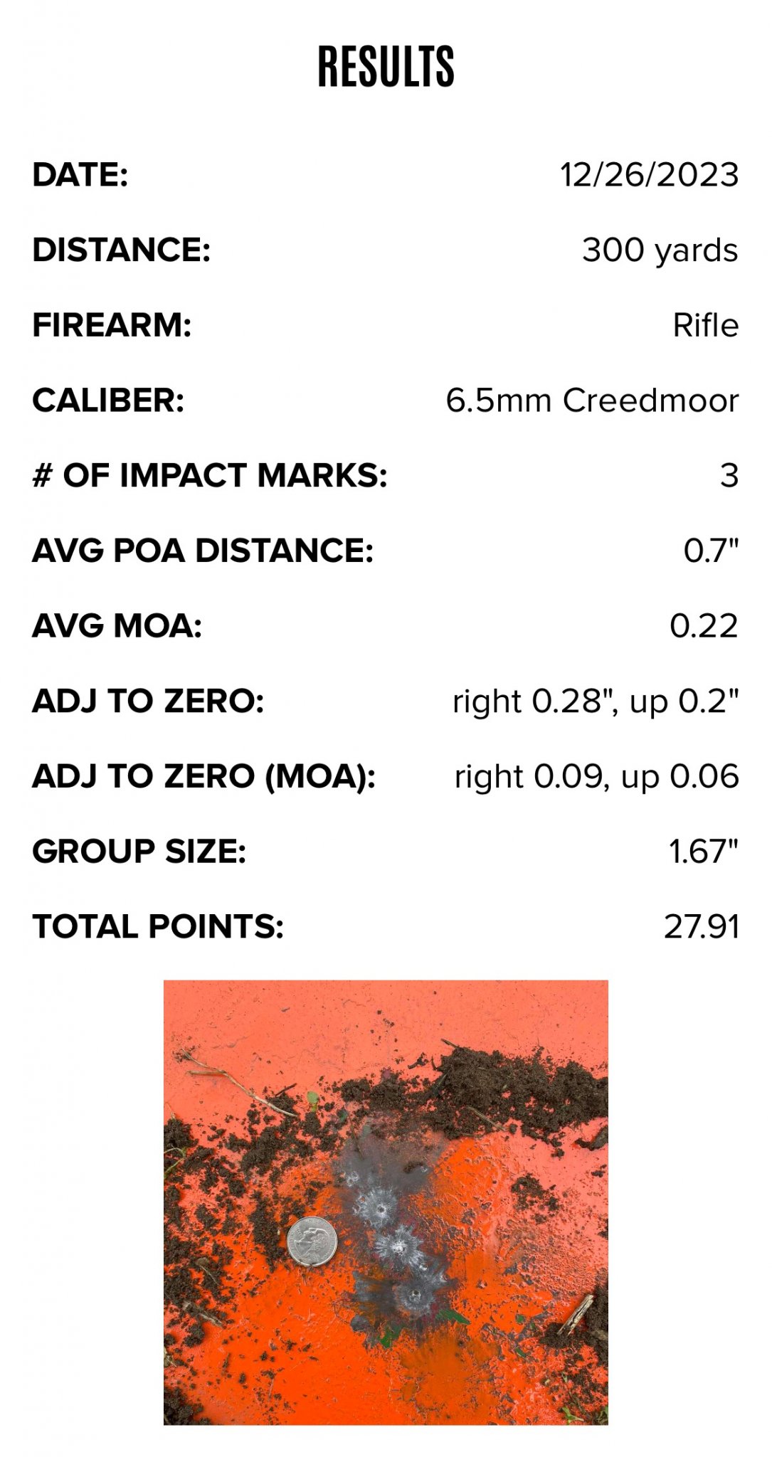

I shot the a little over 1/2 moa at 300 yds with 140 FMJ Tactical Rounds from Sellior and Belloit. It was before the picatinny and light upgrade but hope it shoots the same.
