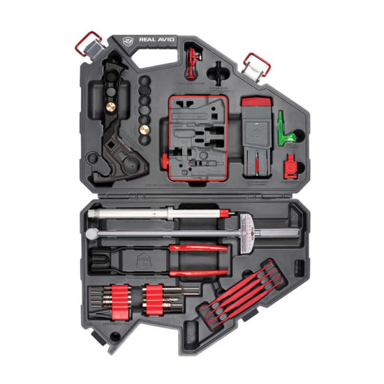

If your looking for tools check out Real Avid I have some of their tools and they work slick.

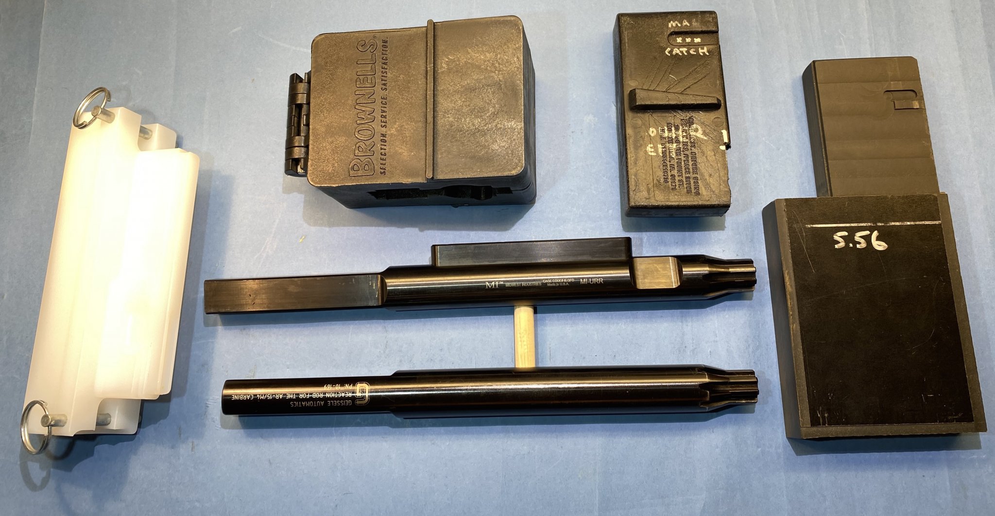

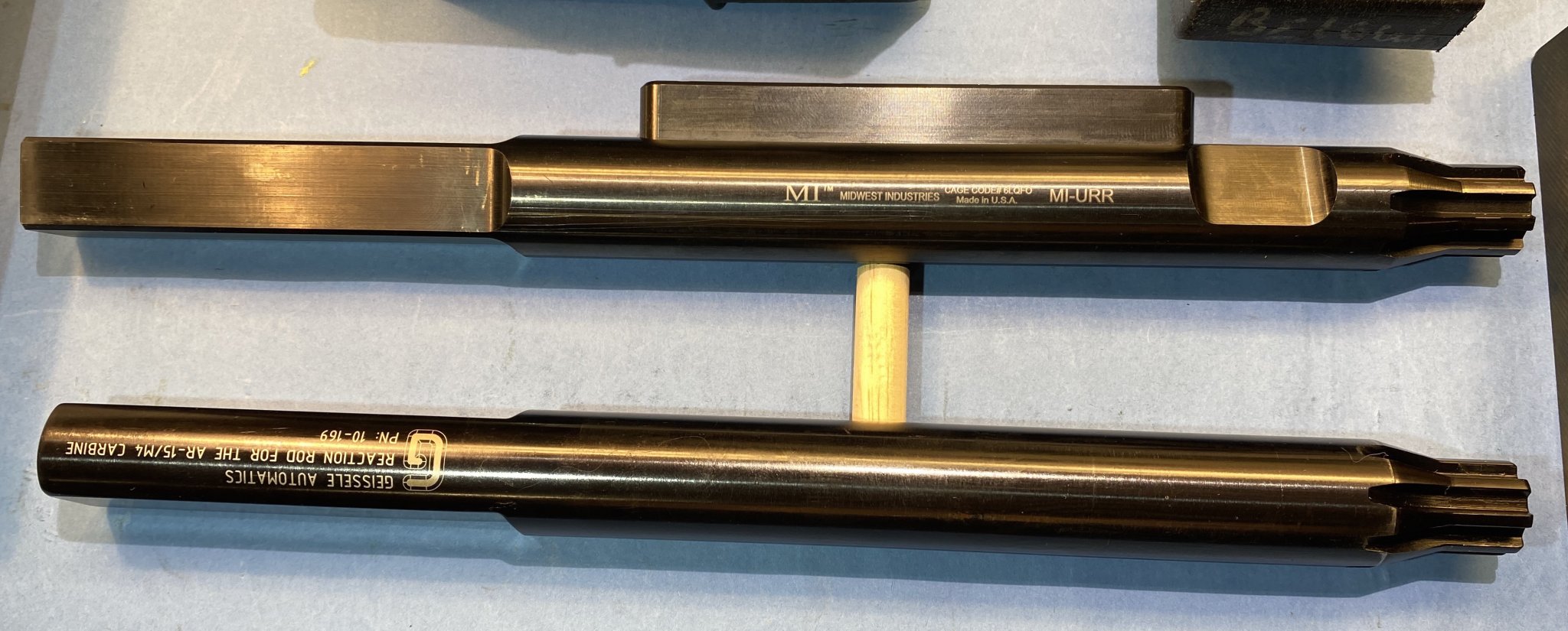

Here's a few thoughts from my bench.
If you are going to purchase a reaction rod I would recommend the Mid West Industries over the Geissele only in that it has an
integrated support for the upper portion of the the receiver; surprised Geissele over looked that fine point.

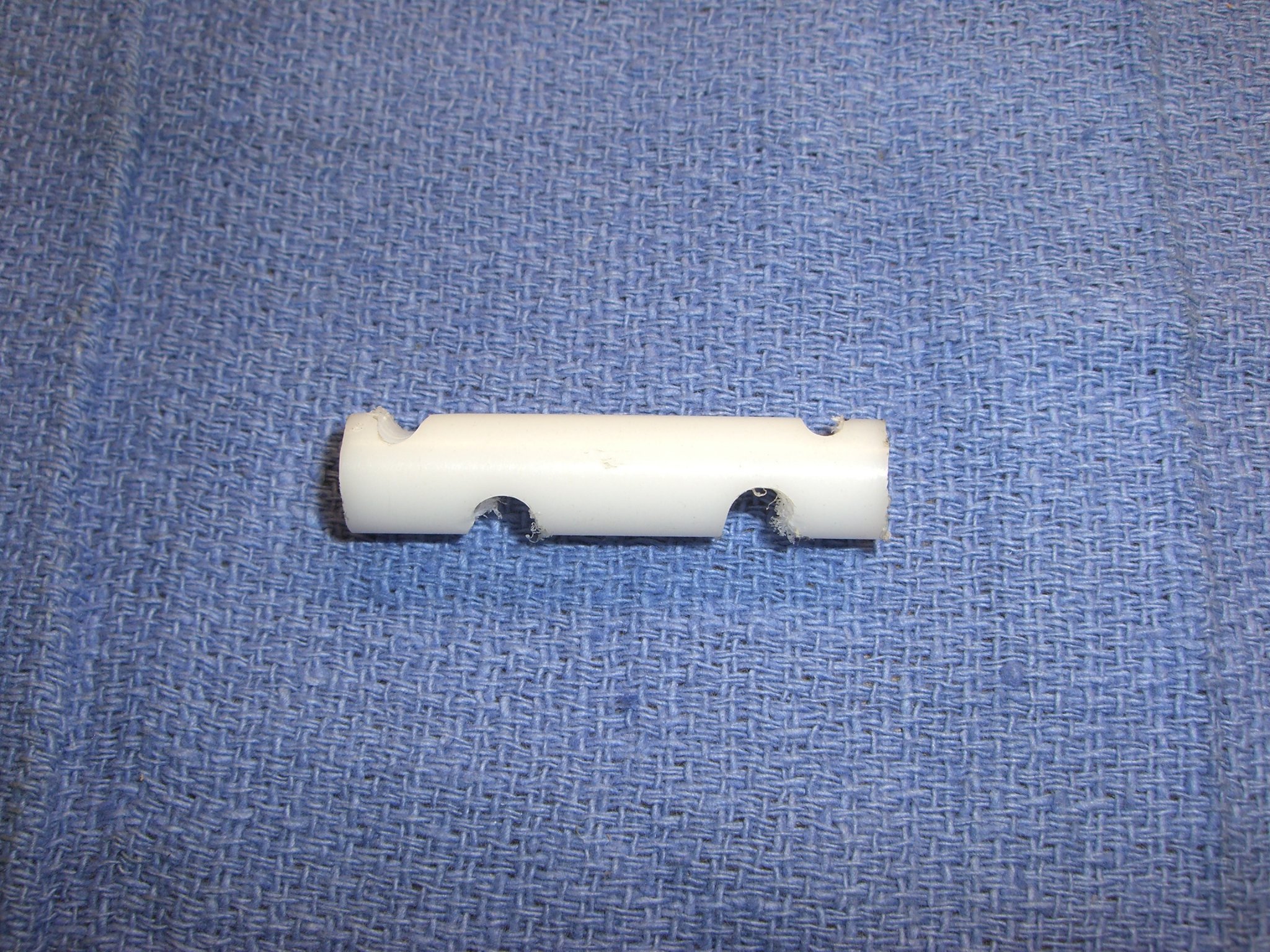

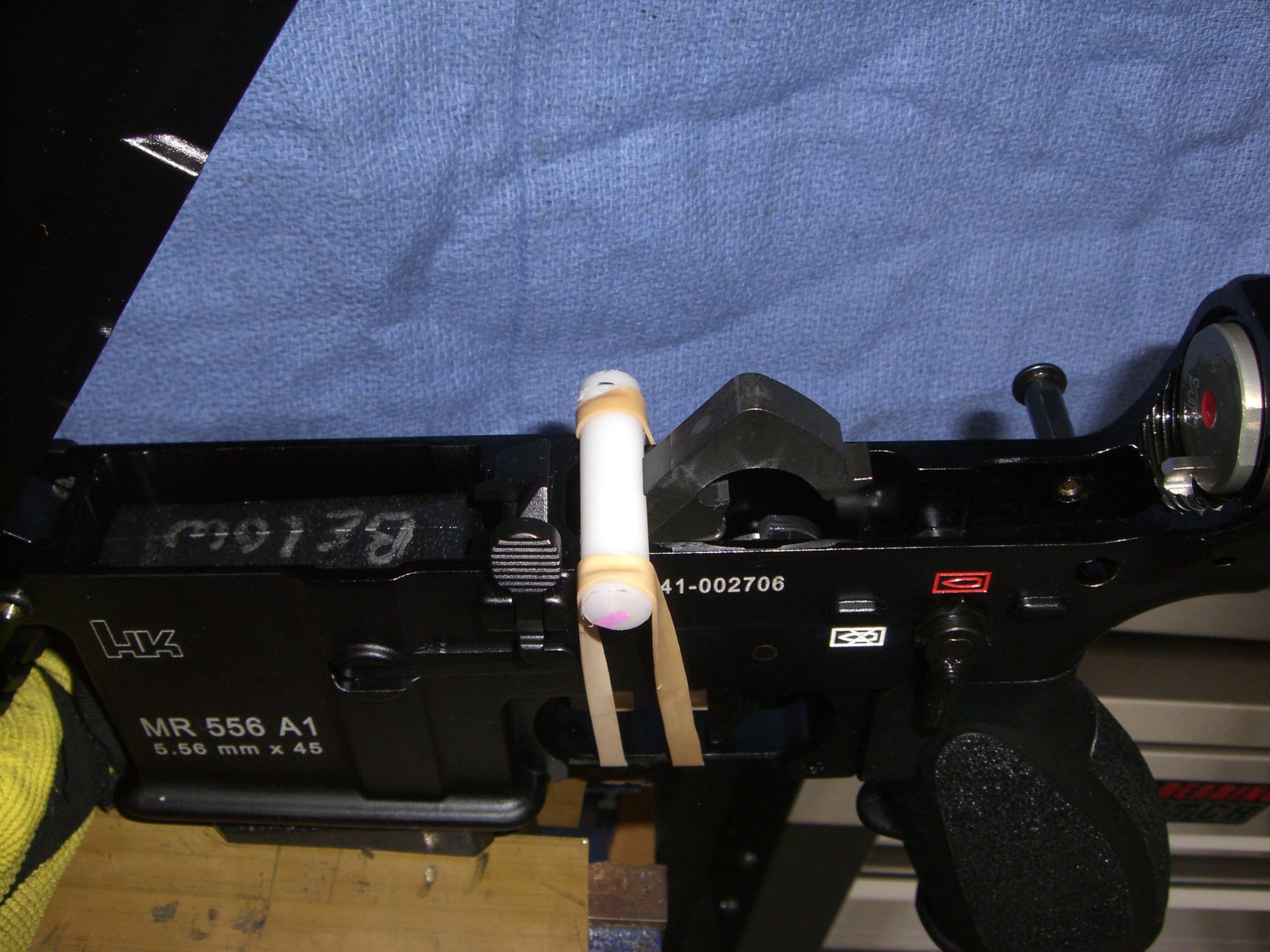

Just like with 1911's, an AR hammer block is easy to fabricate if you are doing any open trigger work to prevent the hammer from
slamming into the magazine well wall.

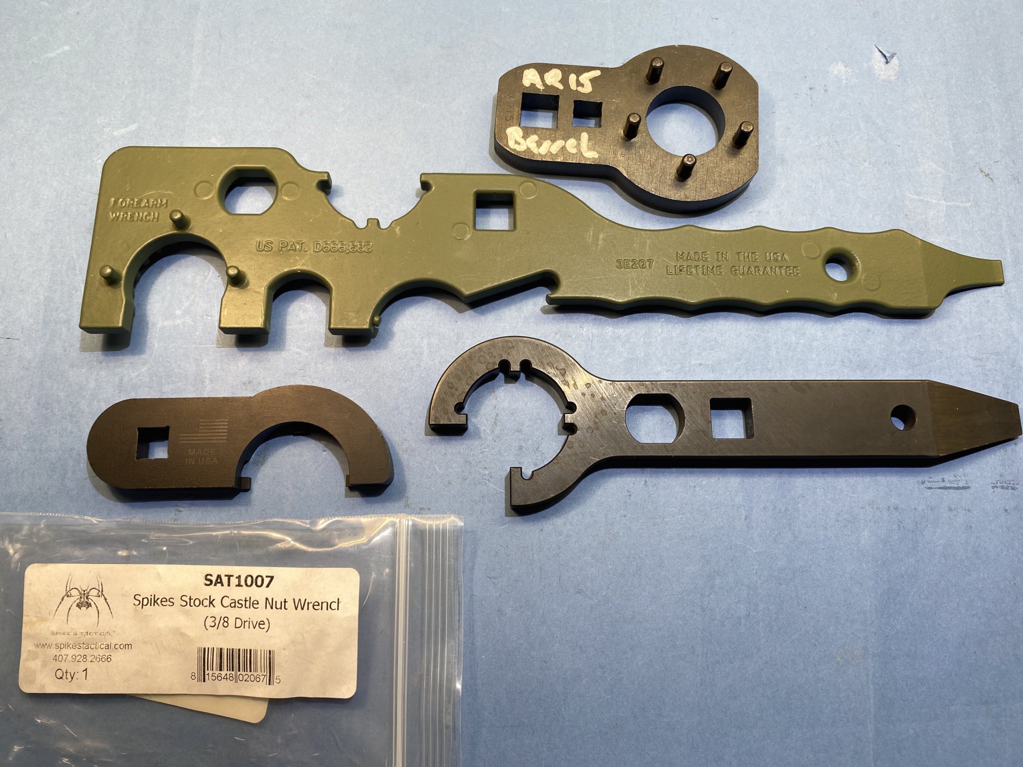

The Spike's tactical castle nut is a handy piece for some situations where the standard wrench just won't be able to get on the nut easily;
nice tool steel for torquing as well.

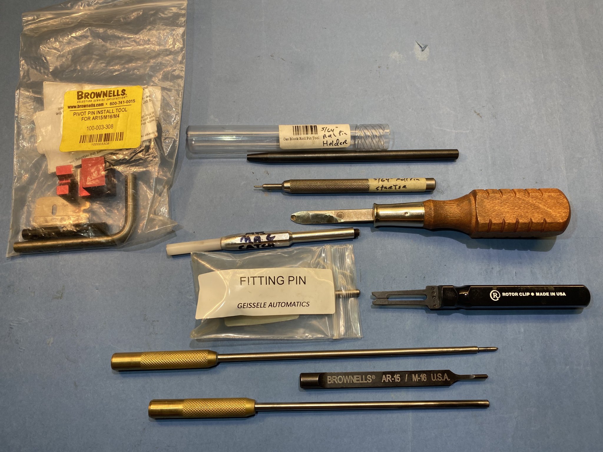

Some proper gas block 5/64" roll pin holder to start the pin and the proper size roll pin punch to seat it.
I fabricated a tool to depress the buffer detent when removing / installing the spring loaded buffer that keeps the spring from
shredding the skin off my knuckles when it slips by.
Some fabricated lonnnng roll pin holders and starters for the bolt catch roll pin; Brownell's has a half ass punch, but it is too short and you
find yourself still trying to tap the end of the punch right next to the magazine well which invites a scratch on a new gun, despite taping it
off properly.
I have found most of the clam shell style and other polymer receiver inserts become paperweights in short order. It's pretty easy to
fabricate a well-fitted upper / lower insert that will fit in your bench top vise better in a supportive manner.

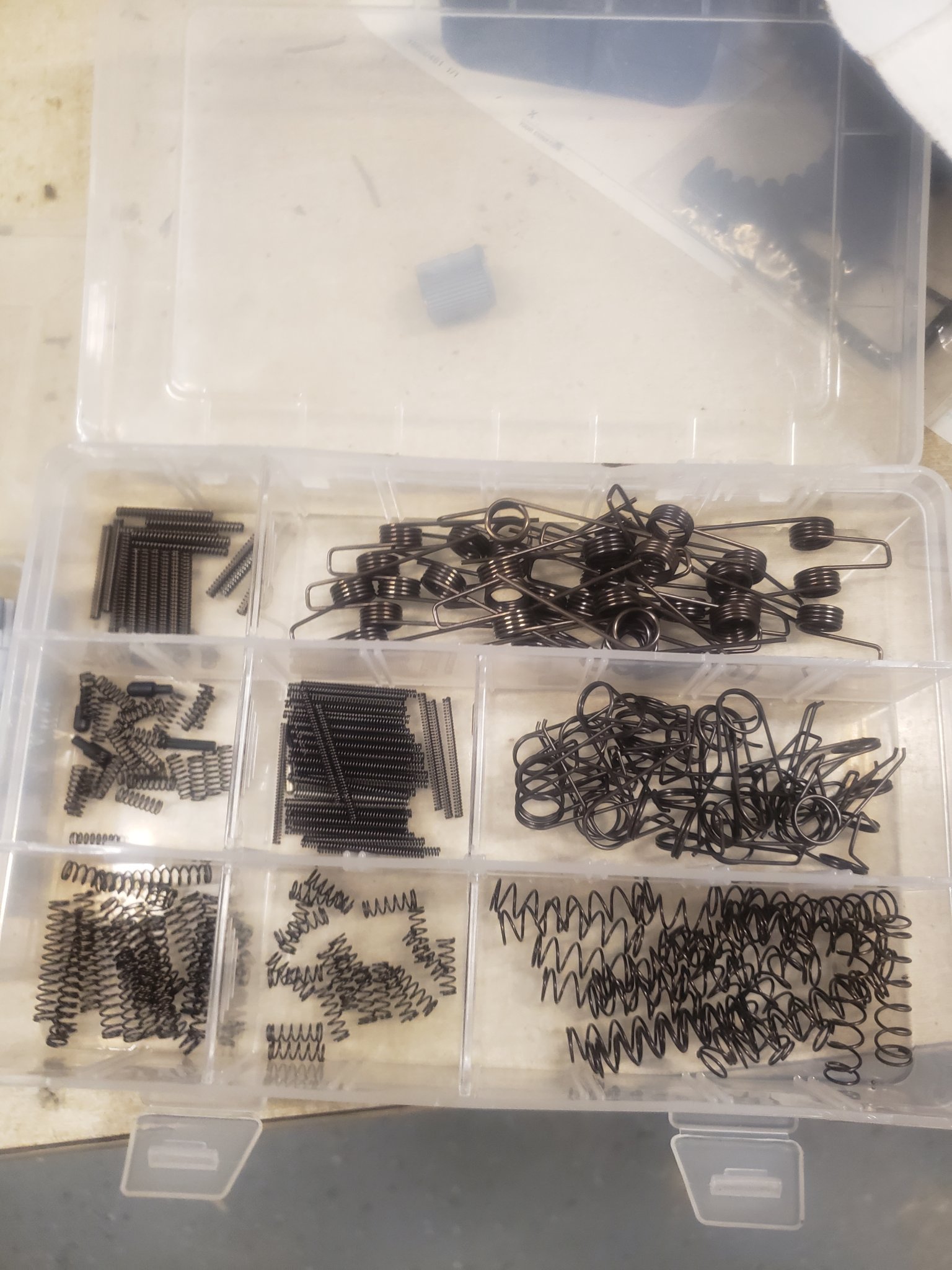

This box contains multiples of every spring in an ar lower. I also threw a few of the various detents in.

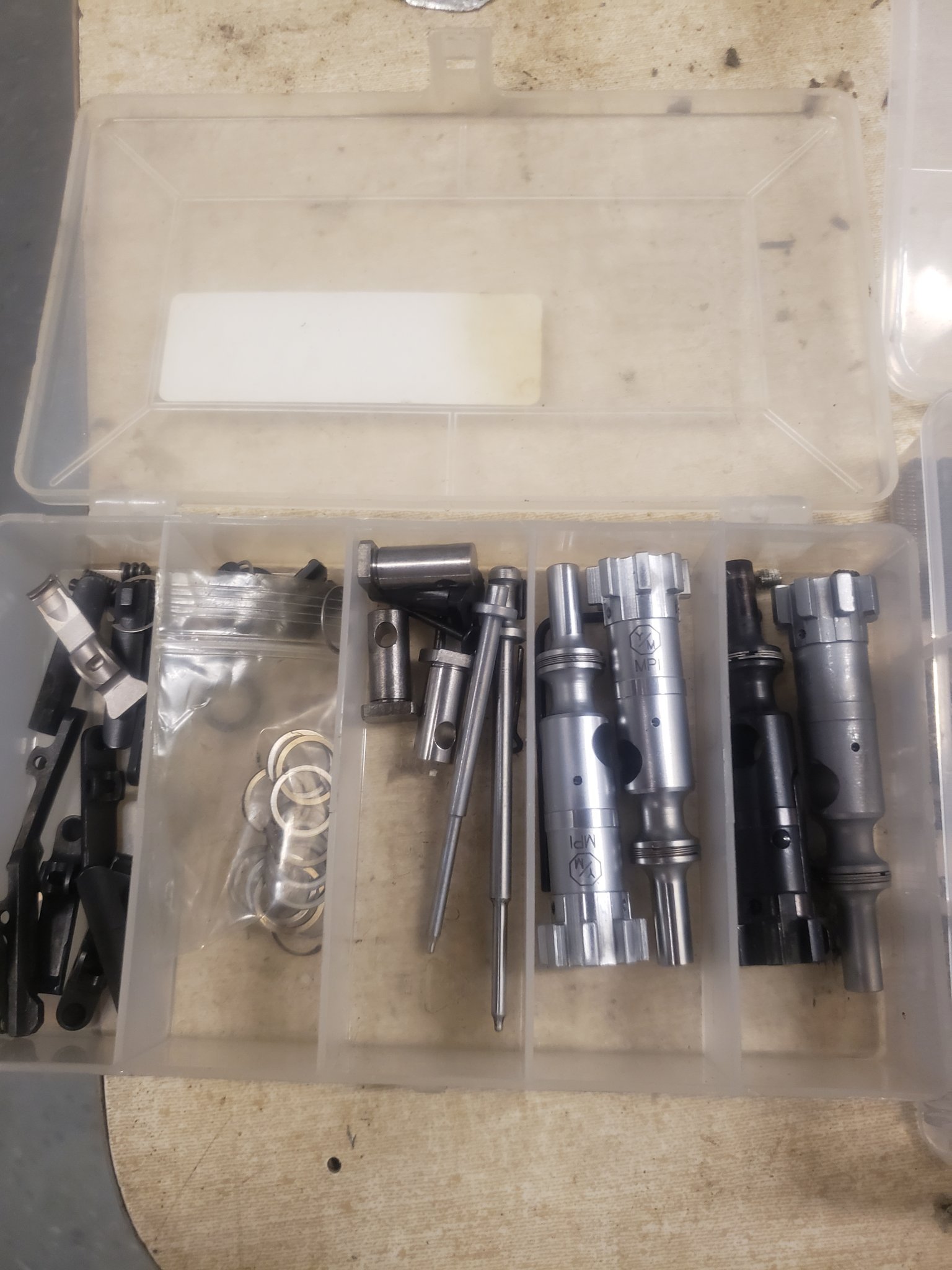

this is probably the most important stuff. Spare bolts, bolt cam pins, extractors, firing pins, firing pin retainers, gas rings, and extractor springs. I Also have a couple carriers stashed away, and a few extra recoil springs. I use tubb flat wire springs. Not only do they work better than regular round springs, but the same spring will work in both carbine and rifle length buffer systems, simplifying logistics.
