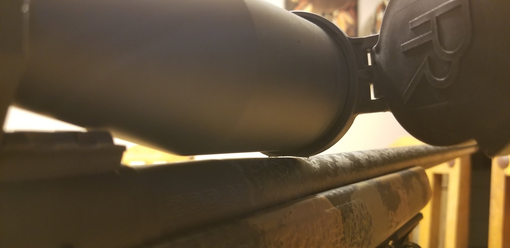

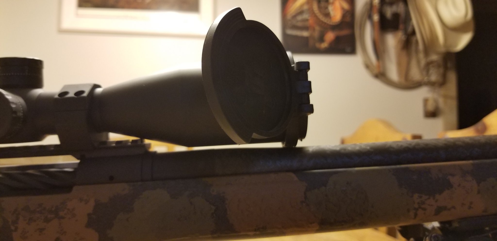

Depends on the height of the Picatinny rails. I had an R700 w. Seekins 20MOA rail, Seekins 30mm .92" "medium high" rings with a March F 3-24x52 over a Proof Sendero and it cleared the caps just fine. Same rifle with Seekins .82" "low" rings and a 3-15x50 Premier BARELY clear the barrel with caps.
