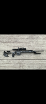

I built a 300PRC on an Origin LA and PVA M24 profiled 26" barrel. It sits in an MDT chassis. The goal was also to make it as heavy as possible.
The PVA barrel is a laser and load development with 230gr ATips and Retumbo was super easy. With Virgin ADG brass I am getting an SD of 6 and just under 2800fps. There was a lot of room to push the 230 ATips faster, but it's shooting half MOA and the velocity is super consistent.
The chassis is great, except you will absolutely want a bridge of some kind to stiffen the forend up. Or find an alternative chassis. Again, I was striving for a 26lbs+ rifle when it was done.
An MRAD or AI are sweet options. At retail,y setup is just over $3K. You can parts hunt on the PX and definitely shave 20-30% off that retail cost.
