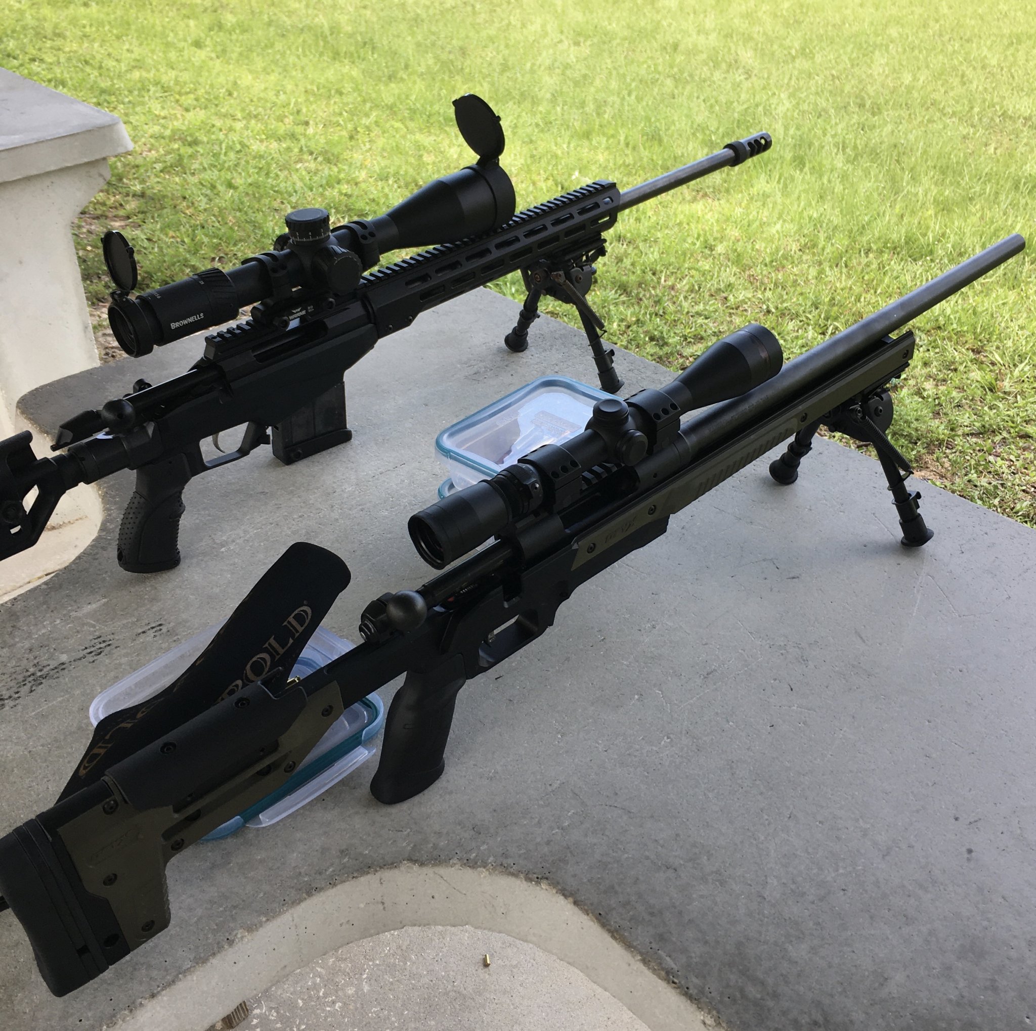

Build your self a nice rig, with your budget a very nice build is possible. I’ve built my last two rigs and I couldn’t be happier with the way they came out, ones a TL3 and the other is an origin
I just built a 300 prc with the ultimtum barreled action in an ACC chassis. Very nice setup. Just need to burn through the junk factory ammo so I can roll some 230gs! Should be able to do that on your budget.

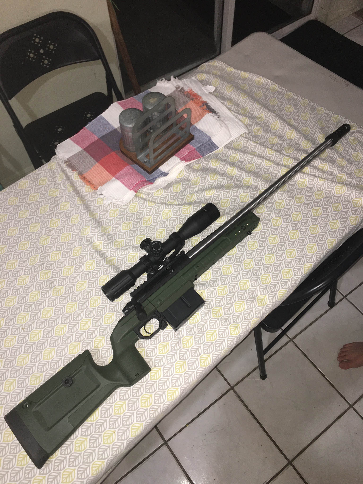

I am firmly in the “build” camp, but that’s just me. Do you like to tinker with things or do you like to push an easy button? Both have their merits so there’s no wrong answer. If you like to tinker, you can build a bonkers rifle for decent money. If you like the easy button, there are lots of really great builders competing for your $$ and most are easy to work with if you have problems

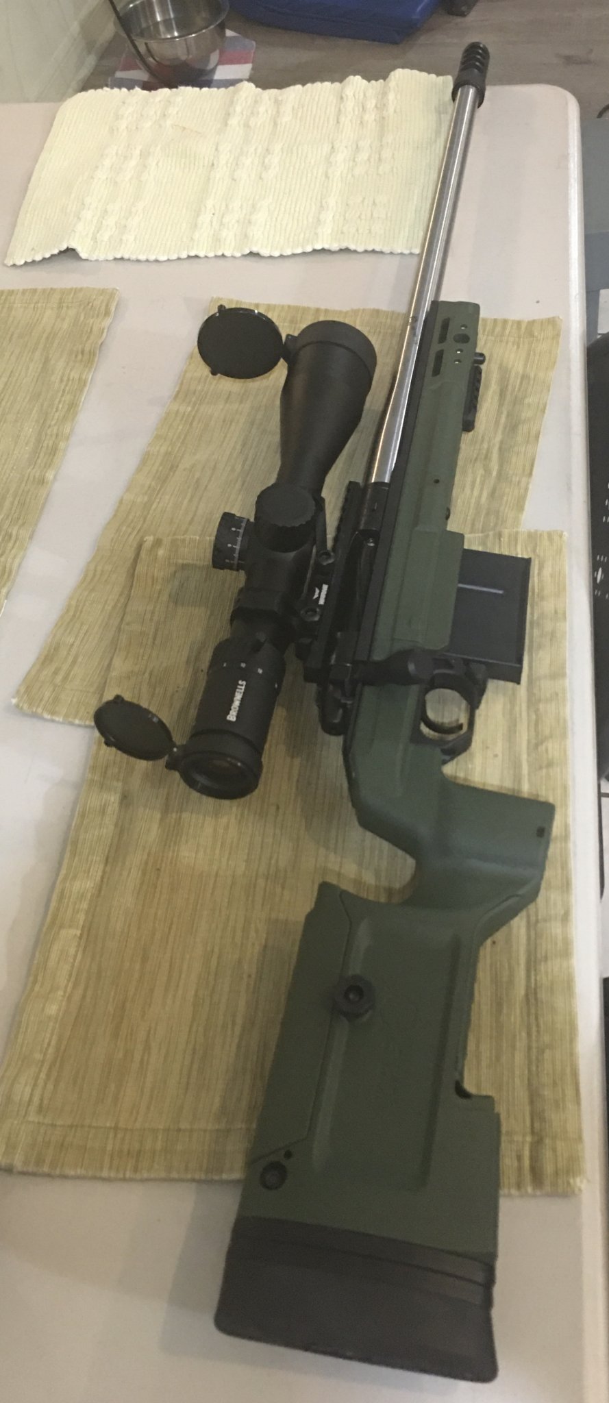

So I ended up building.
Origin LA
Preferred BB 24” Heavy Palma 1:9 ,3/4-28 muzzle threads
TT Diamond set at 14.2oz
Area419 Sidewinder
KRG Bravo
MDT CIP Mags with feed lip mod.
SWFA 10x42 (for now) during barrel break in.
I’ll be getting another Brownell’s MPO 5-25x56
Harris Bipod 6”-9” BRM
I only got it together the night before I had to go to work for 3 weeks, the waiting sucks! Lol
