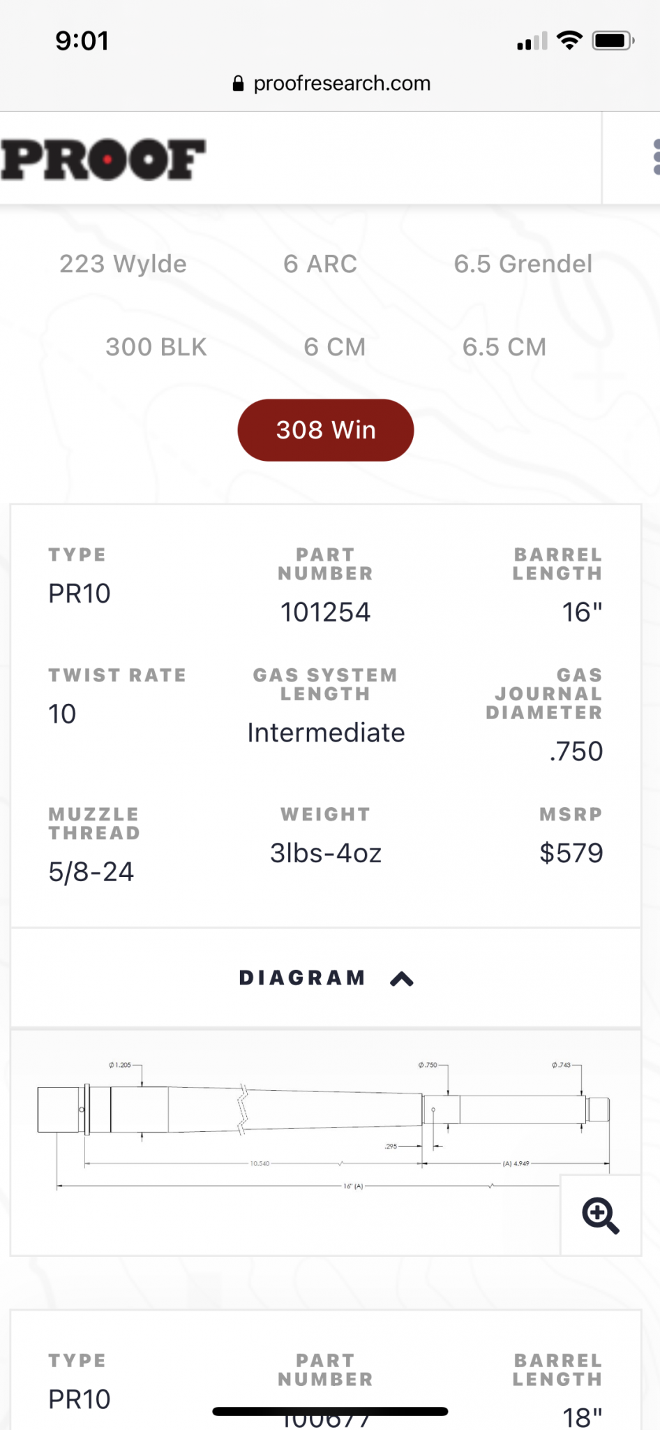

May consider this barrel wise too:
Reactions: ArmchairOperator

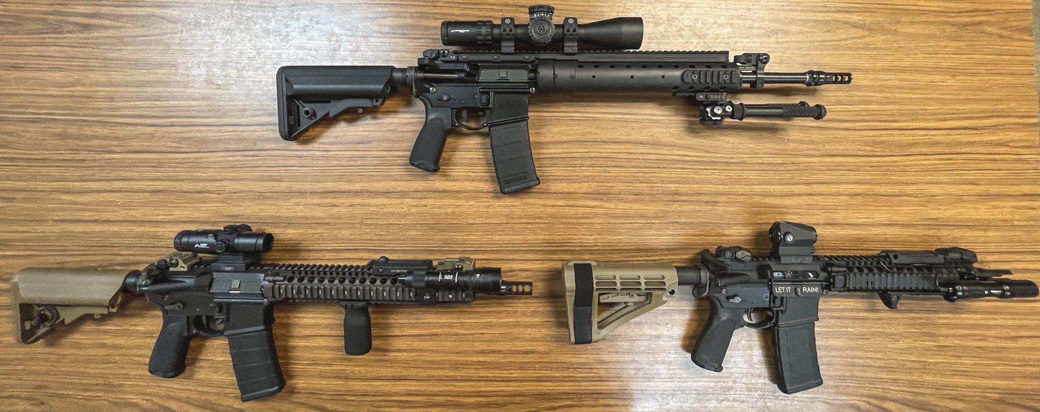

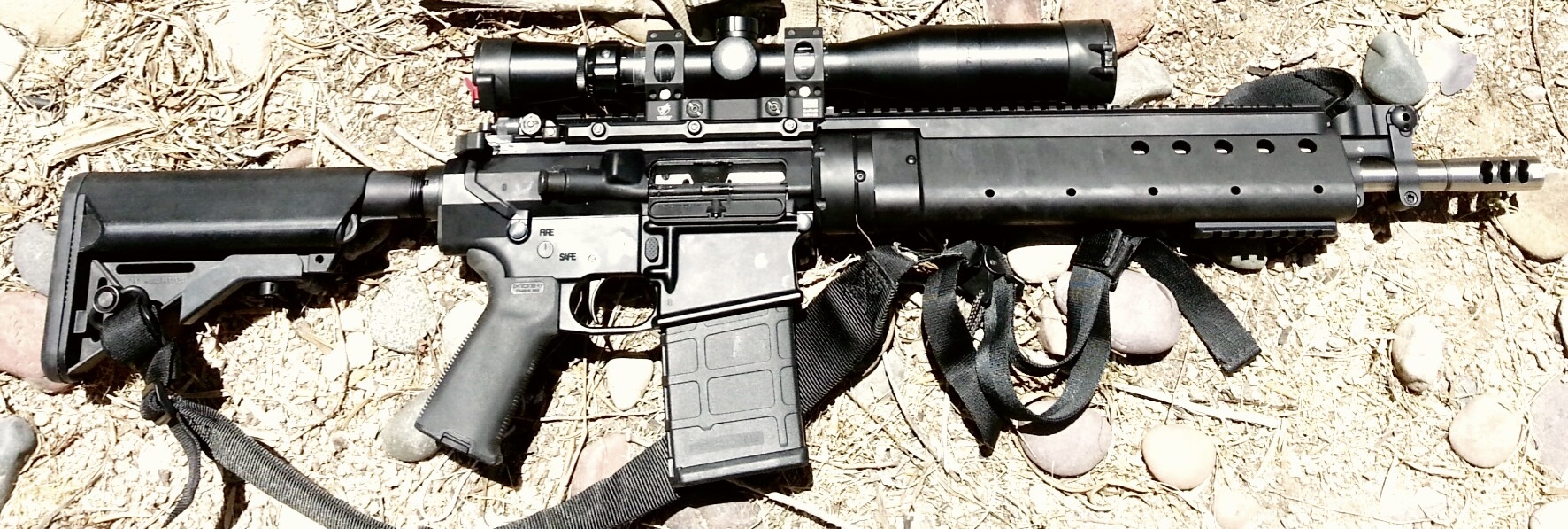

Here is the picture that made me want to build a large frame MK12
And here is the Mod H with modified top rail that could be an option on my build. I run a machine shop so I can do the work myself on this. Anyone know the owner of this one as well? Would like to know what exactly he did for this and if there’s anything I should know about this kind of modification.

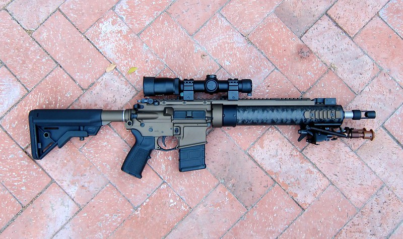

The owner of the bottom one is somewhere on Calguns if you’d believe it. He’s done several extremely legit Mk12 builds. He cloned the OG prototype Mod 0. Machined several parts from scratch. Google images will bring you to the Mk12 thread over there.
It’s funny, when I mentioned a Mod H type deal this is what I had pictured. It would look titties on a large frame and flush suppressor. Gives you more option for gas block which I would go for over the adjustable tube. It may become a pain to change inside (guessing I dunno) the rail vs an SLR adjustable block. Future convenience in adjustability down the road would be something I would have in the top 5. Different ammo etc may warrant gas adjustment.

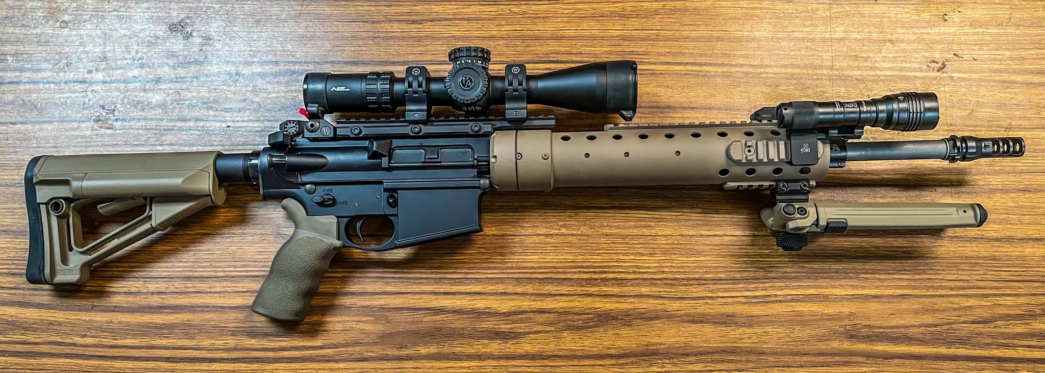

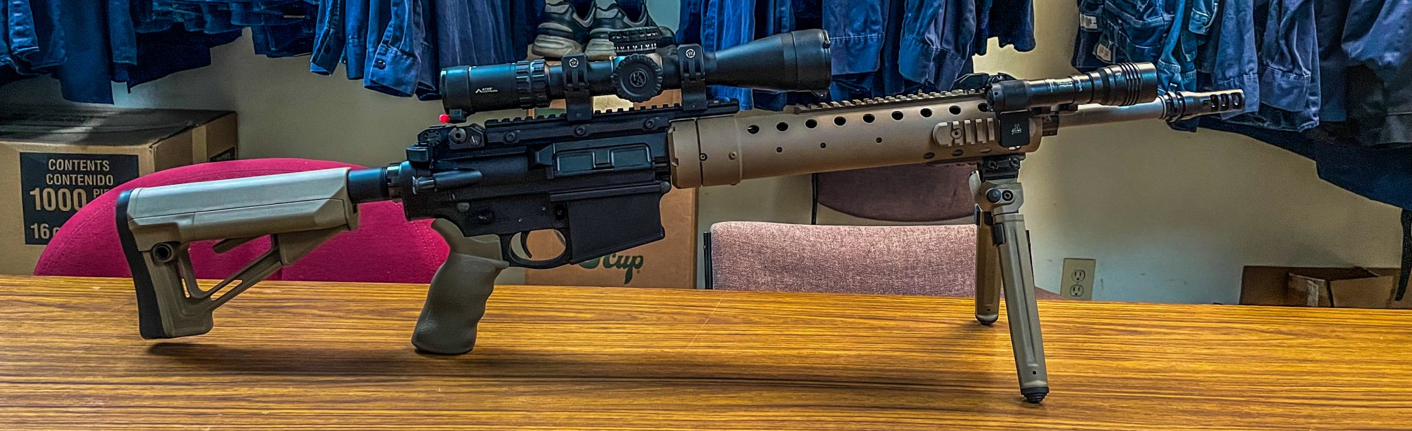

So your Mod H suggestion got me thinking. PRI does not make Mod H Recce top rails for the 308, but they do make an extended rail riser for the ar-10 that is just a rail that clamps on and hangs over the receiver. This combined with the PRI DPMS low handguard, would get close to that Mod H look. So I am thinking, 16" or 18" rifle gas with bleed off AGB, PRI DPMS low rifle length handguard, and PRI riser rail, which is not cut to mate with the PRI flip up sights so I could use a set of troys i already have, and I think the 0.019 lower elevation on the front sight from the rear sight would not be an issue, could almost think of it like is a 20MOA canted rail haha (I wonder the actual MOA of this setup. (If I do it ill calculate it to see what it is) This will address the 2 issues I have with the rifle, the A2 profile barrel with mid gas and the handguard which I do not care for at all.
This is the new plan. Will get me close to what I was after with less work. Ill post pics when I am done.

Ok got it together in a Mod H configuration. Base rifle is a PSA PA-10 Gen III. I used a heavy profile Ballistic Advantage 0.750” barrel I found on sale. Superlative AGB. The PRI riser is 0.5” tall and has a 20 MOA cant. Optic is just a Primary Arms GLX 2.5-10x44 with their Christmas tree reticle. ARC 1.10” 30mm rings. Troy battlesight BUIS. PRI DPMS carbon handguard. Dead Air brake. Ergo grip. Noveske Super Badass charging handle, Magpul STR stock with an MDT recoil pad. Magpul bipod, Streamlight HL-X on a Haley Strategic scout mount. Geissele SSA-E trigger.
At some point I will try to figure out the full top rail, but I’m happy with my large frame Mock 12 Mod H.
Plan to use it for deer hunting, plinking, range days, ranch rifle, etc…
Plan to use it for deer hunting, plinking, range days, ranch rifle, etc…View attachment 7728959View attachment 7728963
Looks pretty sick!
Nice looking rifle. I keep telling myself I want a MK12, but know I won't be happy unless it's 100% clone correct, so I defer to my logical side and just buy more components instead.
None of mine are clone correct, just inspired by… I’ve done a MK18ish pistol, an M4A1 Block 2ish rifle, and a MK12 Mod Oish rifle, and now this Mod H inspired large frame. I’m wanting to also do my take on an Air Force GAU-5A ASDW, and another MK18 upper identical to the one I built but chambered in 458 SOCOM with a 1-6 LPVO to use for hunting.
