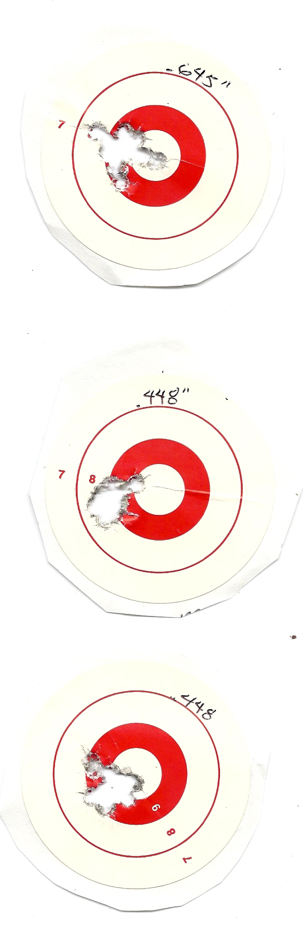

I built a 10/22 from a used Kidd barrel, Kidd trigger group, Tac-Sol receiver and a Boyd's thumb hole stock. No Ruger parts that I'm aware of, unless Kidd uses the Ruger trigger housing. When done, I had just over $800 into it. I use Wolf Match Extra and like said above in the 4-7's, but not consistently.
50yard 5 shot using federal auto match bulk pack (likes it better than any of the match stuff i've tried.

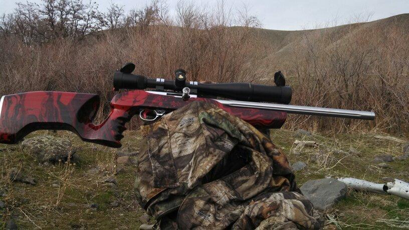

Kidd 20" polished fluted barrel, Kidd drop in trigger kit w/out the trigger, Kidd bolt buffer and Kidd ejector added... Just some of the Kidd parts used in this build..
