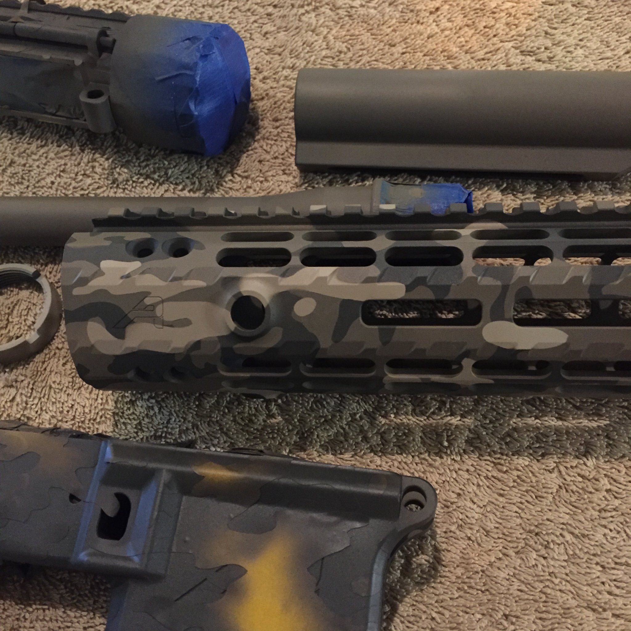

I like the custom aspect of it for sure. Never really consider resale. Here’s sneak peak of the finish I’m putting on my future build. From what I gather so far, resale is the only real benefit to buying.

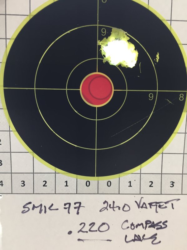

Bought a new FN15, lucky to hold 2 - 2.5 MOA. Sent it back to FN, they retuned it saying the rifle “was in spec”
Shipped the rifle to Frank at Compass Lake and asked him to free float a Krieger barrel on it. This is how it shoots now. 5 shots, one big hole.
Liked the results so much, I had him barrel another from “parts” I had. Shoots the same.
Reactions: Buckshotu2

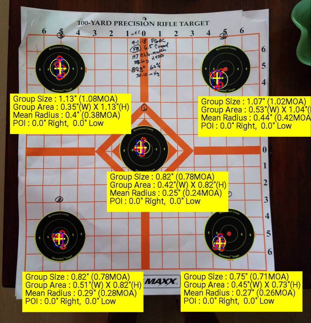

I've been somewhat distraught about the build vs. buy issue. I'm not new to shooting, but I am new to PRS, building, and taking my marksmanship to the next level.
After getting caught up in a lot of the noise on the internet of people claiming their home built rifles were shooting 1 hole groups and so on, I thought I might as well try it. I built a .223 Wylde rifle on an Aero Precision receiver set with a Ballistic Advantage 18" fluted SPR barrel. I topped it with a 1-8x Primary Arms Platinum series optic and it's unbelievably accurate with 69gr SMK and 77gr SMK hand loads.
Later on last year, I thought to myself that my since my first build went so well I'd try a large frame AR in 308 Win so I could "save" the barrel life on my match rifle (that's how I justified it). I ended up building an M5E1 Aero Precision build in 308 Win that was beyond a pain in the ass to get to shoot. My first barrel was from Ballistic Advantage... I ended up sending it back multiple times due to it not passing a No-Go gauge and having a loose chamber. They sent me a replacement barrel, which I ended up returning because it wouldn't shoot better than 2 or 3 MOA at 100 yards. After having dumped a ton of time and money I decided to try a different direction and I went with a 24-Inch Criterion Barrel from Fulton Armory. I mounted this in a non-enhanced upper, lapped the receiver, and began working up a match load. At this point, my build with the new barrel is shooting much better. It's barely sub-moa - but at this point I've realized that about 0.8-0.9 MOA is about all I can expect given my abilities and the platform.
In hindsight, I could've probably just bought a JP LRP-07 given all the time and money I've spend to get this to shoot. On a positive note, I've become very intimate with my rifles and their parts and I think shooting my M5E1 build has made me a better shooter as gas guns exploit all your mistakes.
