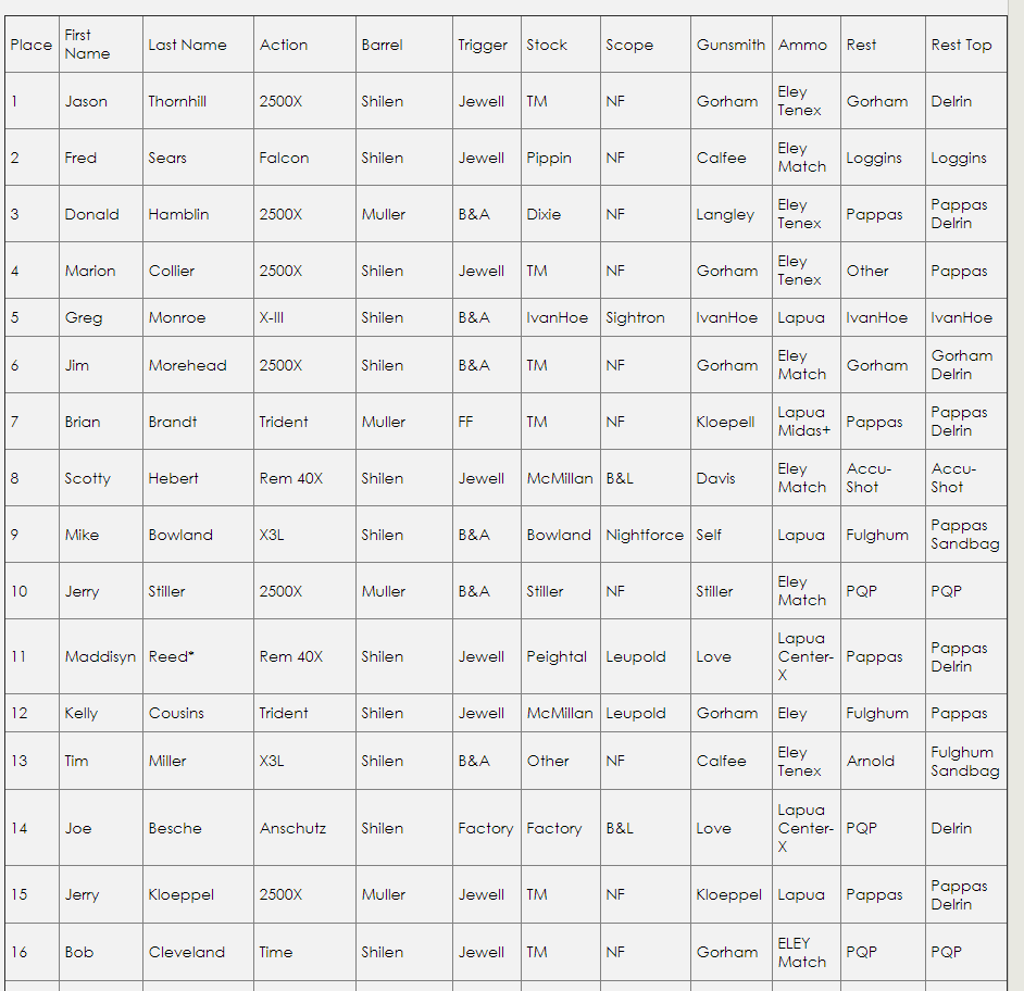

If you want to be competitive in 22 benchrest you will need to spend the money needed to build a dedicated rifle. If you check out the equipment used by top competitors this will give you an idea as to what they use to win. This is not a matter of what someone thinks will work best, but it is simply what people who win choose. If they could get by a little cheaper or choose another set up that would help them win....they would. Here is an equipment list from the Pro Shooting League. I would talk to Killough Shooting Sports to further this discussion. Single shot is better suited for benchrest than magazine fed actions. Hope this helps.
