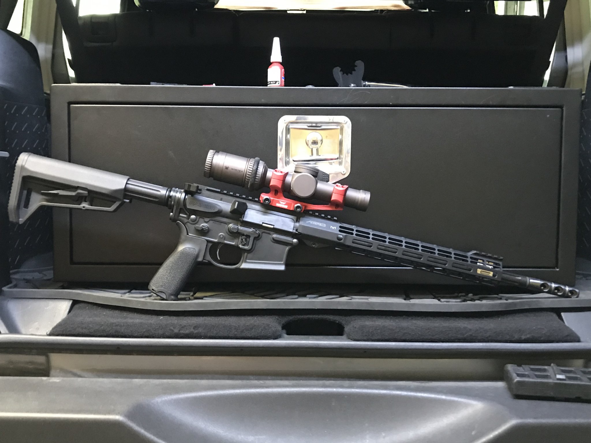

Final iteration for the week. Swapped out upper and handguard. I like it.
