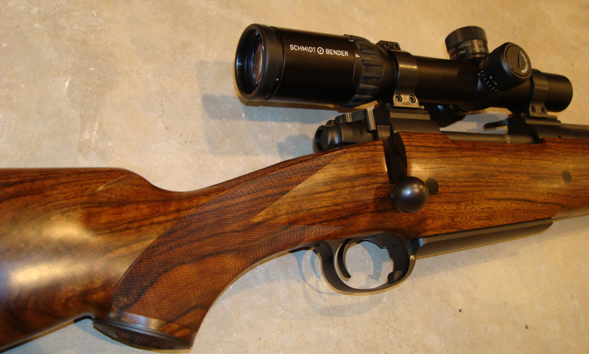

Another completely different route than going with a custom action would be to go with a Zastava commercial 98 chambered in 375 H&H from the factory, rifle cost under $1,000 off of gunbroker. The Mauser 98 has one of the best track records in Africa on dangerous animals, they just work. To squeeze as much accuracy out of the Zastava you could rebarrel it with a custom barrel, that would probably provide you with adequate accuracy. For hunting appications, unless the ranges exceed 500 yards, the accuracy difference between a full custom rifle built off a modern action and a 98 built by a gunsmith who does a lot of 98's (my recommendation would be Jim Kobe of Bloomington MN) would be moot. Half MOA is not needed when shooting off of sticks as the sticks may be the limiting factor.
Understand, I am a little biased towards 98's for hunting, I do almost all of my hunting with 98's that I have built off either Zastavas or FN commercial actions, about the only modification I do to the action is install a 3 position swing safety (think Win Mod 70 safety) I prefer to have the safety lock the firing pin instead of the firing pin. I usually use cut rifled barrels, although I am building a 9.3 x 62 on an FN action and went with a McGowan barrel (button rifled) as it would have taken longer than I wanted to wait to get a cut-rifled in 9.3 mm. The Zastavas have been imported and sold under Interarms MarkX, Remington 798, Charles Daly 98's, and now under their own name all of them are fine for hunting.

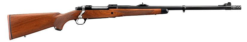

Its basically an american mauser and in 375 ruger like wade touched on instead of h&h
The only thing it wont have is a proper integral "rail" as rugers have direct mount rings.
I did a quick search for anything thats offered in h&h and for new offerings its looking like winchesters, weatherby, cz and browning. The winchester is the one I would trust most out of those but thats because its closest to the ruger lol

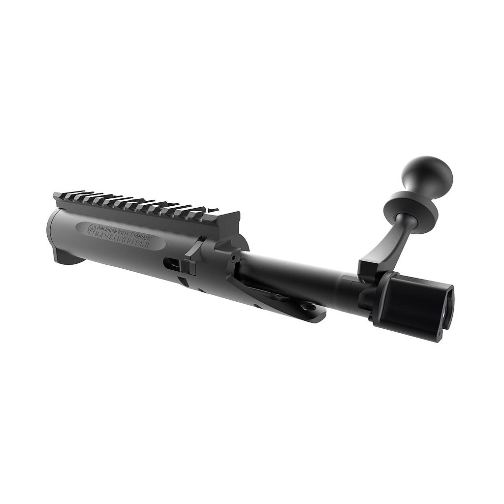

I think the Mausingfield will work! I don't need the rail because they make rings that go right into the rail mounting groves. I'll call them to see if anyone has ever built a H&H out of one.
