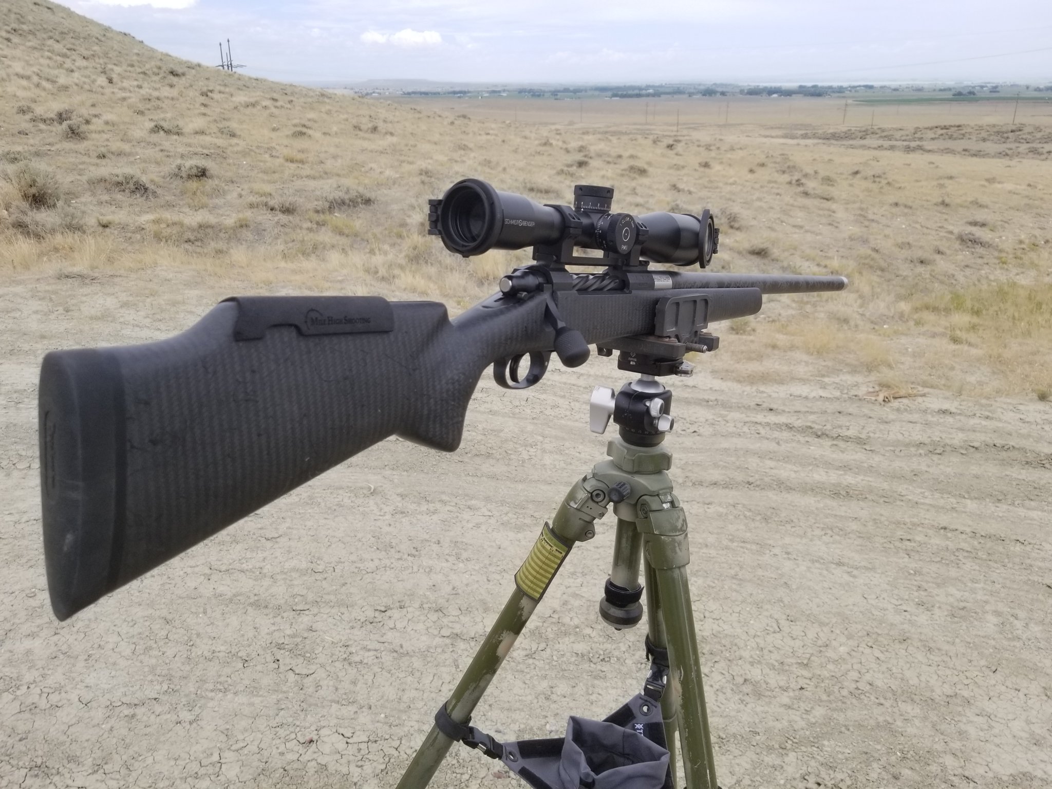

If you go with a Defiance AntiX action, Proof research 26" barrel and KRG Whiskey 3 folder you'll be at about 11lbs without optic.

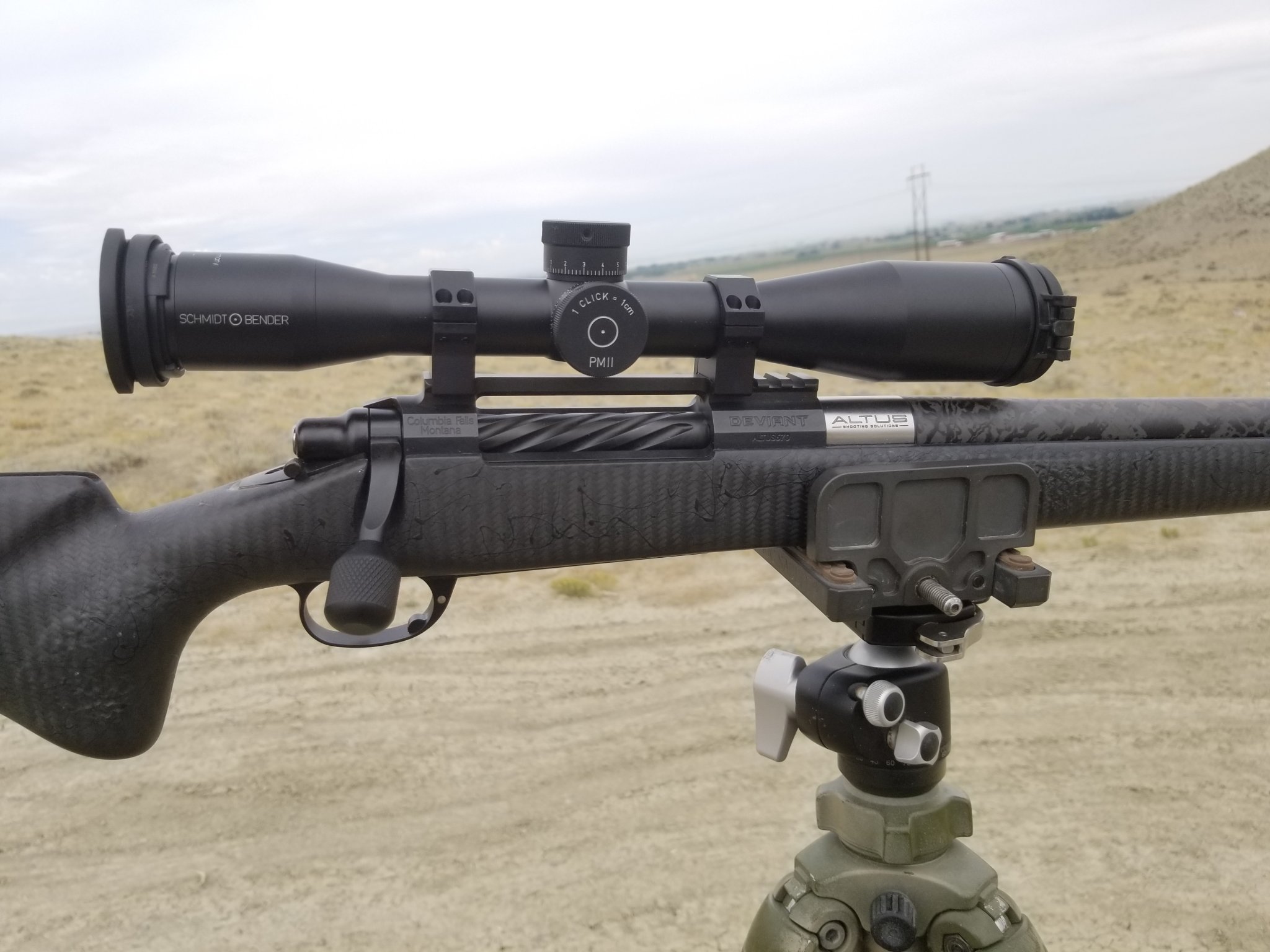

I did a Defiance Deviant, 26" Proof, Manners carbon MCS-T and im at 7.5lbs bare. 9lbs even with optic and 4rds of ammo.

I had a Titanium 5 port muscle brake on it and recoil was minimal, could spot my hits. Just too fucking loud for hunting, never had time to put earpro on. Suppressor makes it too long with 26" barrel and extra weight to pack since I average 10+ mile hikes while hunting.
So now I shoot it without a brake. I shoot a 199gr bullet at 3300fps, so it's pretty snappy recoil wise, It really gets your attention!

Not always, depends on the shooting position. Off the tripod with Hogsaddle the rifle moves too much. I plan on putting an arca plate direct mount on it hoping that will help. If I build a good sitting position off my pack then I can normally recover from recoil enough to spot my hits, it a 10x optic so that helps too! if your shooting on 16-20x probably not.
