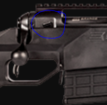

The LSS-XL comes in LH but how do you determine whether a rifle is top or bottom bolt release? The specs online for a given rifle don't, Savage Axis or Savage 10, doesn't specify but the manufacturers are distinguishing between top and bottom.
[/QUOTE]
I am by no means a Savage expert, but I know enough to be dangerous. generally the 10/110 series is the main Savage action everyone builds on, but the LSS chassis is compatible with the Axis as well. I have pictures below to hopefully help with top vs bottom bolt release on the Savage. Bottom is the standard, top is the better version and easier to use. Bottom is shown first.

The higher end use the top bolt release, bottom is standard. There is not great way other than savage's website pictures.

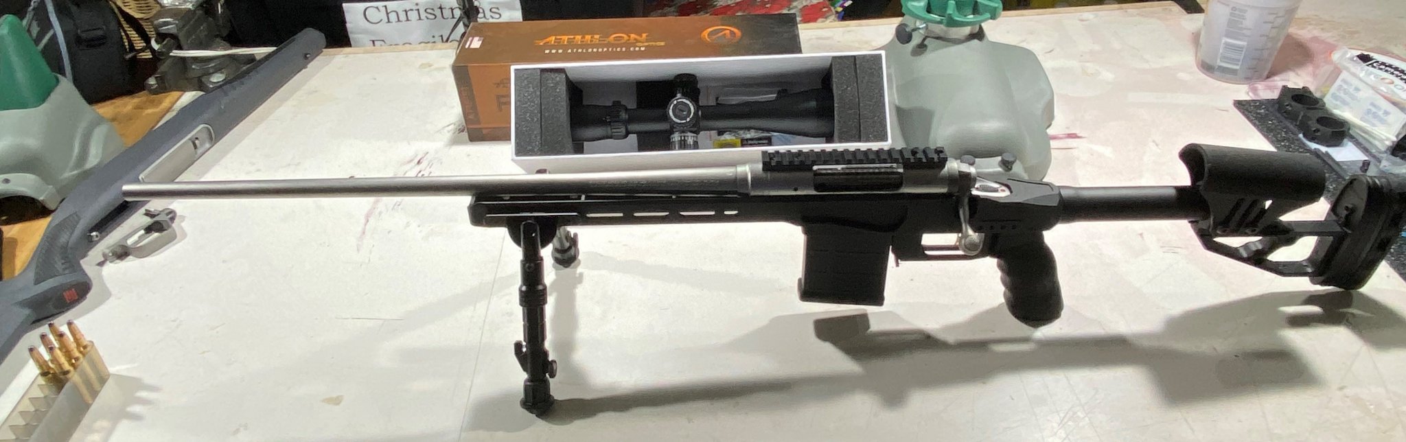

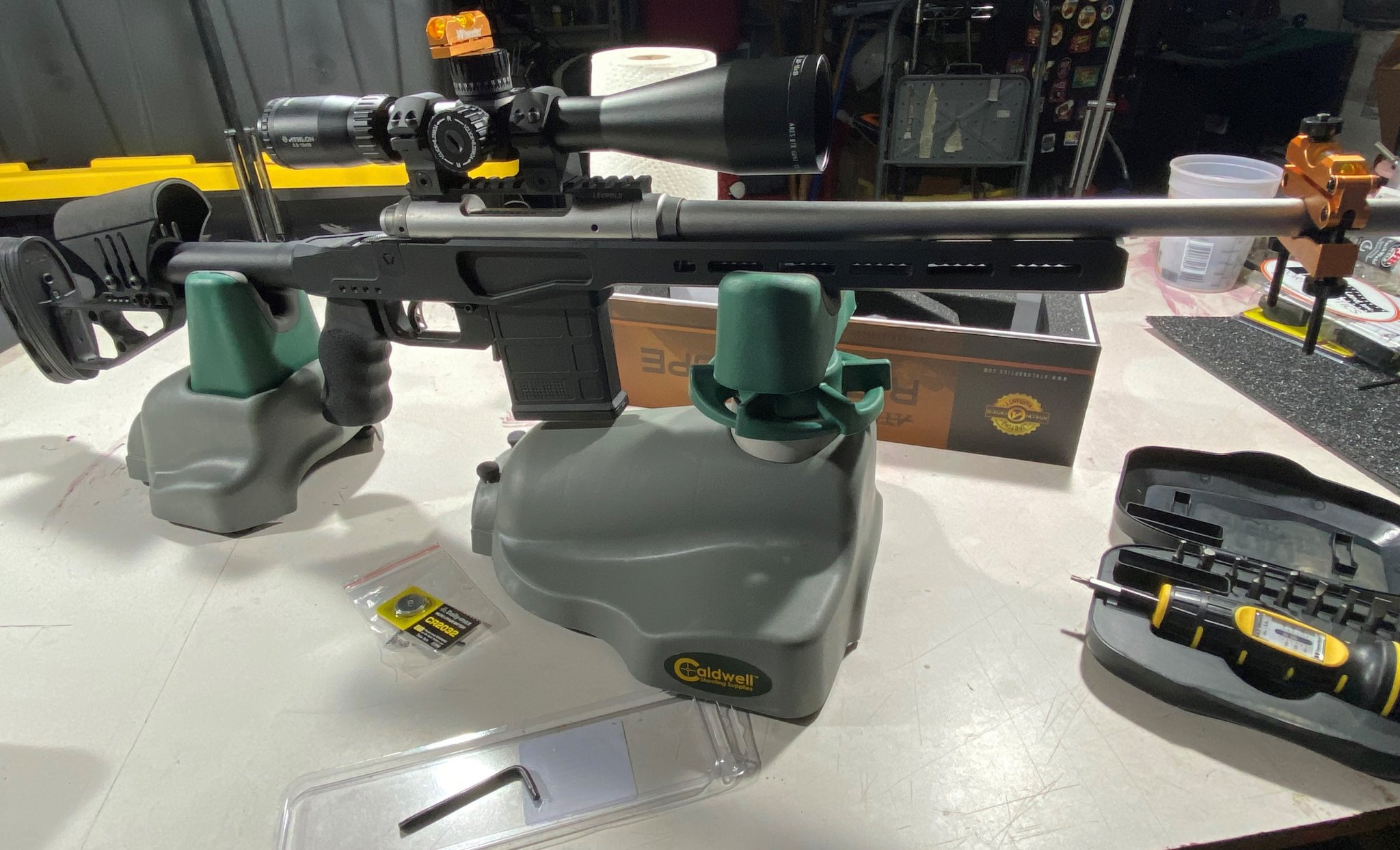

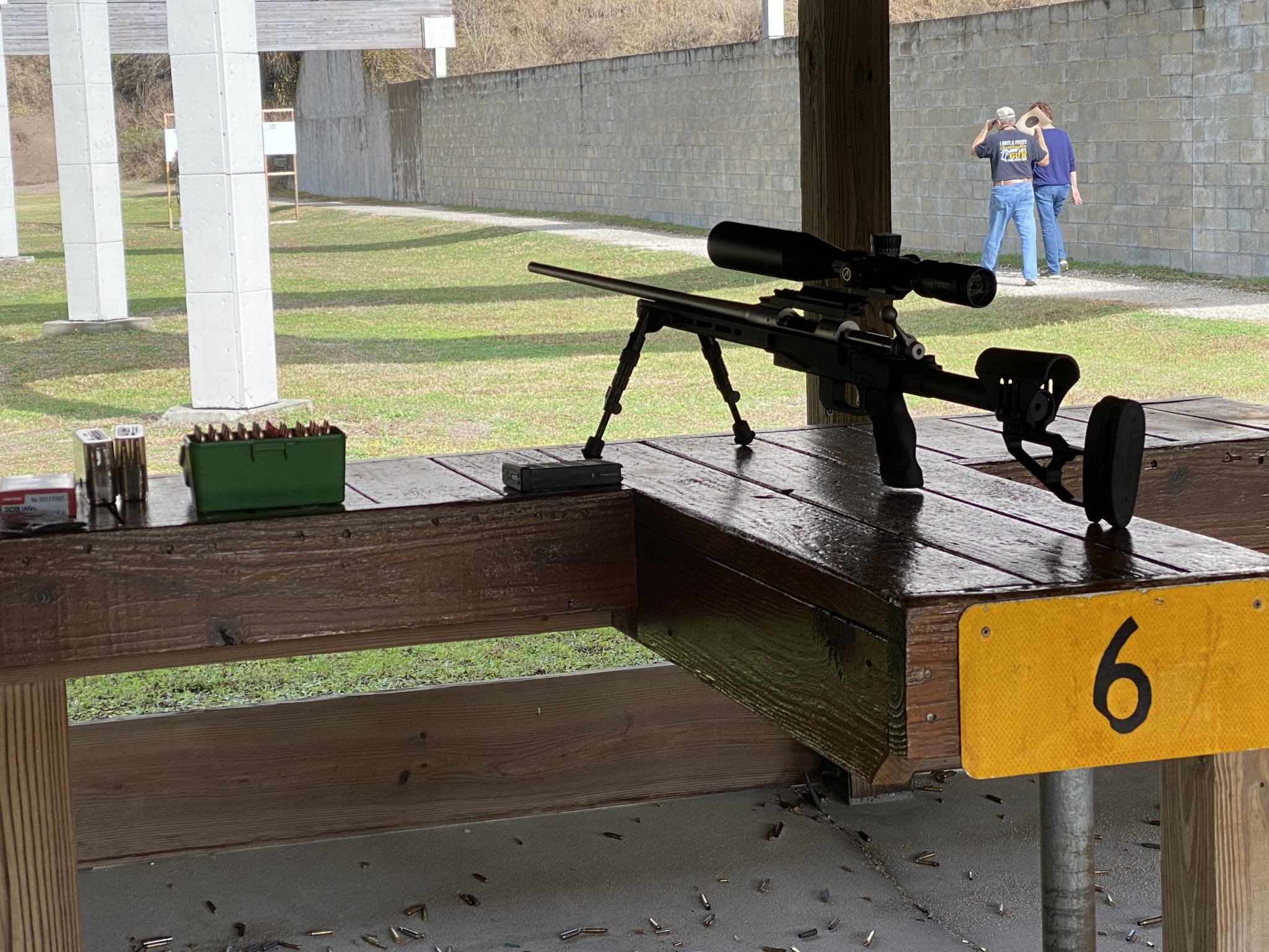

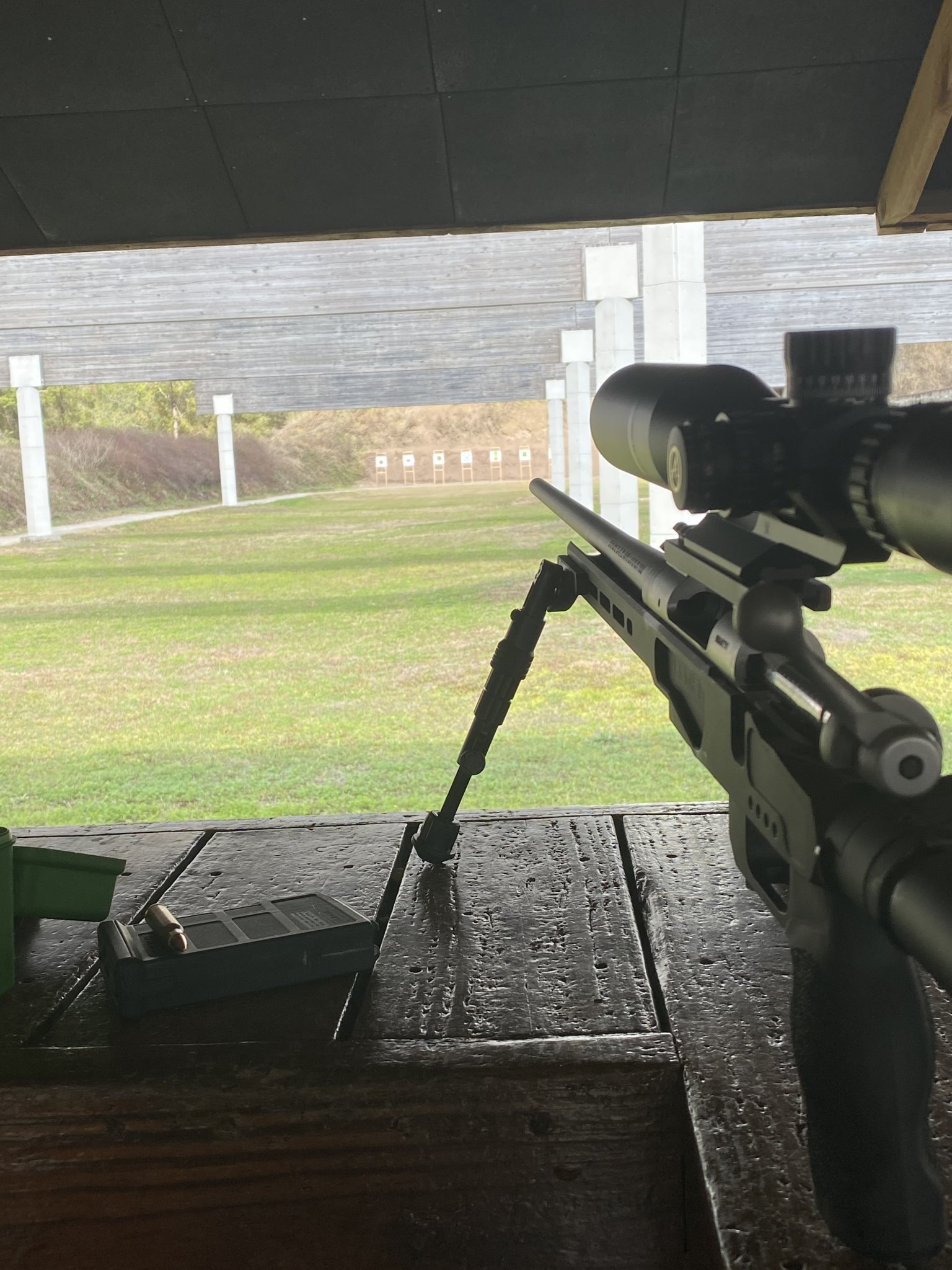

Alrighty, new update. The guys at @XLR Industries / @XLR led me to the promised land! Optics Planet got the XLR Element 3.0 Savage chassis in and I placed the order today!
Ordering an Athlon Ares Gen 2 scope from @gr8fuldoug at Cameraland this week. (Though I still need to decide on what rings to use)
Things are finally getting close and I’m looking forward to sighting it in and firing that first round!
So, I got the scope on yesterday, and started to get placement figured out. I expected that there would be some challenges, and I was not disappointed. LOL
I can’t get my head/neck low enough to use my scope. I’m currently using medium XLR rings, on a 20 moa rail. Now, when I say it’s too short, it’s too short by a good half an inch or more. I also can’t get close enough for the eye relief, and my scope is mounted as far back as it will go.
In trying to figure out a solution, I came across Vortex 2 inch offset one-piece rings that are significantly higher. I know these are generally AR platform equipment. My thought was to mount it backwards to get it closer to my eye, and the height might get me where I need to be.
Could mounting it backwards be a viable option?
Will having the scope mounted that much higher over the barrel create issues going from a 100 yard zero, out to longer distances?
Any other ideas to get the scope up higher that won’t screw things up downrange?

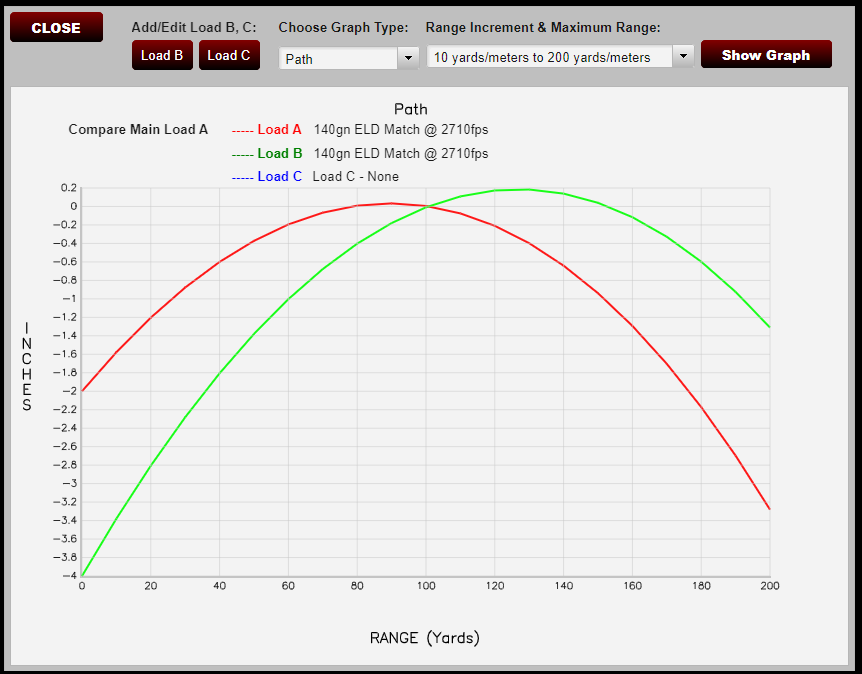

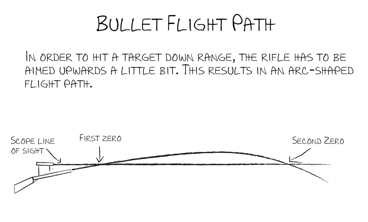

Mounting the scope on that mount backwards is a good option to get the scope far enough back and high enough for your needs. The only issue I can possibly see from mounting your scope that high is you could end up with a double zero with a 100 yard sight in. Your ballistics program will compensate for it and you should have no problems shooting longer ranges with it, but you might end up shooting high at 125 or 150 yards with a 100 yard zero. Have the same thing with my 204 ruger ar, not a big deal
I apologize for my ignorance, but I'm not familiar with this.
When you dial up for longer range shooting you are doing this anyhow, but it is not an issue with most centerfire rifles with a 100 yard zero. I have an image below that might help, but I also have the ballistics chart for 6.5 creedmoor 140 grain load from hornady with a 2 inch scope over bore vs 4 inch witha 100 yard zero for each.
Ok, so three trips out and this is where I’m shooting after today. Got the Athlon scope dialed in for 180gr and 150gr .308.
Today I was shooting the 150gr. Now, it’s just practice practice practice.
