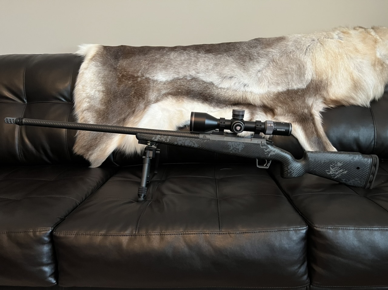

I went 6.5 prc on a lone peak Ti short action with a 24" 8 twist proof carbon. It sits in an AG composites stock. It is light enough to carry on a backpack elk hunt and has enough weight to still spot shots and enjoy shooting it. I haven't even tried to reload for it because factory hornady 143 eldx shoots great and im just running through a case i got lucky enough to pick up. Last season along that rifle punched tags on 2 Co public land bull elk out to 675, 4 Wy antelope out to 780, 3 pigs, and a few deer. Most were drt and none ran out of sight.

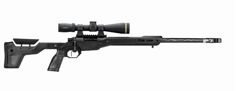

Might want to look at MDT’s light weight hunting chassis.
SPECIFICATIONS​
  • Chassis body machined from AZ61A magnesium alloy
  • Fixed and folding version available
  • Ultralight weight design weighing between 26oz and 31oz depending on configuration chosen (folding version and ARCA version increase weight to the high end of this scale)
  • Foam filled carbon fiber buttstock deadens sound, vibrations and felt recoil
  • Carbon Fiber components provide warm to touch feel
  • Designed to diminish snag points and provide superior ergonomics
  • Low profile mag latch integrates seamlessly into trigger guard
  • V-Block bedding system with free floating barrel
  • Will accommodate barrels up to 1.25” diameter
  • Compatible with AICS style magazines
  • Front and rear QD
  • Front and rear sling swivel mounts
  • Vertically adjustable cheek riser with soft touch foam pad
  • 12.5” minimum length of pull with adjustable spacer system
  • Accepts most AR Grips but specifically designed with ultra lightweight Carbon fiber grip just over 1oz
  • Carbon fiber enclosed forend with MLOK, QD mount, Sling Swivel Mount
  • Cerekote finish in either Black Carbon Fiber or Cobalt Green
  • Titanium action / grip screws

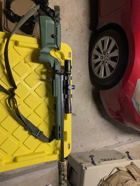

I'm kinda opposite of you. I use a 16" 6.5 Creedmoor for Texas deer. But same as you I'm not a fan of normal hunting rifle ergonomics.
I solved my problem by putting a Tikka T3X CTR in a KRG Bravo. Chopped the barrel to 16" and added a TBAC Ultra 7 G2. Love that rifle.
Reactions: 2c1fr

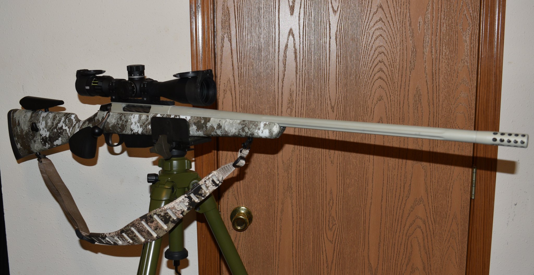

I've got a couple in Manners EH1s and they're my go to hunting guns, I also have a Havak in a KRG Bravo that's a killing machine.
